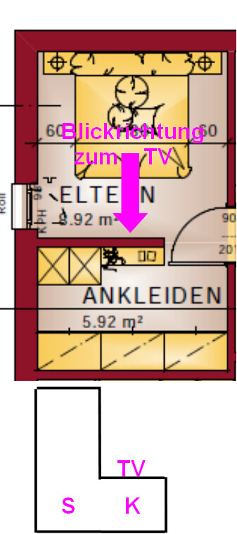

Stepped partition wall)
Well, it’s quite simple:
2D floor plan of a bedroom with dressing area and TV
Behind the wardrobe (W) the partition wall is full height; behind the dresser (D) it is only as high as the dresser, just enough for it to be hidden behind. The TV sits on the dresser (that’s how you wanted it, right?), so you can see the television screen from the bed over the “parapet.” This way, you don’t have a full-height wall right in front of you when you enter, and you don’t need any swiveling arm mounts. Top image: floor plan, bottom image: view from the dressing area looking toward the bed, shown at a 1:1 width scale below.

@jaeger You’re pointing out exactly the issues I ran into during planning. Making the kitchen smaller is possible (maybe switching to a U-shape). But that also reduces the size of the room upstairs. So the bedroom will become EVEN narrower, as will any other room planned there.
I’ve definitely made a note to consider larger bedroom windows 🙂 thanks
@11ant thanks for the explanation, for people who are a bit slow to catch on 😀
It’s actually not too bad. I’ll have to show that to the guy at the house 🙂 great tip!

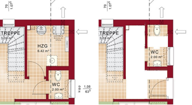

Then modify the ground floor in the upper right quadrant of the plan as follows:
Two floor plans of a house with staircase and WC
The left image shows the original floor plan. Transfer the "heating" room exactly as it is to the basement. On the ground floor, relocate the front door and the WC. The WC can be larger, for example, with a urinal where the sink is currently shown; the sink then moves under the window.
The supply and drainage shafts are simply extended by one story height and remain in an untouched position on the floor plan!
Your little storage room for the vacuum cleaner (the kids will loooove hiding there ;-) fits perfectly. Also, a small shoe cupboard by the front door, a half-height one with a little tray on top for the keys.
