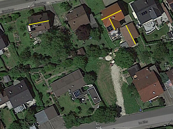

Escroda schrieb:
And that the house cannot be rotated parallel to the street because of the fixed ridge orientation is hard for me to believe.Your view cannot be entirely dismissed – there are indeed very few examples of differing ridge orientations visible there, albeit located directly nearby:
