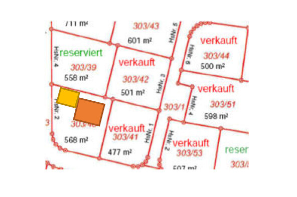

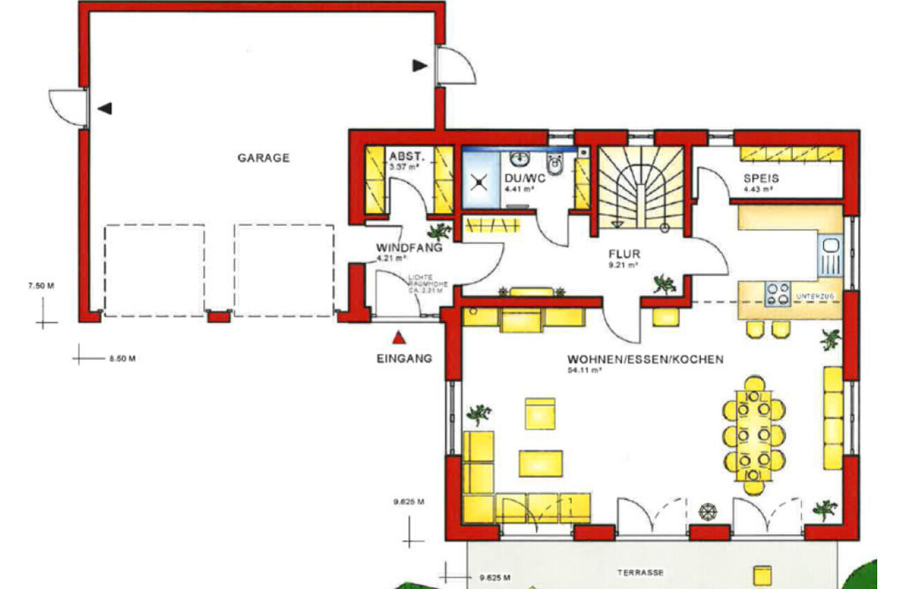

we are planning to build a single-family house with a basement and a double garage this year.
The garage will be half a meter longer. Therefore, the cloakroom will also be 0.5m (1.6 feet) longer than shown here.
What do you think of the design?
Thank you very much for your suggestions.
Development plan/restrictions
Plot size 568
Slope none
Site occupancy index 0.4
Floor area ratio
Edge development no
Number of parking spaces 2
Number of stories 2
Roof type hip roof + garage hip roof
Style modern
Orientation south
Homeowner requirements
Basement, floors basement + 2 full stories
Number of people, ages 4 people (2 children aged 6 and 10)
Space requirements on ground floor, upper floor
Office: family use or home office? Office in basement
Overnight guests per year
Open or closed architecture open
Conservative or modern construction modern
Open kitchen, kitchen island yes
Number of dining seats 6
Fireplace yes
Music/stereo wall TV mounted on the wall
Balcony, roof terrace no
Garage, carport double garage
Utility garden, greenhouse no
Who designed the plan:
-planner from a construction company
What do you like most? Why? large living area
Price estimate according to architect/planner: 400,000€
Personal price limit for the house, including fittings: 450,000€
Preferred heating system: condensing boiler

Wugler197823 Aug 2019 09:50opalau schrieb:
I wouldn’t separate that as a separate room. It’s annoying to squeeze into a 2x2-meter (6.5x6.5 feet) space that also has cabinets in it. I would remove the entire wall, maybe move the door to the garage a bit further down, and then place a nice large wardrobe on the wall next to the garage. We currently have it as you described, and we don’t like it. The entrance always looks messy. For this reason, we want a completely separate room to house the wardrobe. We won’t install cabinets but will use the shelving system from Regalraum here as well.
Wugler1978 schrieb:
The entrance always looks messy. For this reason, we want a fully separated room,A mess behind a door is still a mess. While the Zalando delivery person might admire your stylish, clean entrance, for everyone with access, the chaos behind the door remains the same. Instead of just adding a door, I would consider implementing a tidiness-focused allowance system. Shelves alone do not create any order; the users have to take responsibility for it.
