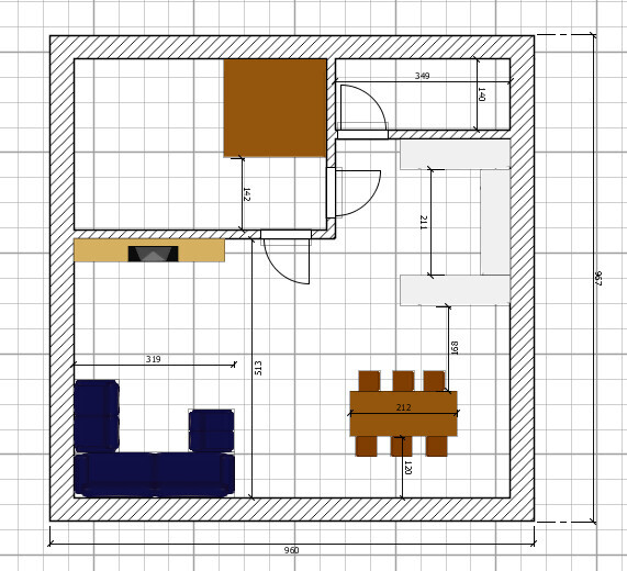

WilhelmRo15 Mar 2019 10:40ypg schrieb:
With SH3D you have no measurement control! More nonsense from the ballpoint-pen analogy crowd...:
With SH3D you have everything—you just have to be honest with yourself. I measure my sofa at home—3m (10 feet)—enter 300 in the "Width (cm)" field, and done!
Or I check online for the dimensions of this or that kitchen unit—then simply transfer those to SH3D—and it fits.
Wow, indeed! The sofa is now 3m (10 feet) long. What you can do with a computer without a ballpoint pen is amazing, and tomorrow people will fly to the moon—unbelievable.
*Irony off*
WilhelmRo15 Mar 2019 10:58Here is my constructive input.
The pantry should be 1.40m (4 ft 7 in):
So, where exactly is the problem? I even added my 3.2m (10 ft 6 in) sofa just for fun. Also, the dining table size is at the "upper limit." If you check online and want three chairs per side, you’ll often find recommendations for 1.9m (6 ft 3 in) instead of 2.1m (6 ft 11 in).
I don’t find the “overhanging” kitchen a problem either. Use underfloor heating and level the open-plan area uniformly. If you feel it lacks coziness somewhere, just add some nice rugs.
