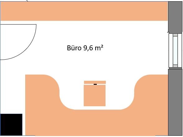

chrisOo schrieb:
What is wrong with the office? It seems fine for my needs, or am I missing something?Even though these are details your floor plan is still far from addressing, it’s good to discuss them.Still: position windows, doors, and fireplace so the office can be furnished practically.
Addition: I just noticed the fireplace has “legs” again and has been moved elsewhere.
(Stove in the kitchen. This keeps getting more interesting...) 😳
