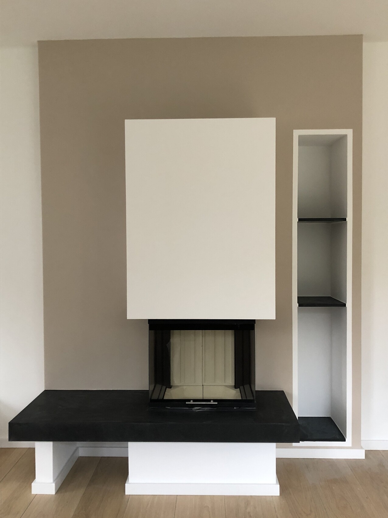

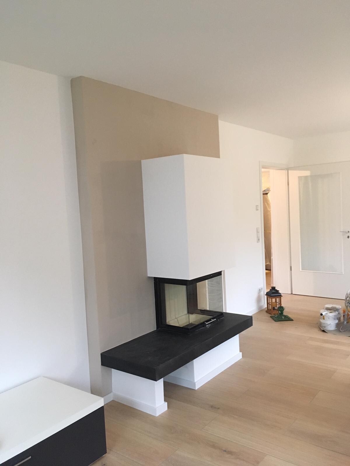

The fireplace was very important to you back then. And you probably had some great moments planning it. So now enjoy your fireplace.
Photos would be nice! We have already enjoyed the fireplace, and it turned out very well and is well integrated into the Zackenbarsch.
The planning really went well here. Even in the bedroom, the fireplace doesn’t bother at all; the wardrobe fits perfectly between the fireplace and the gable wall.
