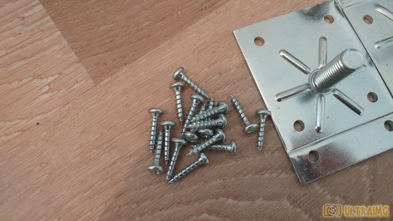

Georg_101120 Dec 2012 19:53Hi,
It’s been a day since the last post, but here’s my suggestion: stick a piece of double-sided tape between the baseboard and the lower cabinet. That way, no leg will slip out when pushing it into place.
So I assume you have Capita stainless steel legs?
There should be 16 screws included with the legs!

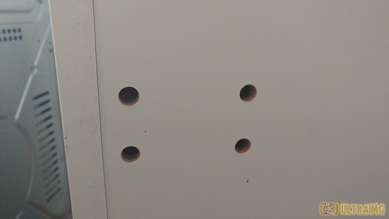

Honestly, I can’t imagine that ALL the legs would be missing screws.I’m sorry to bring up this old topic, but I have a problem with these screws—they are too small for the IKEA cabinet where the oven is installed (Metod). What should I do now? Is there a replacement available from IKEA?
I
IKEA-Experte9 Feb 2017 11:36The screws are exactly right. Capita does not have pre-drilled holes; you have to screw directly into the wood. In the assembly instructions, you can see that the pre-drilled holes are not used.
