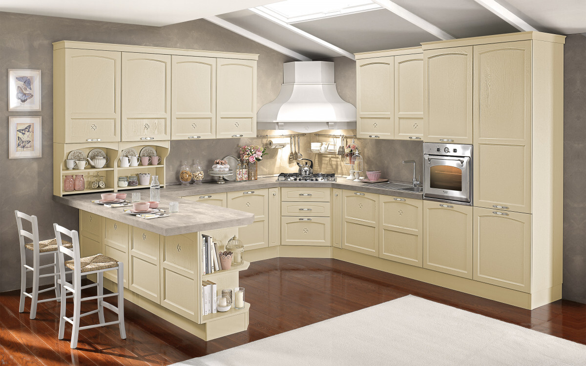

I thought the only solution for the dead corner would be a chamfered 90° corner base cabinet to fit the cooktop and oven, but the overall size would make the kitchen too long on both sides again.
Faktum still offered this, but unfortunately, exact measurements are nowhere to be found.
Cooking in the corner:
If I understand @kbt09 correctly, the cabinet carcass there mainly serves as a support in the dead corner and isn’t really used otherwise.
I’m not sure if a angled cabinet is truly effective – the “angled” sections still remain dead space, and the problem of cabinets blocking each other at the corner is actually made worse. Without an angled cabinet, this issue affects the two cabinets to the right and left of the corner; with an angled cabinet, it affects those two plus the one in the corner (in this case the oven, which I would personally always install elevated if possible, rather than below the cooktop).
