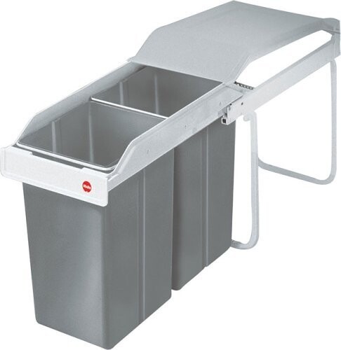

Sektionschef16 Aug 2012 22:38For anyone interested:
I have now found a double trash bin that can be installed in a pull-out drawer and whose lid opens automatically when the drawer is pulled out. It’s the Ökoflex 3434 model. It can also be combined with a foot pedal, which then opens the drawer automatically when you tap the baseboard with your foot.
Now I just need to clarify whether this will fit inside the base cabinet with a pull-out drawer of a Domsjö sink. According to the brochure, I need a clear height of at least 431mm (17 inches) and a depth of 372mm (15 inches).
Sektionschef

IKEA-Experte19 Aug 2012 19:37Glad you found something suitable for yourself.
The dimension drawings specify a maximum width of 60 cm (24 inches). Have you taken that into account? I assume this relates to the attachment of the lid. I would check this with Hailo beforehand.
Sektionschef20 Aug 2012 08:29Glad you found something that suits your needs.
The drawings specify a maximum width of 60 cm (24 inches). Have you taken that into account? I suspect this relates to how the lid is attached. I would check this with Hailo beforehand. Yes, that's correct. Thanks for the hint. I am currently trying to locate a Hailo showroom/dealer in Vienna where I can see this system in person. The waste sorter we have in our current apartment is designed for 30 cm (12 inches) drawers but is installed on the left side inside a 60 cm (24 inches) base cabinet. The lid on the opposite side was also mounted on the left side using a metal bracket. I think the 3434 system can be installed similarly, but I need to clarify that.
