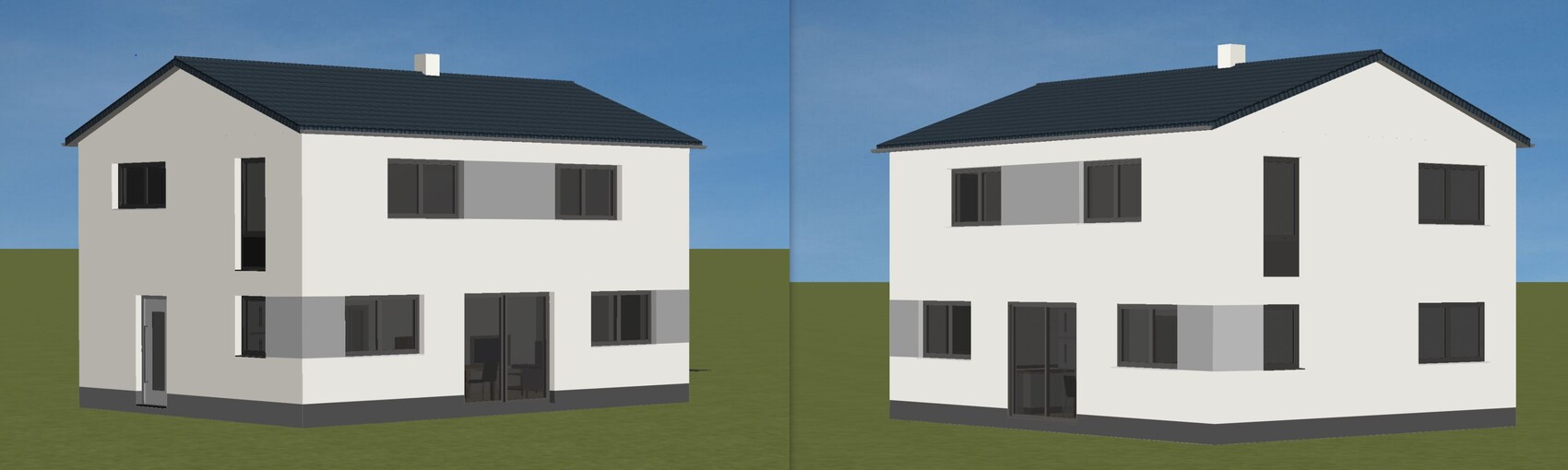

Hello fellow home builders,
I wanted to share my design plans with you and would appreciate your feedback. Do you have any suggestions for improvements? Do you like the design? What would you do differently?

Thomas88 schrieb:
Please only evaluate the exterior view and the window arrangement.

Bertram100
27 Jun 2021 13:27
A G-shaped kitchen can be a bit tricky because you often get in each other’s way. When standing next to a corner, your body can block access to two cabinets. Additionally, the countertop is more expensive due to the increased number of corners.

I’ve spent the entire day working on the planning and tried to take your suggestions to heart.
What do you think about it?

Bertram100
27 Jun 2021 14:35
I think it's better than before. It still really looks like a two-family house, though. But that doesn’t matter. What has changed inside in terms of the rooms? You seem to be quite focused on the exterior appearance. Usually, that is planned last. It would be better to first look at the functionality of the rooms.
If you furnish your floor plan with to-scale furniture, and plan a practical wardrobe and bedroom, the windows will end up out of alignment again.

I have optimized the colors again.
It works well for the rooms.
I have already included furniture in the plans, and our furniture fits well.
The furniture is to scale.

Bertram100
27 Jun 2021 16:48
Well, if the rooms work for you, then that’s good. At first glance, quite a few things don’t seem optimal for good functionality. But everyone is the architect of their own house. I just don’t understand why you’re so hesitant to consider the overall perspective. I can tell you that my experience living in a mid-terrace house is not a pleasure. It works and fits with the rest of the house, but if I had to design, pay for, and live in a house of your size, I would really appreciate a well-functioning entrance area.
