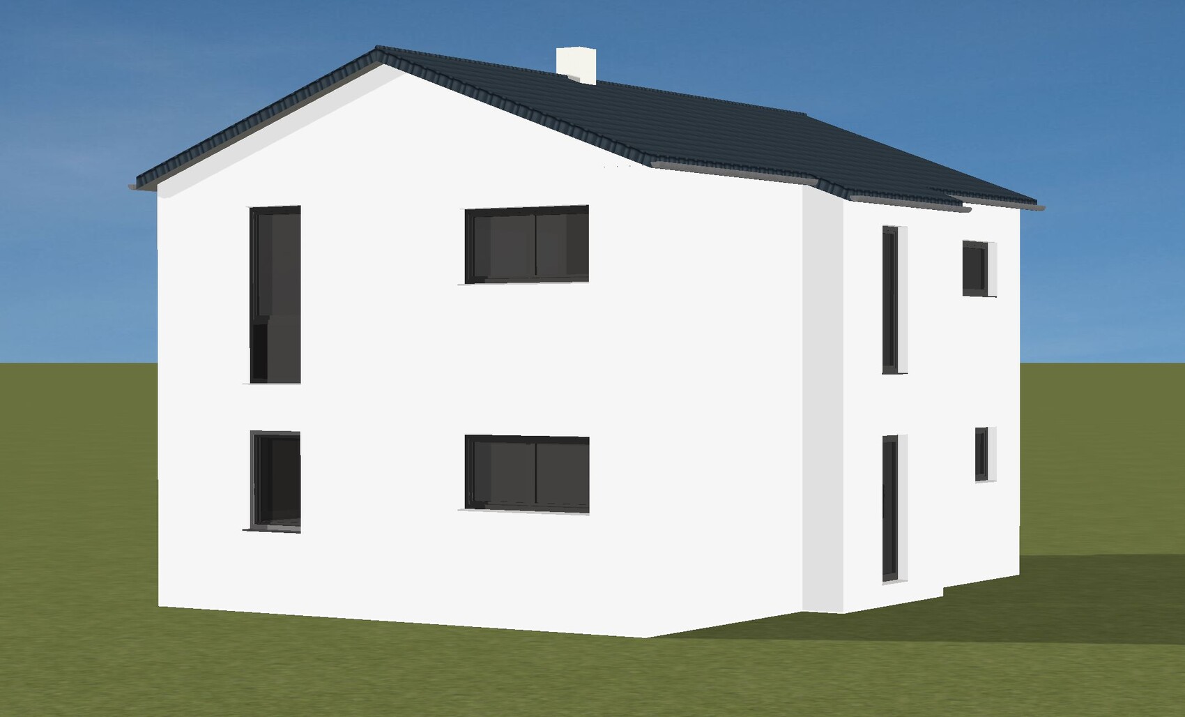

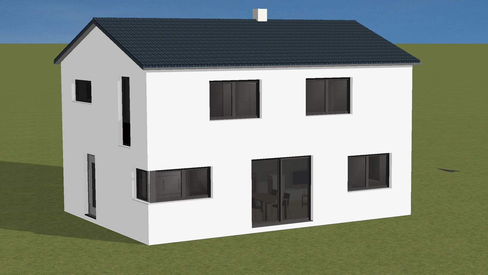

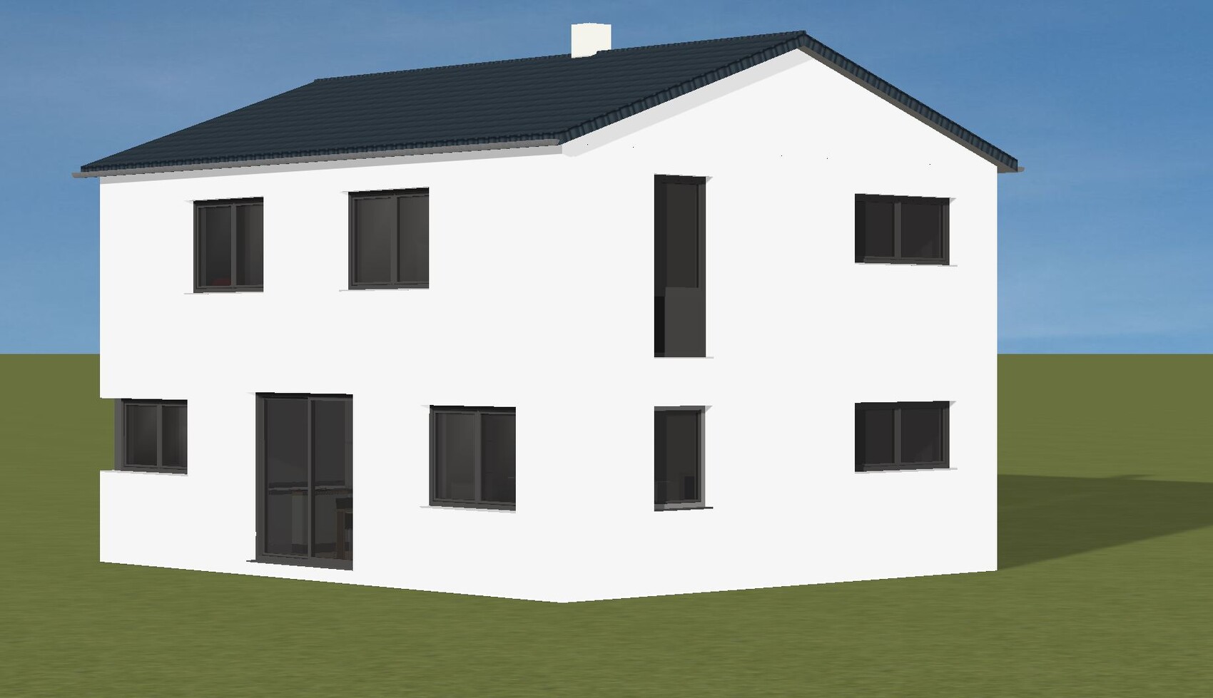

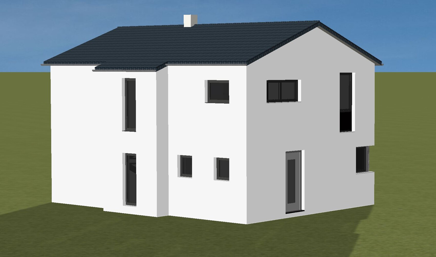

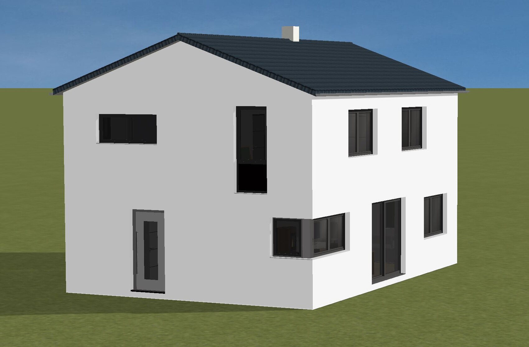

Hello fellow home builders,
I wanted to share my design plans with you and would appreciate your feedback. Do you have any suggestions for improvements? Do you like the design? What would you do differently?
Thomas
3D view of a white house with a dark roof on green terrain
Two-story white residential building with a dark pitched roof, numerous windows, on green lawn.
Modern white two-story house with dark tiled roof, large windows and sliding glass door.
Modern two-story house: gray left facade, white right facade, dark roof, several windows
3D model of a two-story house with white and gray facade, dark roof, and windows.

Thomas88 schrieb:
Do you have any suggestions for improvement?
Yes, floor plans as well as an overview showing how this house is positioned on the plot.
Thomas88 schrieb:
Do you like it?
To be honest, no, because the windows are arranged quite randomly.
Sorry, the pictures really don’t provide any more feedback. I don’t even know which side is the front or back 🙁
Please share the floor plans and a site plan showing the plot layout.

@Thomas88 ... what can you say about this without a crystal ball?
We have the forum section https://www.hausbau-forum.de/forums/grundrissplanung-Grundstücksplanung.237/, and there is a pinned thread there that should be read and followed accordingly.
Three different parapet heights all over the place, without knowing if they even make sense from the floor plan perspective.
Nida35a26 Jun 2021 22:25
Plot, neighbors, cardinal directions, floor plans, without all of these, it’s like Lego from a grandchild, look what I’ve built

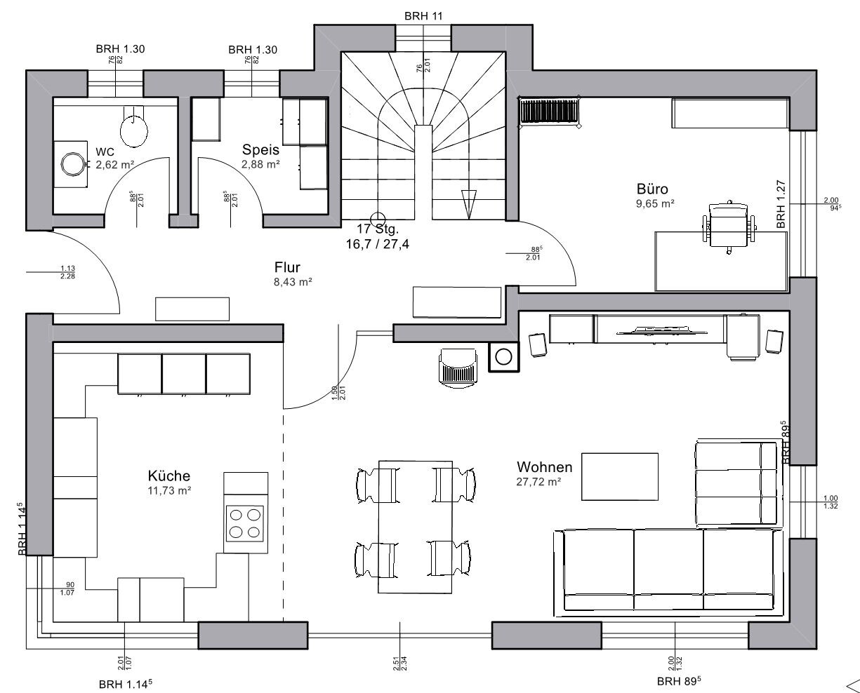

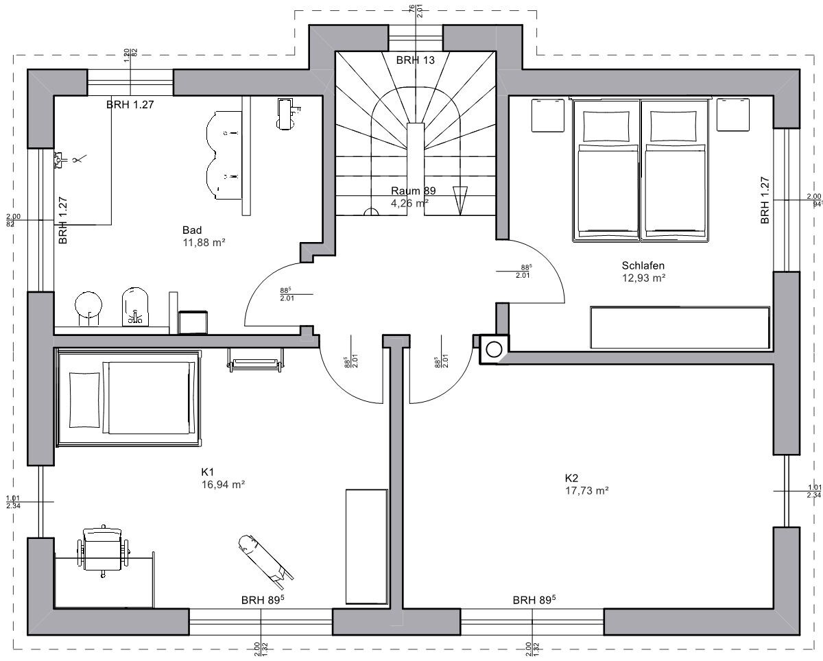

These are still the floor plans.
Regards,
Thomas
Floor plan of a residential house: kitchen, living room, office, hallway, pantry, and WC with furniture.
Floor plan of a house with bathroom on the left, bedroom on the right, K1 and K2, central staircase in the middle.

I thought from the exterior views that this would be a two-family house. 😀 But it looks like a mansion for three people?
