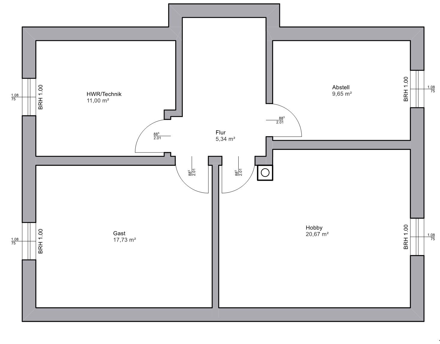

Thomas88
27 Jun 2021 09:04
Tassimat schrieb:
@Thomas88 Where is the utility room with all the equipment, washing machine, etc.? In the basement?
yes, it is in the basement 🙂
