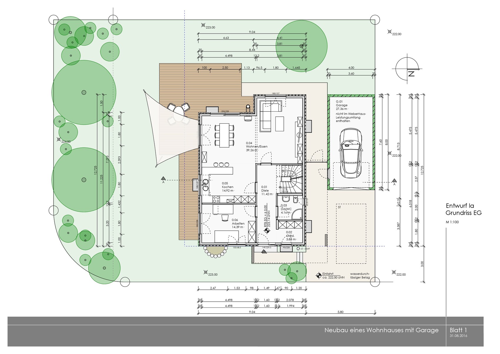

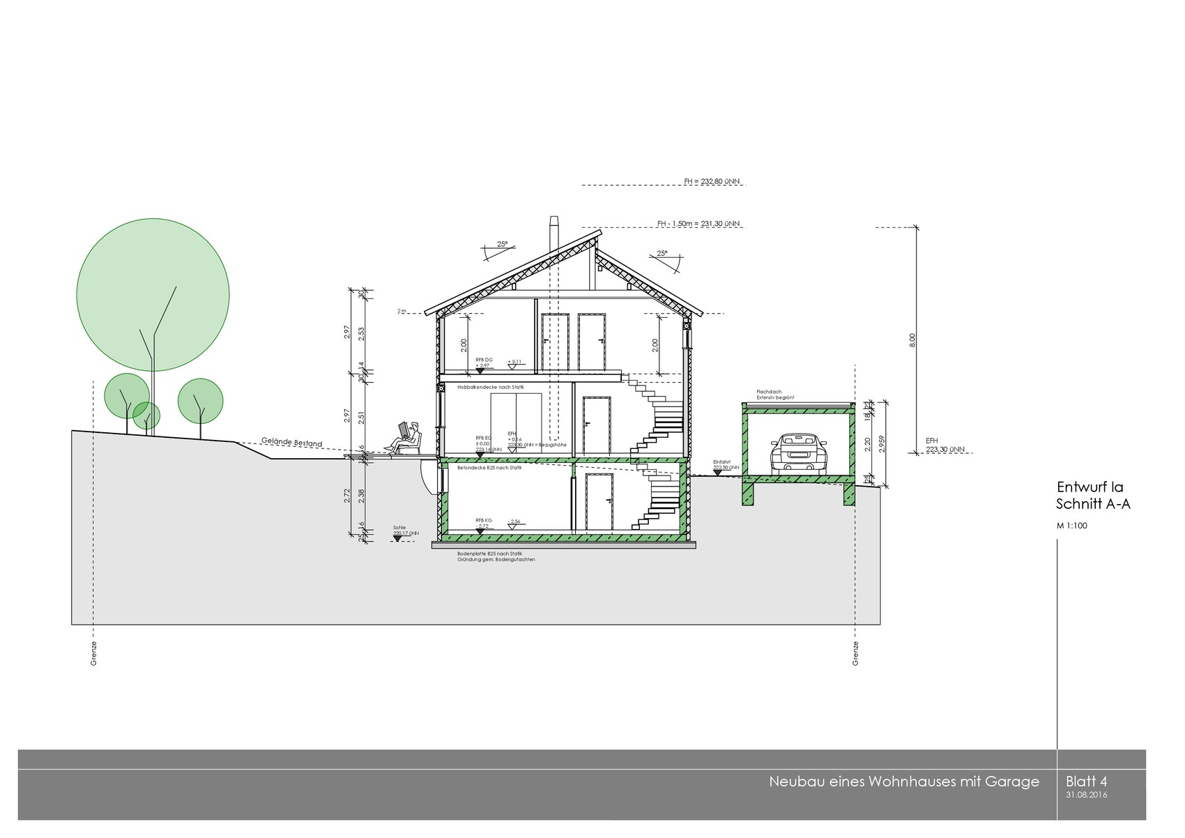

I am an avid reader of this forum and have already incorporated some of your ideas into our planning.
We are now approaching the final stage (building permit / planning permission) but still have a few questions and are not completely certain about some decisions.
Could you please support us once again?
Here are the questions...

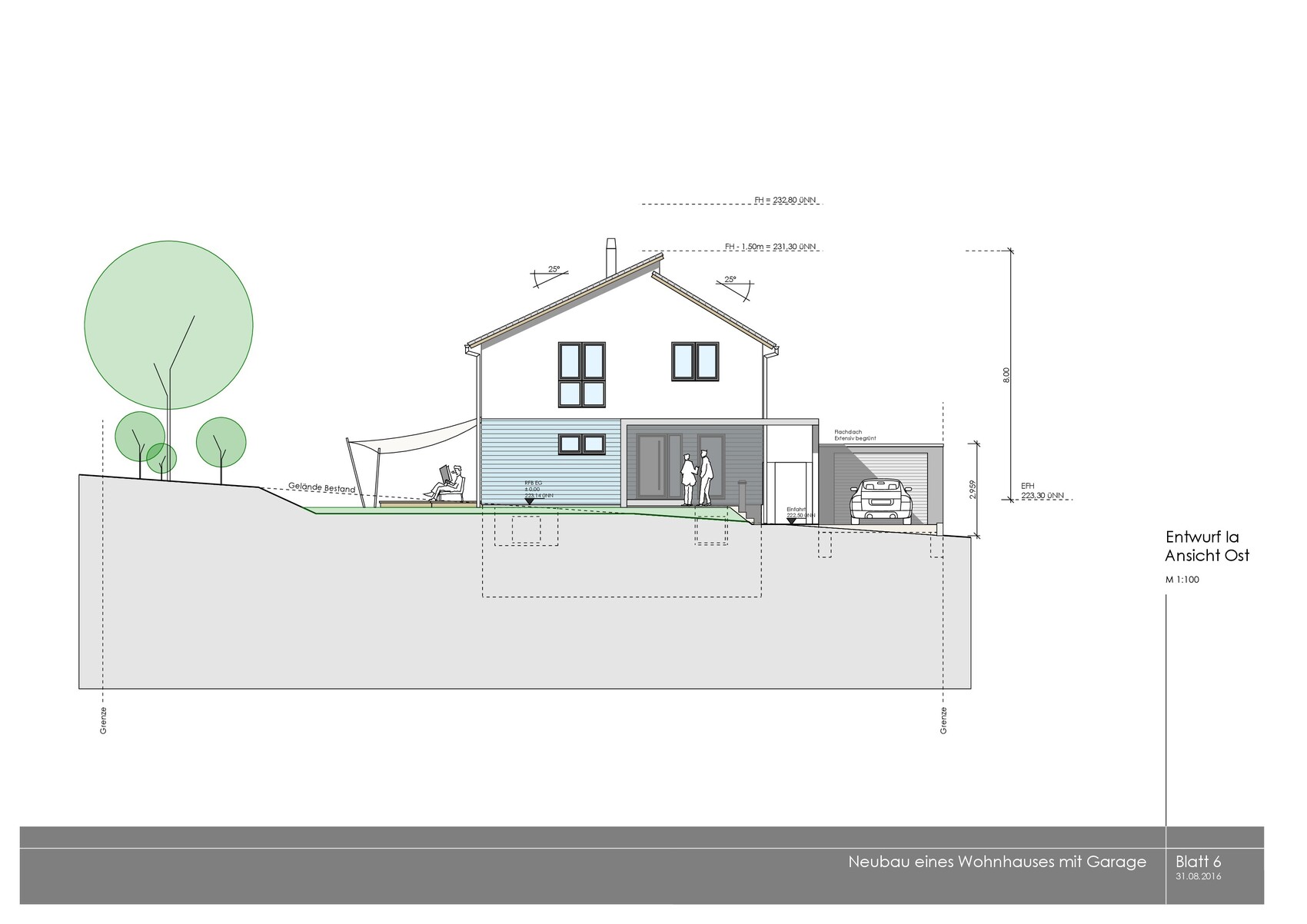

Is a roof pitch of 25° practical if it allows us to achieve a knee wall height of 2 m (6 ft 7 in)? Are there disadvantages to a flatter roof?
Should we also plan knee wall windows on the south side?
Do you see any other areas for optimization?

Schnitt durch ein mehrstöckiges Wohnhaus mit Keller und Garage, umgeben von Bäumen.

Thank you very much for your feedback!

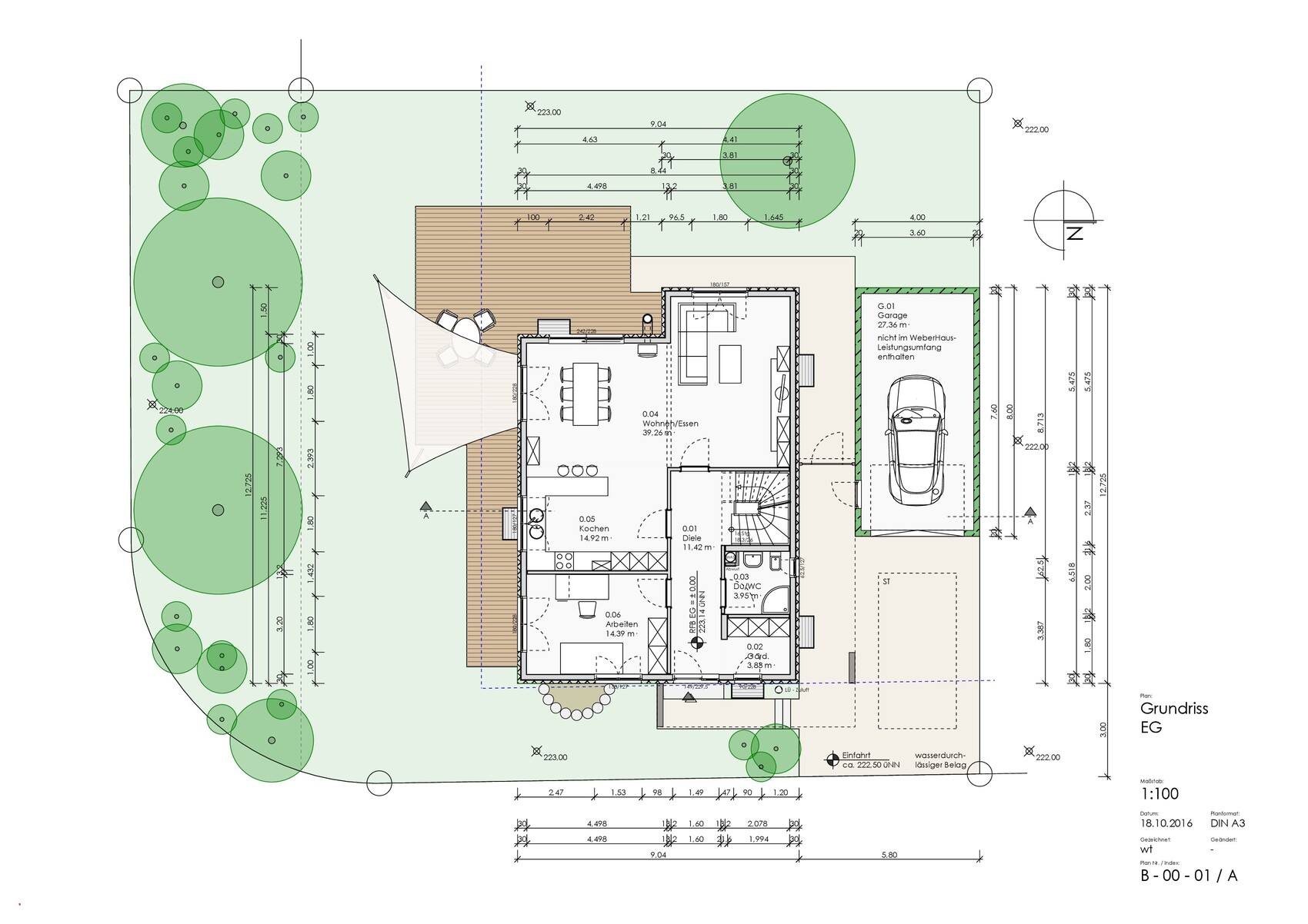

Do you have any ideas on how we could improve the entrance area from the hallway to the kitchen? Would a sliding door help here?
My feeling is that the door will often be left open, which could block access to the kitchen cabinets.
Thanks!

We loosen this up on our side with a glass sliding door.
If I were you, I would also install a larger door from the hallway to the living/dining area.
We are installing a glass door with a side panel here. I was "surprised" how affordable these are for us.

Our floor plan has the same entrance layout with a hallway/kitchen. We will install an internal sliding door here because we also believe the door will mostly remain open, and we don’t want to constantly block the tall cabinets behind it.
jaeger30 Nov 2016 23:01
Or simply position the door half a meter (1.6 feet) higher or choose a different door swing direction.

skybiker2000 schrieb:
Do you have any ideas on how we can improve the entrance area from the hallway to the kitchen? Would a sliding door help here?
I feel that the door would often be left open and then block the kitchen cabinets.
We have a very similar floor plan and installed a glass sliding door for the kitchen that slides along the wall in the hallway. A regular door would just get in the way; we really like this solution.
