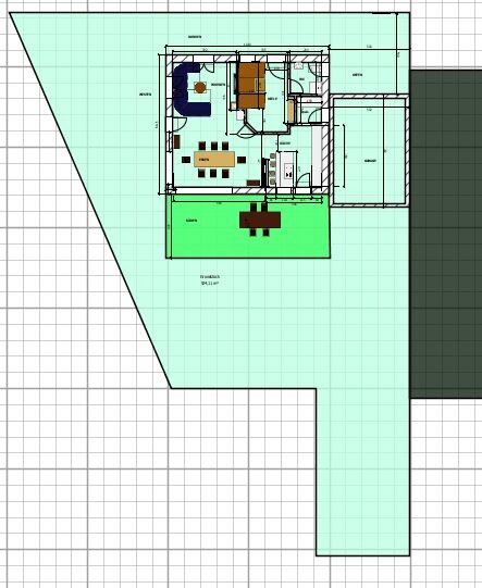

It would be helpful to receive detailed feedback or suggestions for improvement along with any criticism; otherwise, it doesn’t achieve much. Why and where is the kitchen considered too small or narrow? There is 1.15 m (45 inches) between the island and the cabinet along the back wall. At the seating area for four, the countertop has a 25 cm (10 inches) overhang, providing a total of about 85 cm (33 inches) of seating space. That’s not huge but sufficient.
We have already taken the design to three kitchen showrooms, and none of them indicated that any space is lacking—especially since we are building with a pantry.
Don’t get me wrong—I am open to suggestions for improvement. That’s why I’m posting here. But please provide reasons for your feedback.

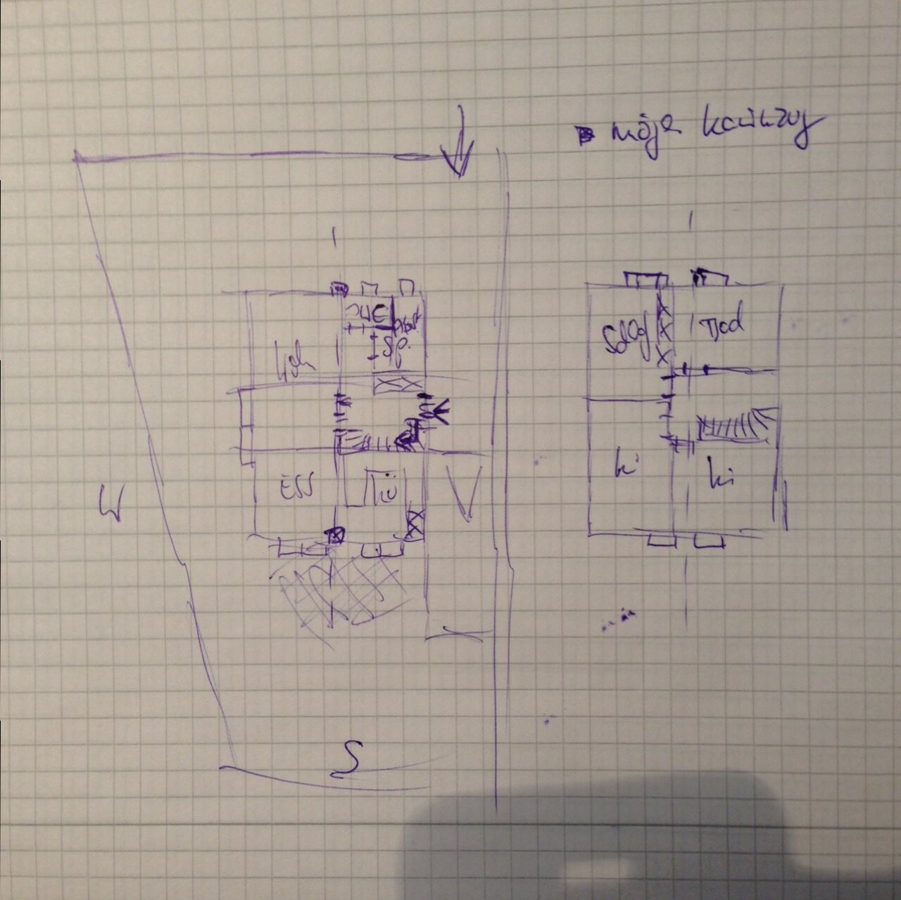

Sorry, I don’t see the floor plan as final yet – there are still several issues that can’t be fixed just by moving walls.ypg schrieb:
On the topic of constructive criticism: I don’t see any way to quickly improve this mess.tobiwan schrieb:
Since we can still move walls or plan for a half-turn staircase, we are open to feedback on our "mess" anyway.tobiwan schrieb:
It would be helpful to get detailed advice or suggestions for improvement along with the criticism; otherwise, it’s not helpful.Please read all of this again.
We don’t know the rest of the plot, no site plan. Someone already mentioned this here, so it’s not possible to give truly constructive feedback.
I’m only objectively pointing out things that don’t work. A staircase that doesn’t function, a chimney you bump into...
Of course, there is cabinet space in the kitchen, but not room for 3 or 4 people inside the kitchen at the same time. It’s not just one person working while the others are standing in front of the counter being served. One person is cooking, the second needs access to the plates, then a third comes and blocks the refrigerator... Or what happens if children want to cook along? Three people will be stepping on each other’s feet and won’t be able to pass by one another, or at least it will be very difficult.
You have to decide from the start: a larger house design without a basement or a smaller one with a basement – it is understandable that not everything will be possible if the budget sets a limit. Take a look on Google for house plans of your size: are the walls as convoluted as in your design?
Maybe reconsider whether @milkie might be right about including the pantry in the hallway.
Or why have a shower on a floor without bedrooms? Why not have the shower where the sauna is planned?
And what I just noticed: the room division between dining and kitchen – no one can sit comfortably at the counter!
For a "small" ground floor, there is no room for a 2.20m (7 ft 3 in) table, an island with a breakfast bar, an additional kitchen/dining separation, a pantry, a shower, and a fireplace – no matter how you arrange it. At least a layperson will find it very difficult or impossible to implement.
Why do you insist on a room layout that is clearly causing problems for you?
You initially spoke of a final design, but in my opinion, you’re still months away from that if you don’t hand the project over to a planner or architect.
Regards, Yvonne
Edit: Remove the kitchen island and sliding door and plan an open living kitchen with an L-shaped kitchen layout.
