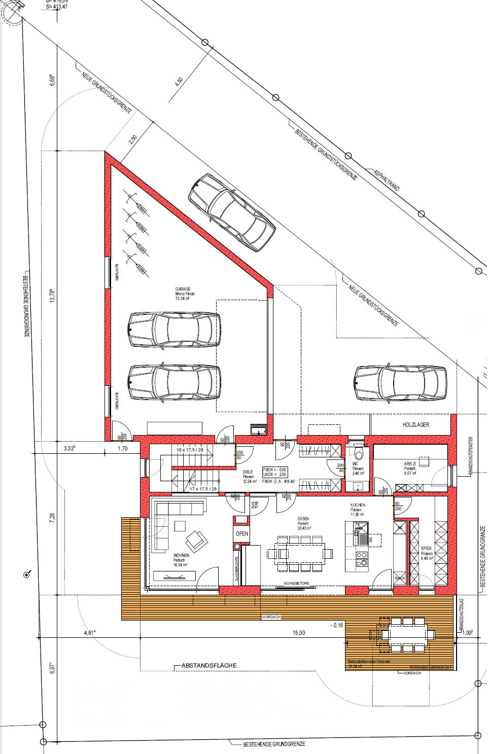

PitFlocke14 Nov 2018 10:26Hello everyone,
I am currently planning my house and have received the first drafts. However, I would like to gather more opinions and ideas. Please share your feedback, suggestions, possibilities, and also any criticisms of the current design. I am open to everything.
THANK YOU =)

House draft
Who created the design: independent planner
Use of the plot, although there might be a better alternative
What do you not like? Why?

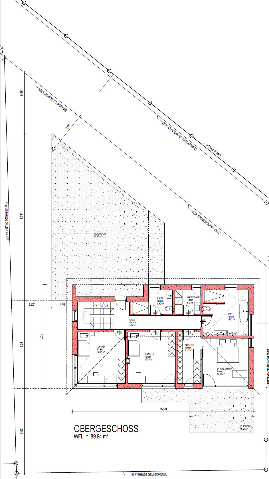

On the upper floor: Bathroom is not ideal because it is actually too large, and the space in the center of the room cannot be used. Perhaps a different layout would work better...
Price estimate according to architect/planner: -
Preferred heating system: Groundwater heat pump
Why is the design like this? Result of discussions and input from us and friends
What is the most important/basic question about the floor plan summarized in 130 characters? Separation of living room and kitchen/dining with access from the hallway, south-facing orientation

Mottenhausen14 Nov 2018 11:46In general: The house must not be aligned parallel to the street, but it could be moved further north if it were slightly narrower and the garage a bit smaller. At the moment, it feels like half of your plot is taken up by the huge garage, driveway, and parking space, while the garden is just a very narrow strip. Good for the cars, not so good for you.
PitFlocke14 Nov 2018 12:00Hello Mottenhausen,
Yes, the house must not be parallel to the street because all houses in this area are aligned this way, and changing that would disrupt the local streetscape.
Yes, that is currently not 100% ideal, but many different designs have not really helped us to create more usable space in the south or southwest.
Best regards, PitFlocke
Mottenhausen schrieb:
In general: The house is not allowed to be parallel to the street, but it could be moved further north if it were a bit narrower and the garage somewhat smaller.
At the moment, it feels like half of your plot is taken up by the huge garage, driveway, and parking space, while the garden is only a very narrow strip. Nice for the cars, bad for you.
I also find the garage too large, especially the sharp angle on the north side, which would bother me. On the other hand, there is hardly a better way to use the space. Moving the garage further north would make it narrower.
- The windows on the front side of Bedroom 1 on the upper floor seem too large. They appear to take up about a third of the wall area.
- Having the dressing room as a walk-through space is rather suboptimal.
- The door between the living room and dining room might interfere with the door to the hallway.
- I wouldn’t be very keen on having direct access from the kitchen to the study.
- The staircase is positioned far to the side. For such a long house (15m (50 feet)), I would try to place it more centrally.
- Is the door in the kitchen really necessary?
- It might also be worth considering building the upper floor over the garage and then designing the house in a more compact L-shape instead of such a long layout. This would include an integrated garage.
sco0ter schrieb:
