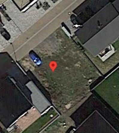

There are no restrictions in our development plan that conflict with our wishes.
Typical requirements include a 3m (10 ft) setback from the property boundary and 5m (16 ft) clearance for the garage, with 2 parking spaces required; otherwise, everything is unrestricted.
The plot is just under 400m² (4,300 sq ft), location as shown in the pictures.

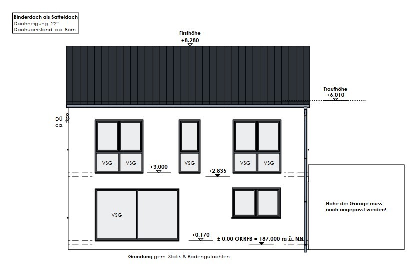

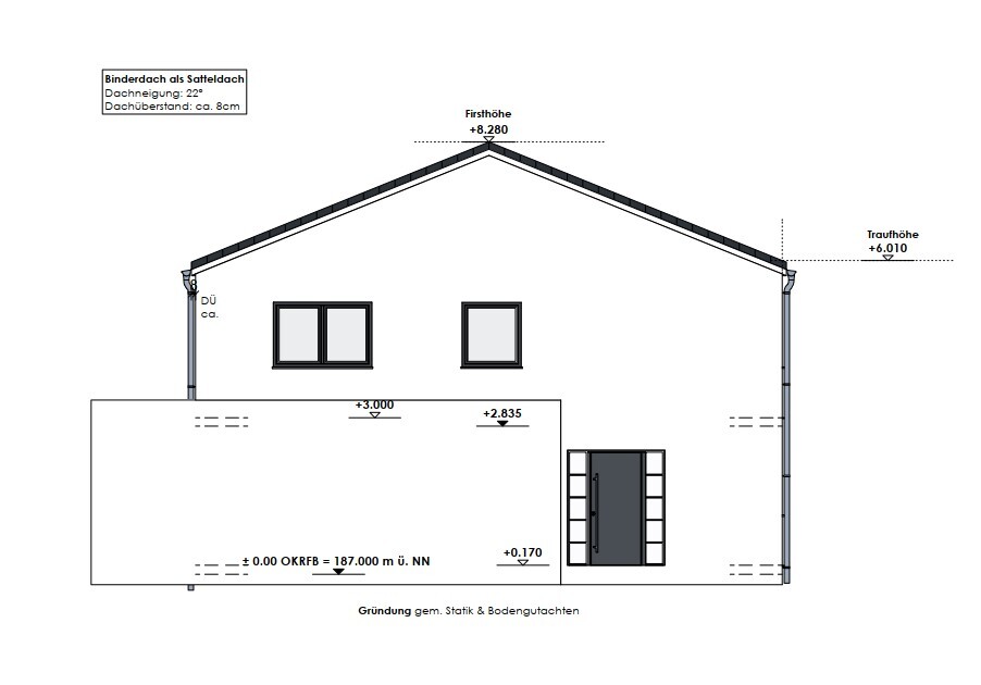

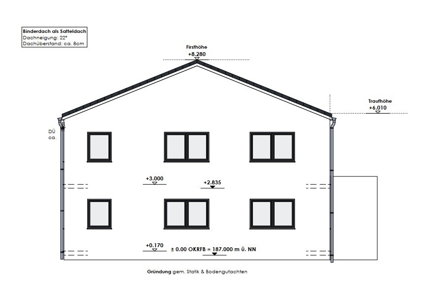

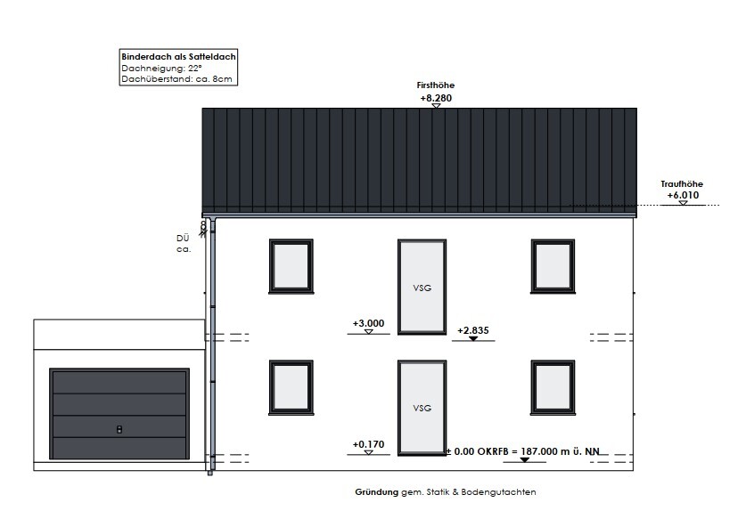

Who created the plan:
- Planner from a construction company.
It’s a first draft.
Entrance “from the courtyard” – the vestibule area seems quite small.
Little corridor space, which we actually like, but we’re concerned it might feel cramped or dark.
How would you position the house? Build as wide as possible across the plot or leave more distance to neighbors on the “living side”? We understand there aren’t many options to “do it better” with a small plot.
Our spatial wishes have been taken into account.
What do you not like? Why?
450,000€ without garage + land (self-build participation).
Personal price limit for the house including equipment:
550,000€.
Preferred heating technology:
Air/water or ground source heat pump?
If you have to give up anything, which details or extras?
- What you could give up:
Straight staircase.
Shower downstairs.
That strange “symmetrical” window arrangement.
- What you cannot give up:
Number of bedrooms, 2 office areas (does not necessarily require 2 completely separate rooms).
It is more important that the interior is nice and airy than that the windows align precisely on the outside.
Why has the design turned out the way it is? For example,
Standard design from the planner with a few wishes we expressed (courtyard entrance, garage position, room layout).
It feels somewhat unmodern and not very well thought through for us.
3 windows in the walk-in closet? Swap kitchen and living room? We wanted a kitchen with island and tall cabinets behind it. Corridor upstairs without windows?
As mentioned, it’s a first draft, and maybe the “collective knowledge” here can help us move forward. We haven’t had a really personal planning meeting yet.

motorradsilke7 Jul 2022 16:53What I notice: The kids are not allowed to use the bathroom, or they have to go through the bedroom to get there. I wouldn’t like that. I would extend the hallway all the way to the bottom of the plan, then turn right into the walk-in closet and left into the bathroom. That way, you’d have natural light in the hallway; you could shift the window a bit to the left. Maybe you wouldn’t even need an additional shower room then? I would also omit the door to the left of the stairs upstairs.
Beautiful girls’ names 🙂
Nevertheless, I think the house layout is very awkward because of the staircase positioned across from the entrance and placed in the middle. As a parent, you have to walk all the way around the staircase inside the house just to get to the toilet. The walk-in closet takes up a lot of space. The bathrooms are also poorly designed with the showers… there is always a second entrance included instead of welcoming the person entering with a nice view into the room. The master bathroom feels more like a snail shell, with the toilet as the final destination.
The staircase hallway on the ground floor feels excessive… everything could be arranged better.
For the coatroom, make sure a wardrobe with the right depth fits. That’s just my opinion 🙂
