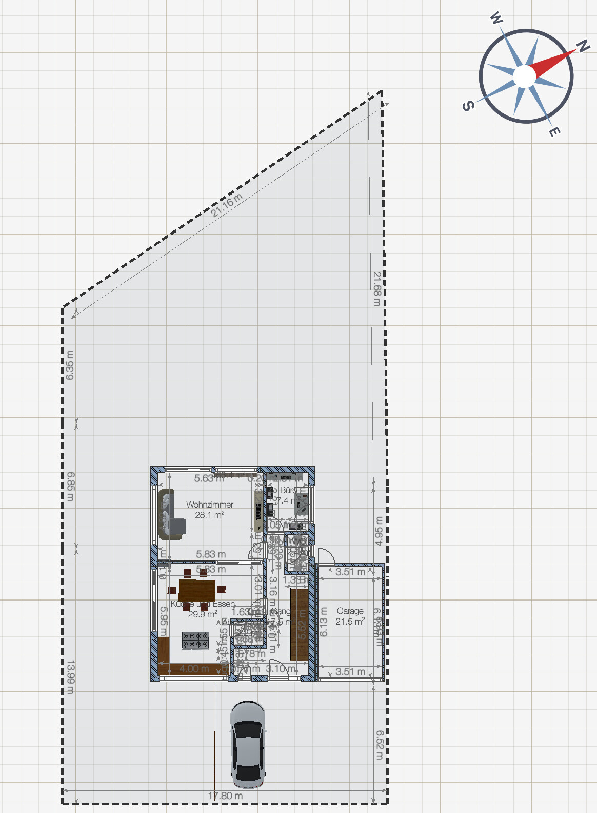

Our plot is located in the middle of the city and is surrounded on three sides by other developed properties. At the front, about seven meters (23 feet) from the main entrance (according to the current plan), runs a lightly trafficked access road.
A special feature of the plot is its relatively elongated shape (17.5 meters (57 feet) wide, 35 meters (115 feet) long).

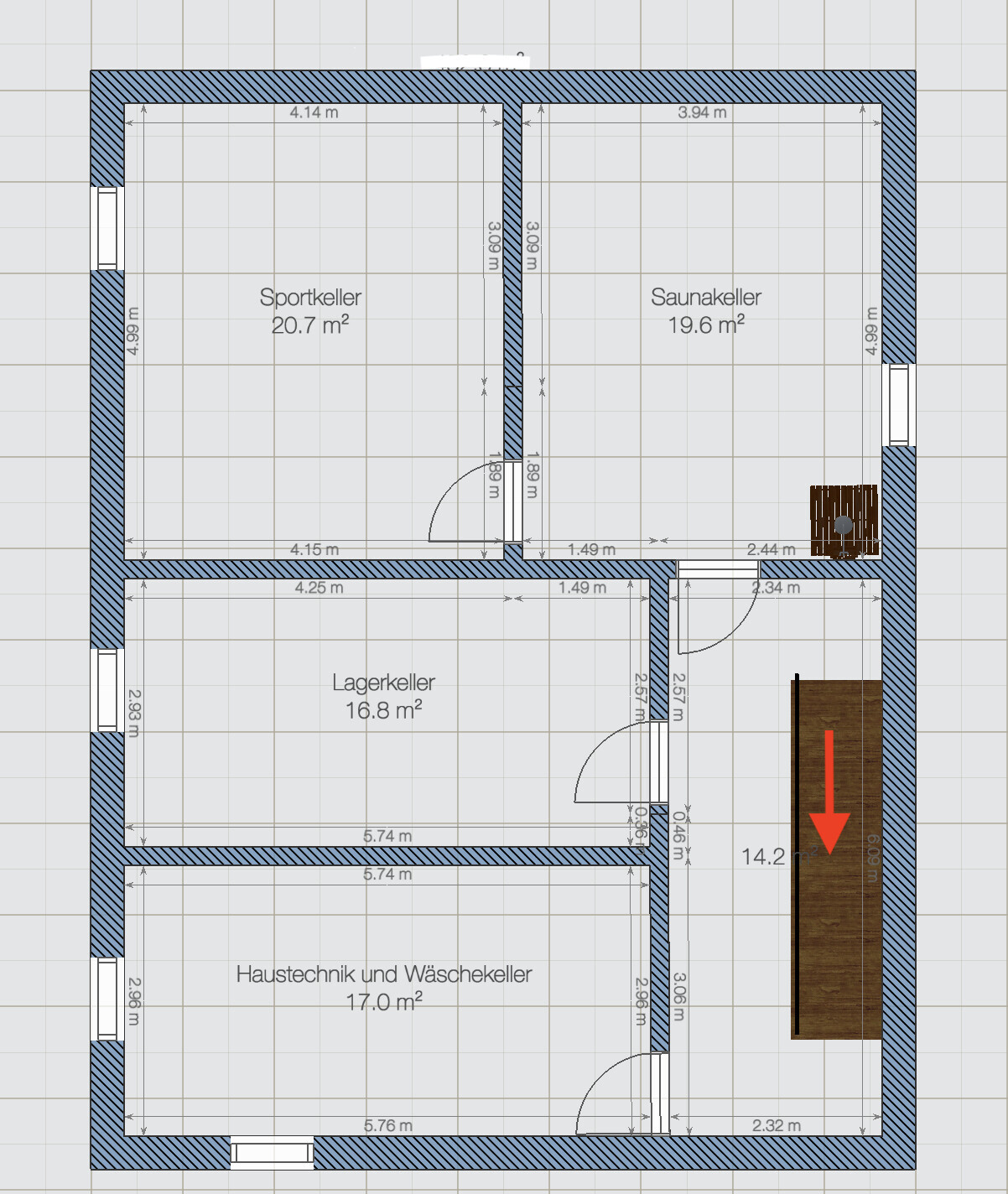

Relatively small living room, separation between living area and kitchen/dining with sliding door (for noise/smell reasons) is not ideal yet, relatively small cloakroom

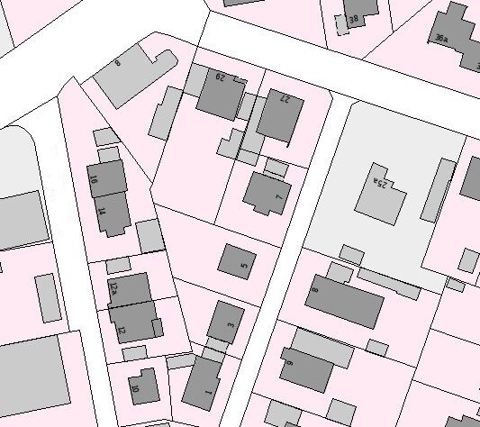

What does that look like? Are the houses lined up without any space between them, or is it a typical residential neighborhood layout? My question somewhat conflicts with the building setback area, but your description of the urban location confuses me a bit.

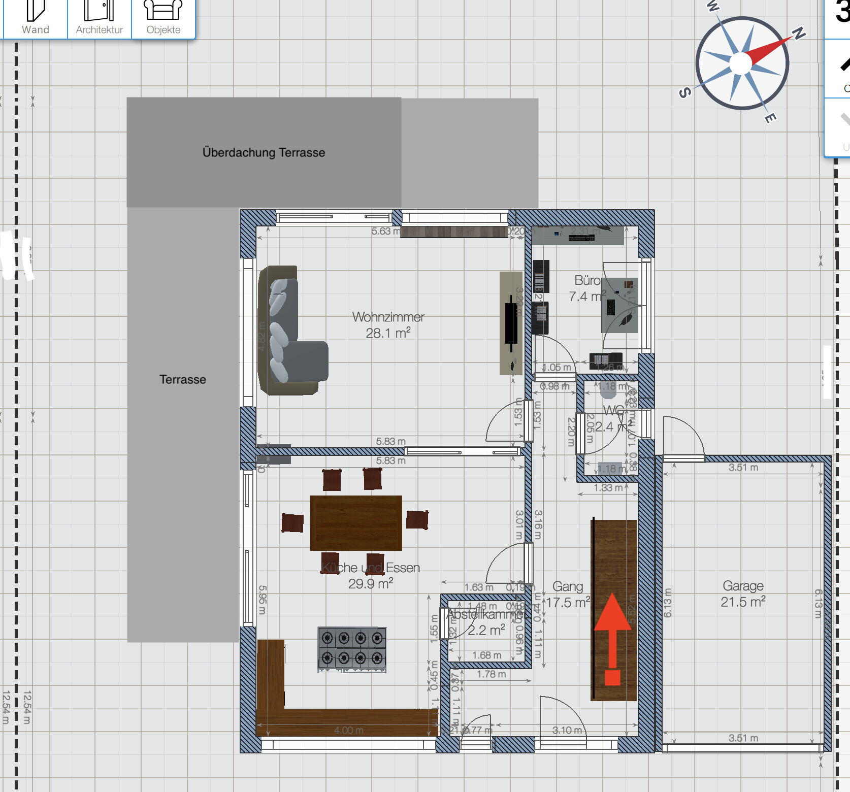

Well, basically, I wouldn’t like that endlessly long corridor; the living room also doesn’t need an extra door—nobody uses it. The small storage room is too small.
Where? At 28 square meters (300 square feet), it’s twice as large as many common house designs require. What do you plan to do there? For hobbies and sports, you have the basement. I typically exclude the basement from my comments, but I would be interested to know how and where you plan to store garden furniture, tools, and bicycles.

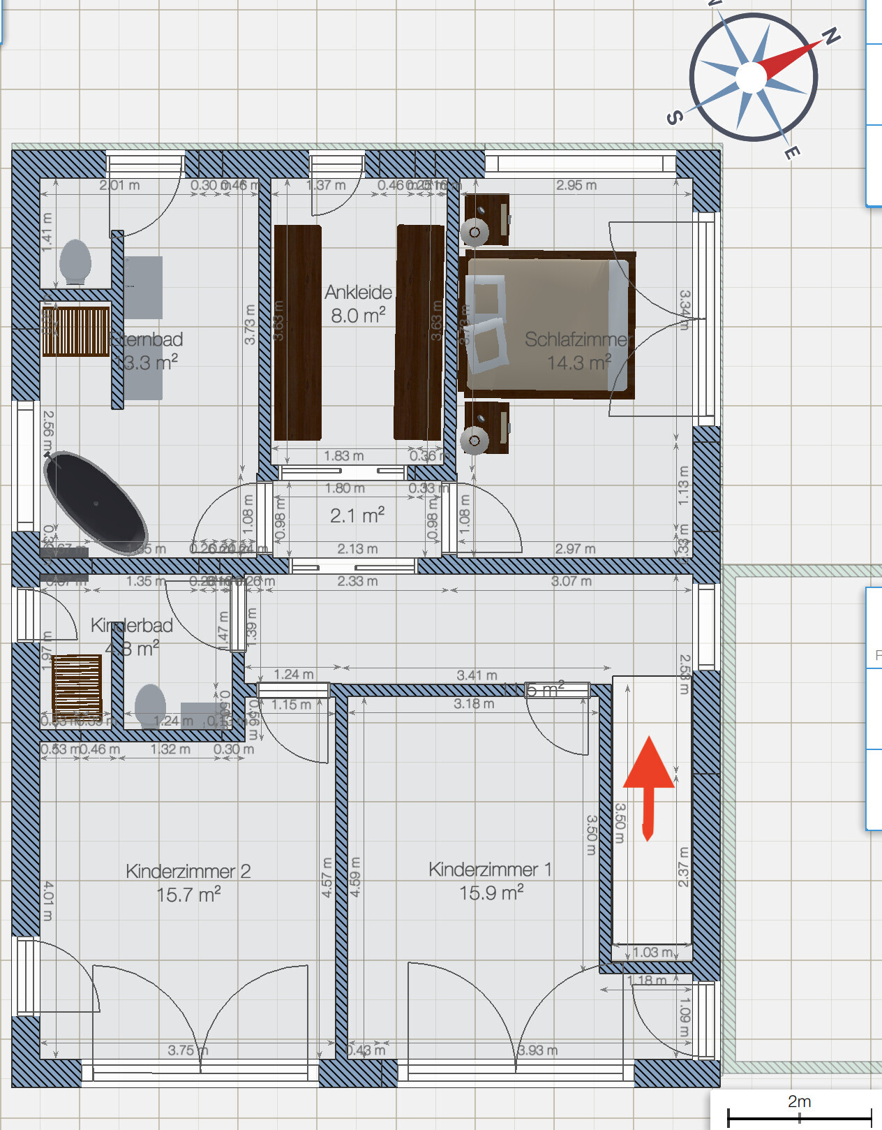

Upper floor: please keep in mind that drains and wastewater pipes require a vertical soil pipe downwards. Ideally, this should be near the toilet. So it makes sense to have one soil pipe serving two bathrooms. Two pipes are also possible, but it’s awkward if the sofa ends up squeezed between two soil pipes. A third shaft would be appropriate here for laundry.
It’s also problematic if a water leak occurs. Damage can be minimized if wet areas are stacked vertically. Ideally, load-bearing walls should align on top of each other.
A dressing room width of 180 centimeters (71 inches) with two opposing wardrobes is too narrow.

I would first give some serious thought to where the terrace should be located. At the moment, you have practically surrounded half the house out of desperation. If the neighboring buildings on the left are relatively close, then the area by the fence probably isn’t the most cozy spot.
How come the building envelope is only 9.5 meters (31 feet) wide? (17.8 - 6 = 11.8?)
I find a small living room of 28 m² (300 sq ft) quite generous. I once had an apartment that size.
So far, the layout feels rather uninviting. The long, narrow hallway makes the ground floor unattractive.
Does the staircase have to be straight?

How should one imagine this? Are the houses built in a row without any gaps? Or is it a typical residential area? My question somewhat conflicts with the building window, but your city explanation confuses me a bit.
Hello Yvonne,
thank you for your feedback!
I wasn’t very clear earlier; this is a typical residential development (see attached map, our single-family house would be built at number 5 – where there is currently an old building to be removed).
Well, basically I wouldn’t like that endlessly long hallway; the living room doesn’t need an extra door. No one uses it. The small storage room is too small.
By “small storage room,” I assume you mean the utility closet?
Where? At 28sqm (300 sq ft) that’s twice as large as many common house designs require. What do you want to do there? For hobbies and sports, you have the basement. I’m ignoring the basement in my comments, but I’m curious where and how you plan to store garden furniture, equipment, and bicycles.
We plan to build a suitably sized shed behind the garage to store these items all year round.
Upper floor: please make sure that drainage pipes also need a waste pipe running downwards. Ideally, this would be near the toilet. So it makes sense to have one waste pipe serving two bathrooms. Two pipes are possible too, but it’s awkward if the sofa ends up wedged between two waste pipes. A third shaft near here would also make sense for the laundry.
It’s also problematic if there’s ever water damage. You can minimize damage by planning wet areas directly above each other.
You’re right about the waste pipes. Our basic plan was to lead both pipes inside the wall towards the drainage in the basement (timber frame construction). But we will definitely discuss this again with the architect in light of your comment!
180cm (70 in) for a walk-in closet with two opposing wardrobes is too narrow.

We definitely need to make the walk-in closet a bit wider, you’re right.

I would first carefully consider where the terrace should be. At the moment, you have almost surrounded half the house out of desperation. If the neighboring buildings on the left are relatively close, the area by the fence is probably not the cozy spot.
Good evening kaho,
thanks to you as well for your quick feedback!
You’re right, there definitely is a need to revise the terrace.
The left side (south side) is relatively close to the neighboring house for about half the length (7 meters (23 feet) distance between the two walls), so for the reasons mentioned, we will probably skip most of the terrace on that side.

Why is the building envelope only 9.5 meters (31 feet) wide? (17.8 - 6 = 11.8?)
Unfortunately, there is a building setback agreement with the left neighbor, so about two meters (6.5 feet) must be deducted from your 11.8 meters (39 feet).

So far, the design feels uninviting. The long narrow hallway makes the ground floor unattractive.
You’re certainly right, my first apartment was even smaller.
We chose the straight staircase on the north side because, in our current opinion, with the elongated building dimensions (9 x 12 meters / 30 x 39 feet), this allows us to best implement the separated parents’ area on the upper floor, and also to avoid having the kitchen/dining area and the living room on the ground floor become too narrow compared to, for example, a U-shaped staircase placed in the center of the house.
Of course, this does not mean that our design is the only practical option to achieve these points; unfortunately, we have not yet found a better staircase position.
The long narrow hallway you mentioned is certainly not an advantage in our plan, you’re right about that.

Is it allowed for the terrace to be built on the property boundary? Often, it is not.
Kiliani schrieb:
By "small room," I assume you mean the storage room?
No, I mean the office. Unless it’s a house of around 109 sqm (1,173 sq ft), I wouldn’t plan anything less than 12 sqm (130 sq ft).
