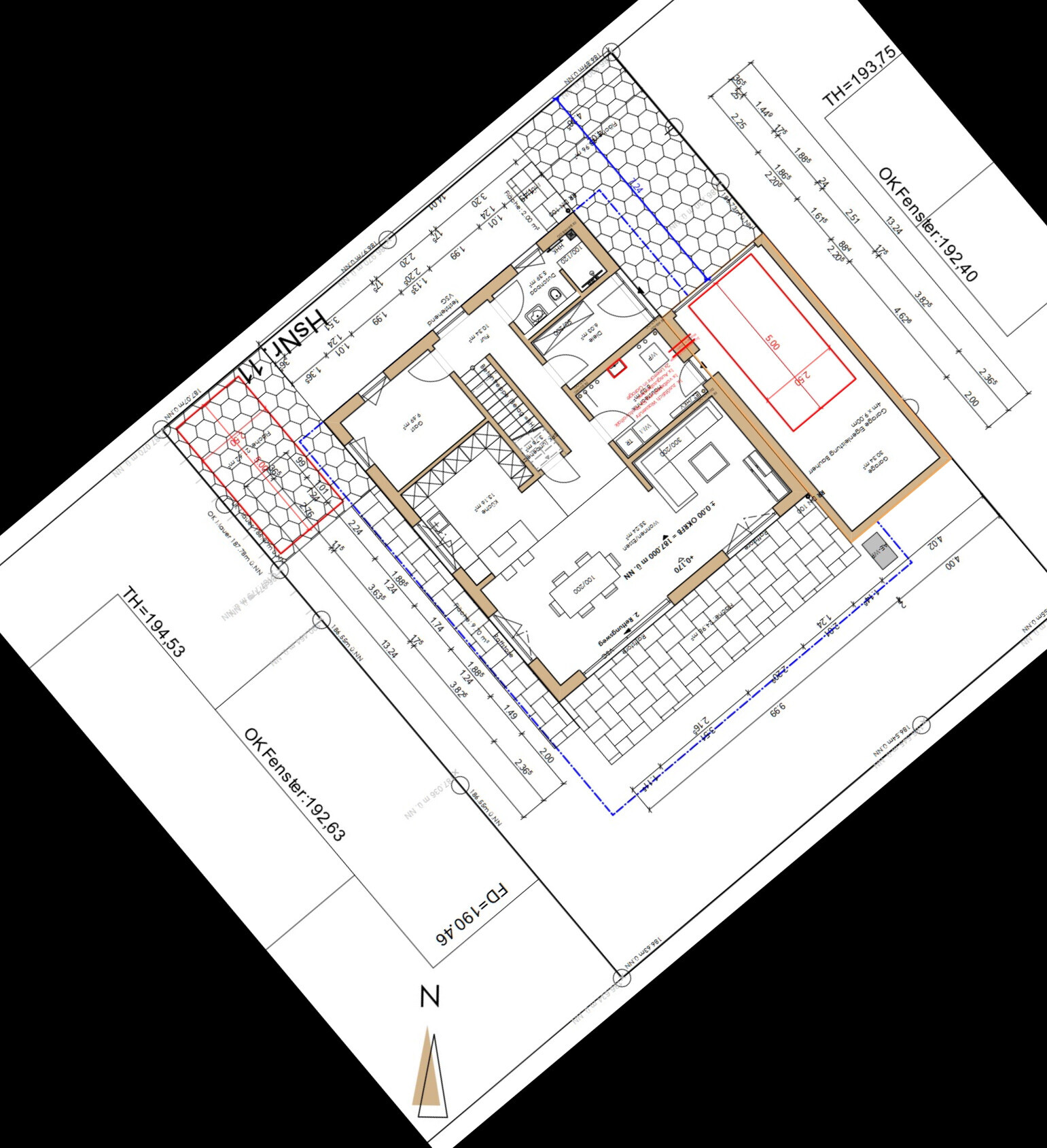

Entrance “from the courtyard” – the vestibule area seems quite small.
Little corridor space, which we actually like, but we’re concerned it might feel cramped or dark.
How would you position the house? Build as wide as possible across the plot or leave more distance to neighbors on the “living side”? We understand there aren’t many options to “do it better” with a small plot.
Our spatial wishes have been taken into account.

Standard design from the planner with a few wishes we expressed (courtyard entrance, garage position, room layout).
It feels somewhat unmodern and not very well thought through for us.
3 windows in the walk-in closet? Swap kitchen and living room? We wanted a kitchen with island and tall cabinets behind it. Corridor upstairs without windows?
As mentioned, it’s a first draft, and maybe the “collective knowledge” here can help us move forward. We haven’t had a really personal planning meeting yet.

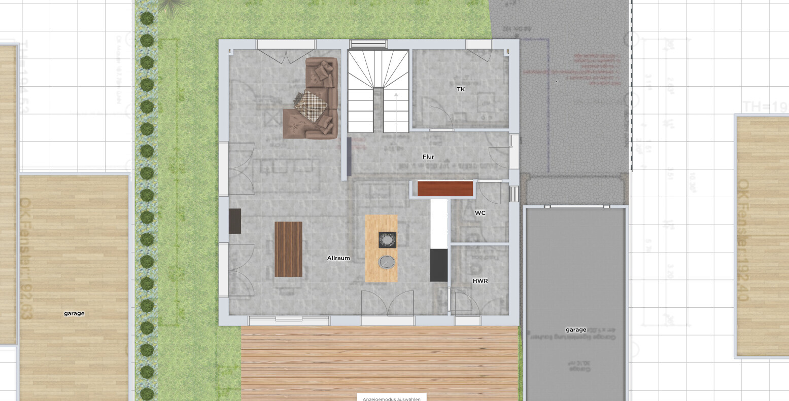

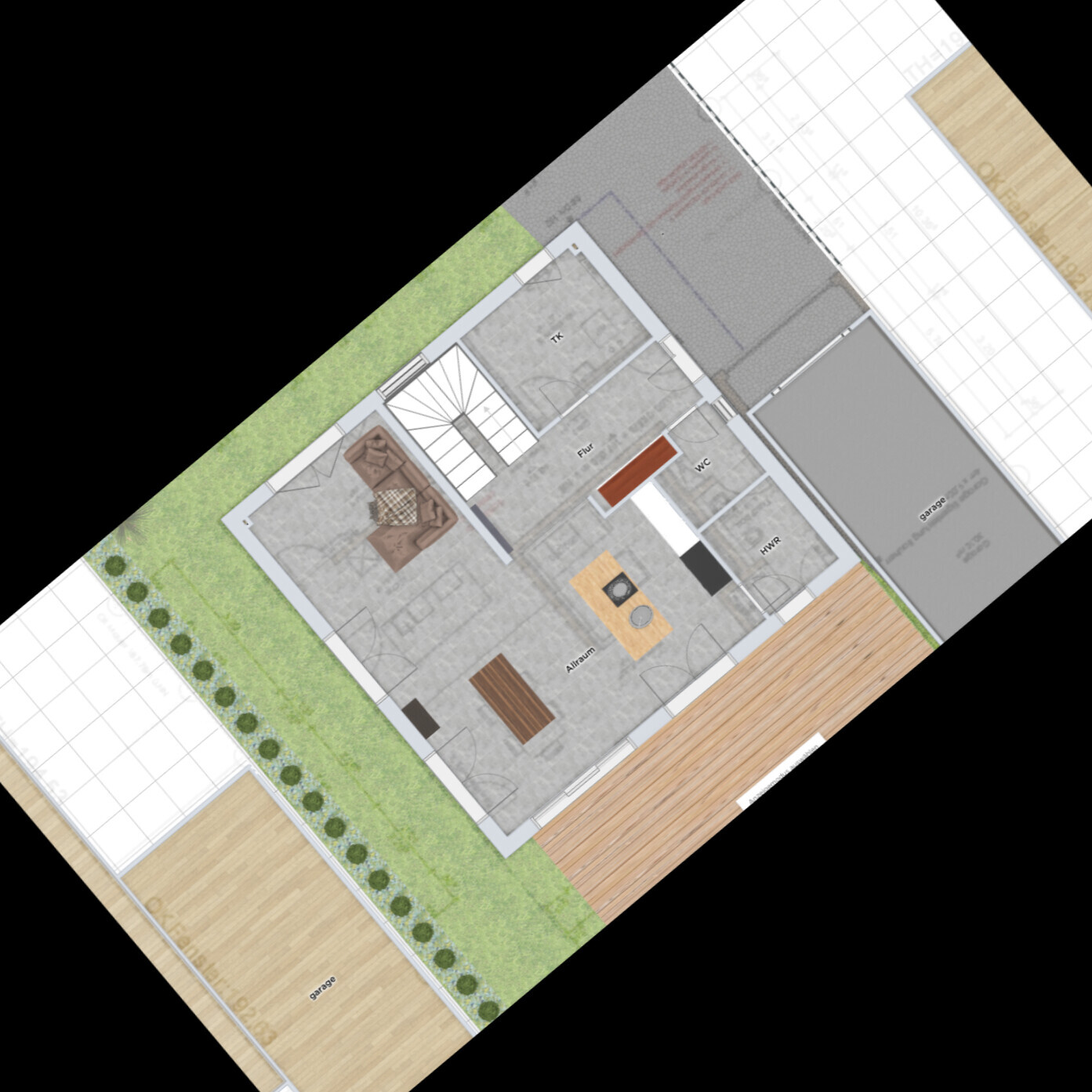

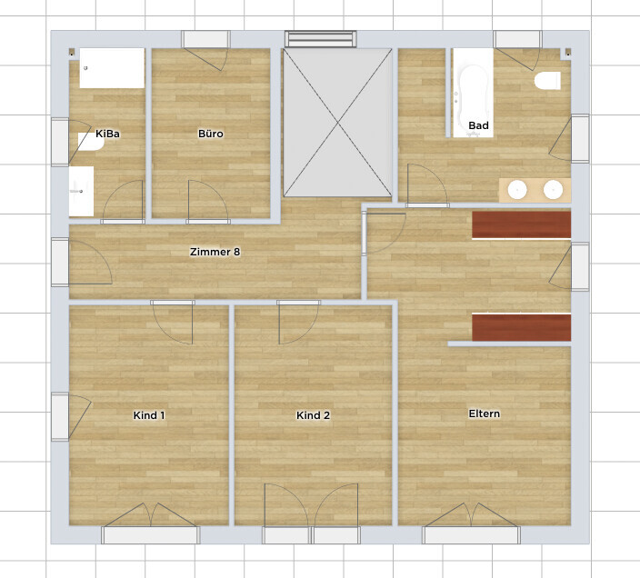

Klaustal schrieb:
Are you an architect or something like that?No, I’m not. More like something else. If I were an architect, I wouldn’t be here but making money 😉Since you and your wife don’t like the slim design, I modified your floor plan a bit to add more spaciousness and light. I deliberately chose an open staircase (my software can’t do landings) because of a window that brings in the afternoon sun from the west. In my opinion, the walk-in closet, storage room, laundry room, and office provide enough storage space.
Still, I think the house looks like a block. But maybe you like some parts of the proposal.
By the way, I think your upper floor is already quite successful. Not everything is bad 😉
kbt09 schrieb:
It definitely provides more light when you compare everything, and the necessary hallway space is also used very efficiently. In addition, the upper floor area, especially the master bedroom section, is much better. What exactly did you compare?
No, I’m not. More like this. If I were an architect, I wouldn’t be here, but making money 😉 That’s probably true.
Since you or your wife don’t like the slim design, .... Let’s see if I can still achieve something "with reinforcement".
My wife thinks that "we would then be sitting out 'on the street'" on our terrace.
Klaustal schrieb:
What exactly did you compare now?Okay. Thanks for clarifying! I had suspected it based on the pictures. But asking is definitely safer.
