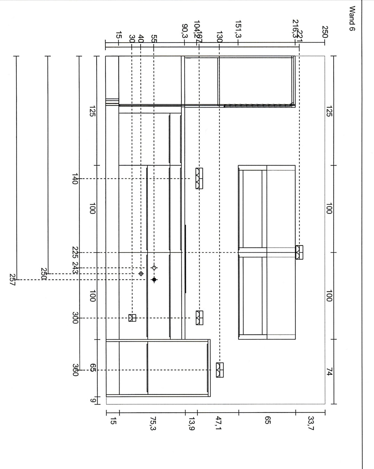

2D floor plan showing kitchen and living space layout with dimension lines

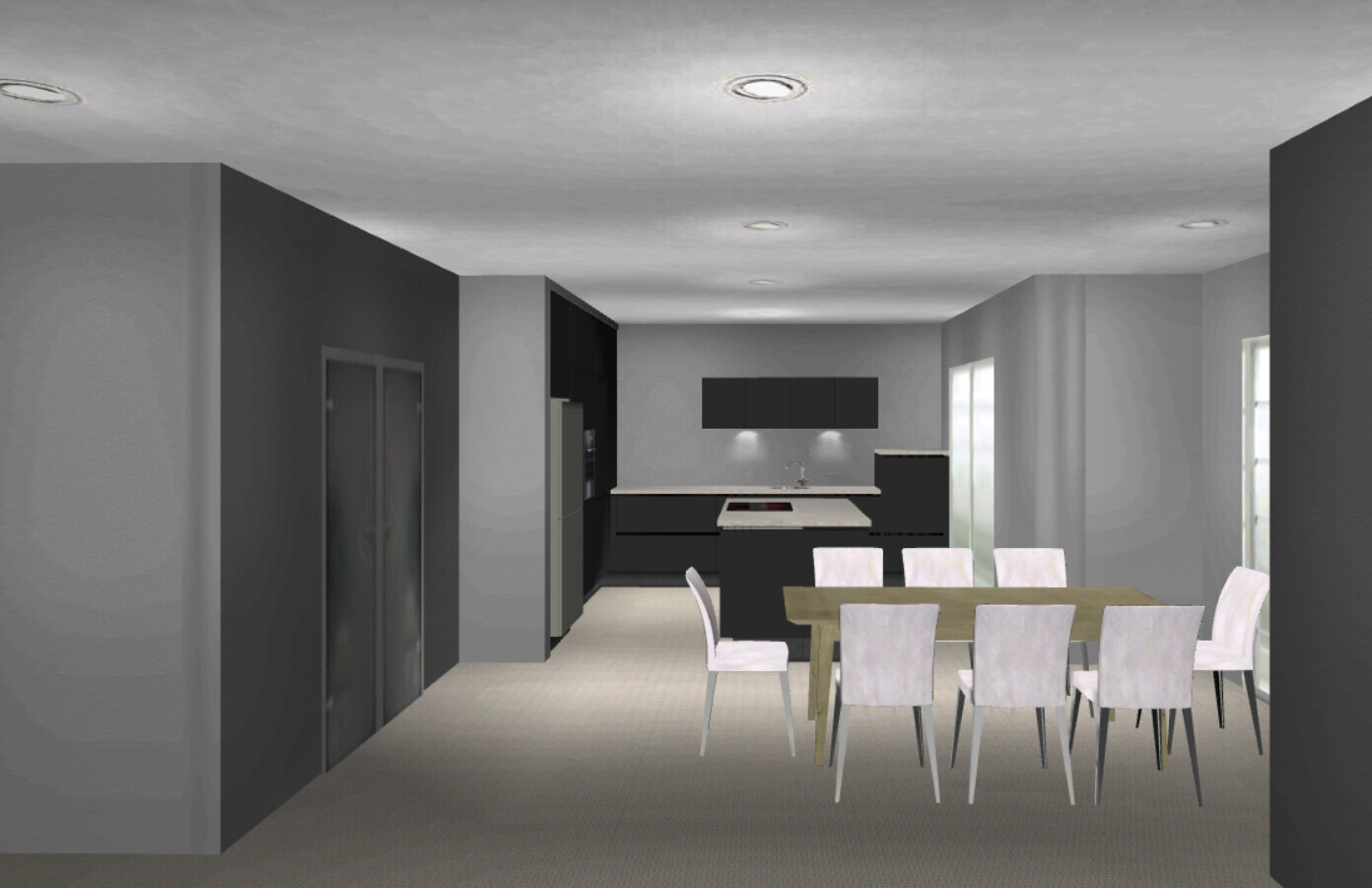

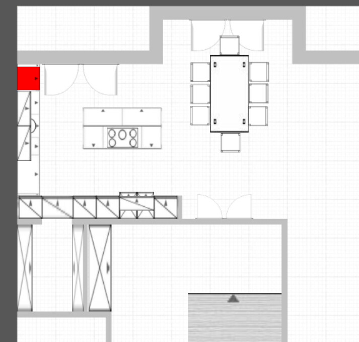

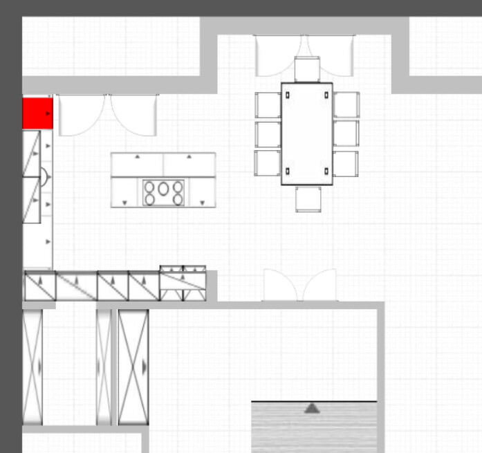

this is the kitchen planning
Open floor plan with kitchen, kitchen island, and dining table in the dining area.
Floor plan: kitchen on the left with cooking island; dining area on the right with long table and chairs.
For me, the row in the kitchen planning on the bottom side of the plan looks too long visually; I would omit the tall cabinet to the right of the side-by-side refrigerator. To the right of the side-by-side refrigerator, drywall construction could be built so that it aligns with the wall at the top of the plan. If the drywall is built slightly deeper, decorative niches with lighting could be added.

evelinoz schrieb:
This is the kitchen cabinet planning.
For me, the run of cabinets along the bottom of the plan looks visually too long. I would omit the tall cabinet located to the right of the side-by-side refrigerator. To the right of the side-by-side fridge, I would instead build a drywall partition so that it lines up with the wall at the top of the plan. If the drywall partition ends up a bit deeper, I would add decorative shelves with lighting.
I also wanted a window on the water side; a construction site window would be sufficient for me. I believe it’s the east side, which gets nice morning light.
You drew that very well. The cabinet run along the bottom of the kitchen is indeed a bit too long. That is immediately noticeable on the floor plan, but I would be interested to see how it feels in reality. I could imagine it hardly standing out. I will discuss this with the kitchen planner when we place the order and then decide.

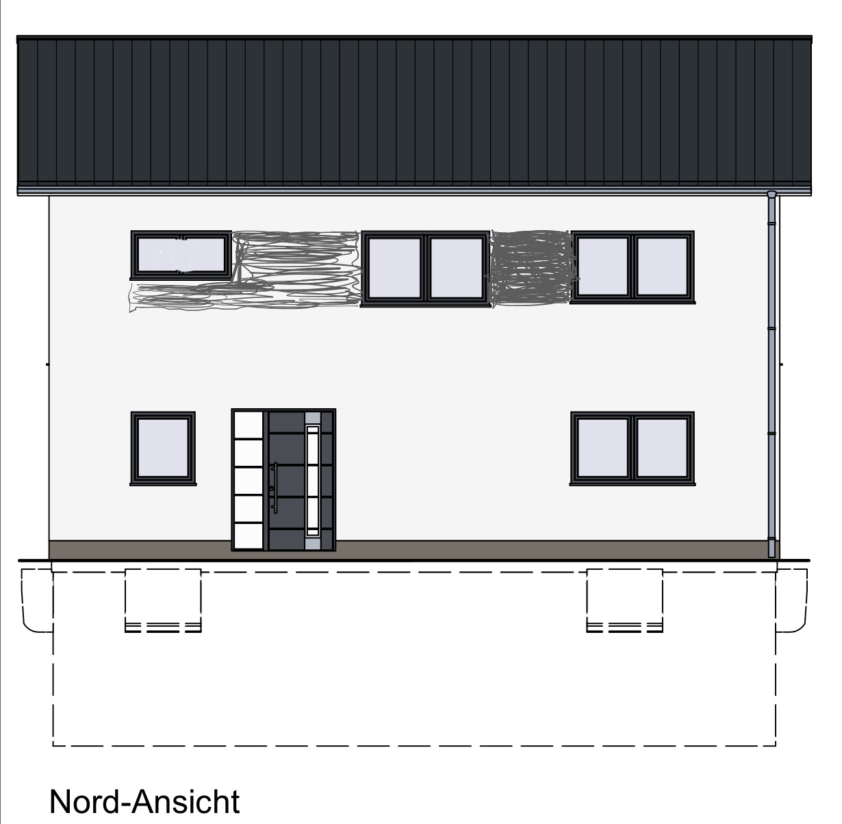

I really don’t understand the windows on the front facade; I’d rearrange them including the bathroom window and the ground floor windows. But I don’t currently have an overview of what is possible. Personally, I would spend more than an hour thinking about this. Draw, take a photo; draw, take a photo; and finally compare the photos.
I agree that the windows on the front facade are not ideal. In my opinion, there are too many different window types on the upper floor, which makes it look a bit chaotic to me. Here is another alternative: I made the window in the stairwell as large as the one in the bathroom. Previously, it was as small as the one on the bottom left next to the front door. With a bit of color, it should look very elegant. What do you think?
