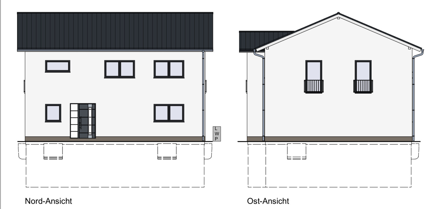

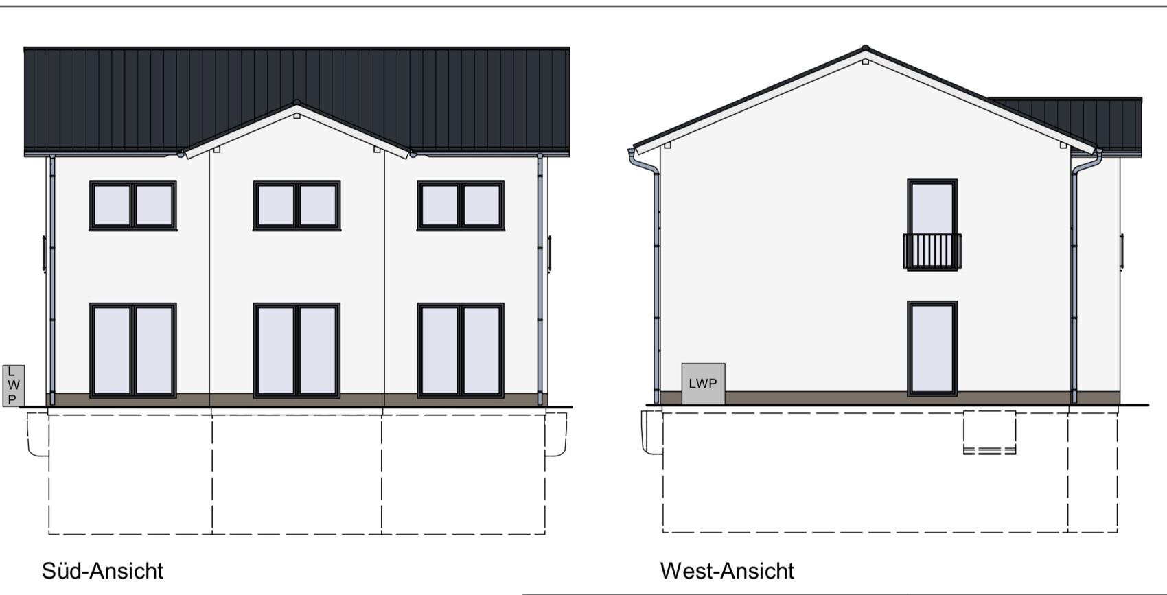

Can the staircase be placed further away from the entrance? What do you think about making windows in the bathroom, master bedroom, and office narrower (window sill height)? Are the basement windows well positioned, especially those near the terrace?

Could you please take a look at the window sill heights and give some feedback? I didn’t find any mistakes in the sill heights. But please don’t say that I rarely pointed out that arbitrary dimensions lead to poor workmanship and disrupted overlapping dimensions. The designer has little regard for reference dimensions here – and if he does, he probably prefers to apply them to the openings rather than to the walls :-(

Could you add your input as well? Many thanks!We have a finished floor level of 85cm (33 inches) above. I wouldn’t want it any higher than that.Please share the elevations; that could really spark a lively discussion!
