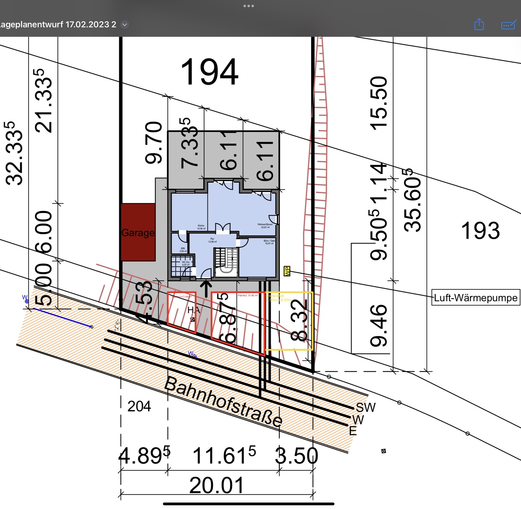

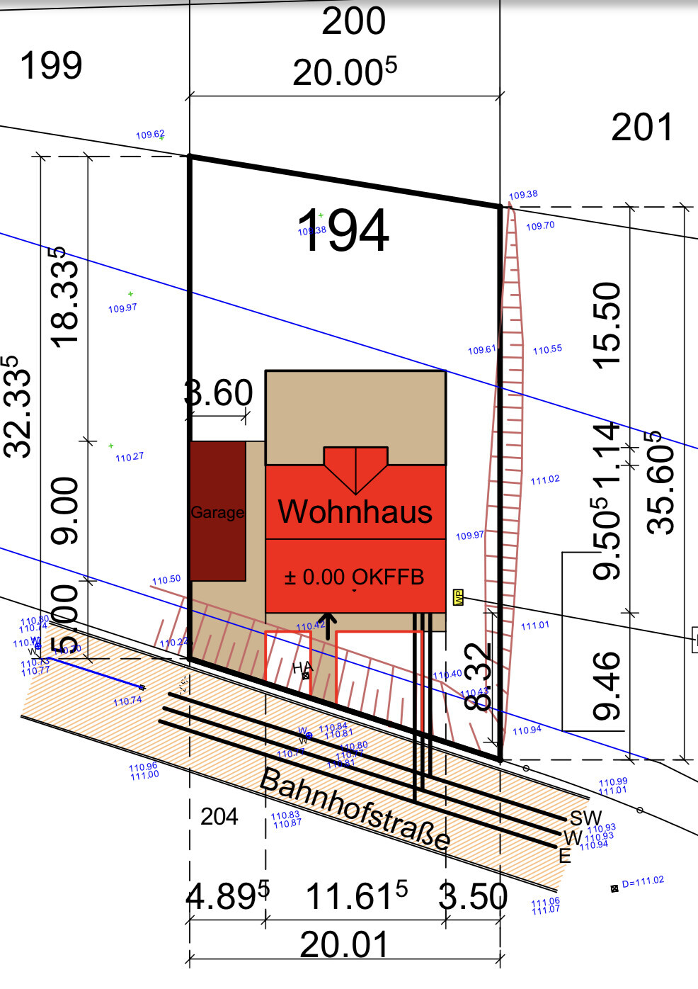

I revised the site plan together with the general contractor. We decided not to attach the garage to the house, as I don't see any benefits without a direct connection. Additionally, the general contractor marked the location of the heat pump. There is now a distance of 2.4m (7 ft 10 in) between the heat pump and the property boundary, which might still allow for some fence removal. The garage is 3.7m (12 ft 2 in) wide, and the gap between the house and garage is about 1.2m (3 ft 11 in).
I’m not completely satisfied with the 2.4m (7 ft 10 in) clearance between the heat pump and the property boundary; I had hoped to achieve at least 2.55m (8 ft 4 in) plus a small buffer. However, I do not want to reduce the pathway between the house and garage any further.
I plan to add an extension behind the garage and will have that added to the plan as well.
Today, I had the floor area ratio calculated, and we are at 275 sqm (2,960 sqft). The allowed limit is about 272 sqm (2,928 sqft), so it's surprising how easily a simple house plus some walkways, a garage, and an extension can push you over the limit. My plot is slightly too small. 😉
I will keep the site plan as is, except for the garage, and approve it for the general contractor. If there are any objections or comments, please let me know.
Thank you!!!
Thank you!!!
hanghaus202322 Feb 2023 11:13If the floor area ratio is not met, I would reduce the terrace in the plan by 0.3 m (1 foot) on the south side.

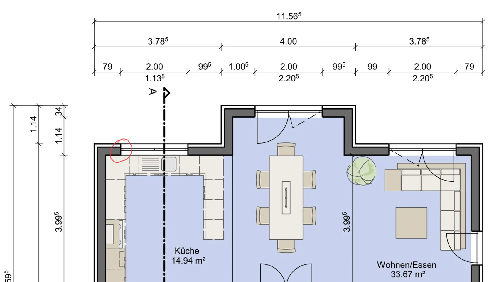

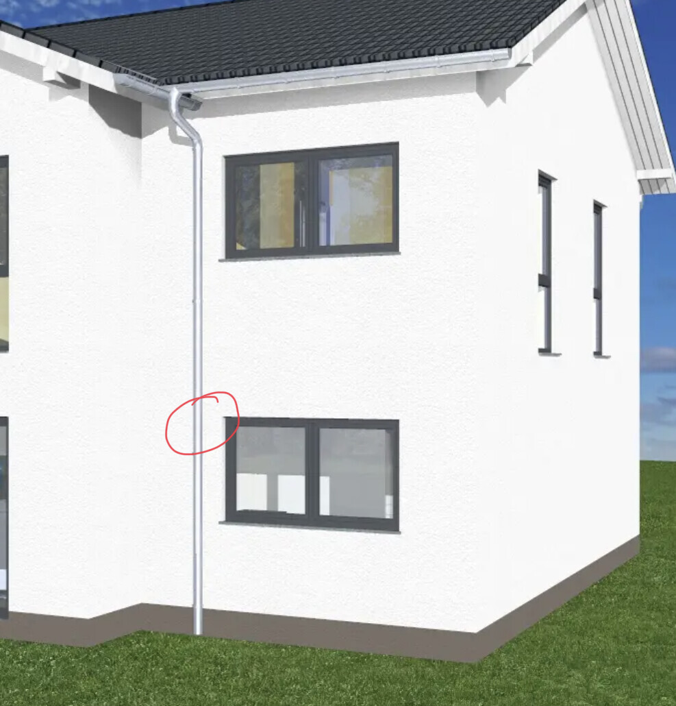

I would like to hear your opinion on the following issue. The kitchen window is very close to the wall, as indicated by the circle in the ground floor plan. The window slightly overlaps with the kitchen island. I don’t think it can be moved further because the sewage pipe on the exterior wall is quite close to the window.
How serious do you think this is?
