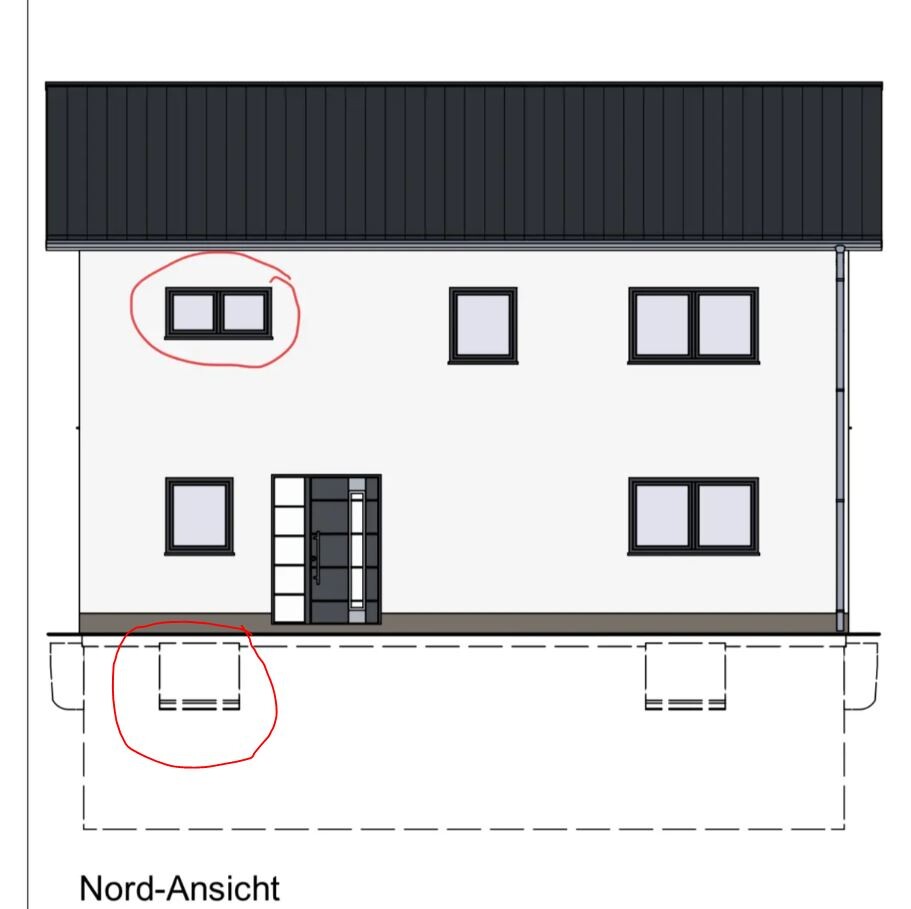

Now stop going through countless more facade design variations. That just leads to getting even more uncertain about whether it’s really the very best one. You’re overlooking, like the saying goes, the forest for the trees—the left light well grate is very close to the front door.Thanks for your feedback. You’re probably right that I should just put a checkmark behind it.
Regarding the basement window: Did you look at the correct basement window? To me, the basement window is quite close to the door but not too close. See also the picture below.

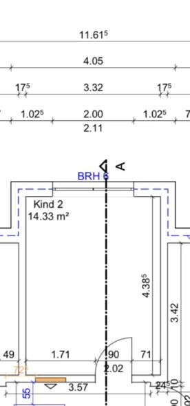

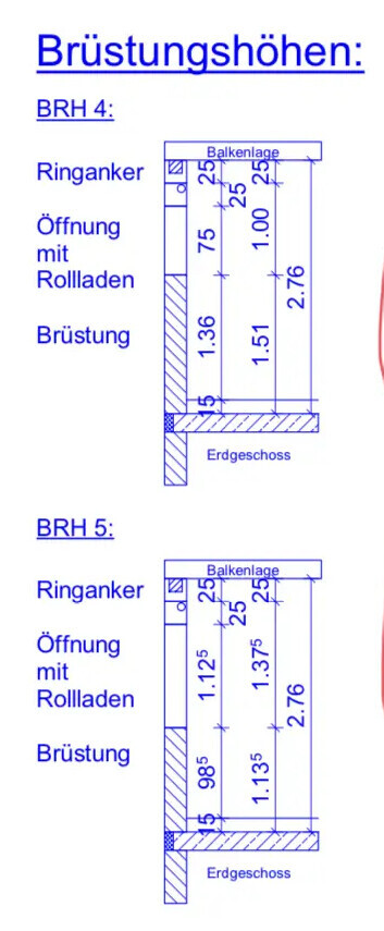

@Gregor_K … The parapet height 5 comes from your draft plans. The windows on the upper floor are labeled with parapet heights from 4 to 6, and the legend explains what each of those means.
I wouldn’t choose any floor-to-ceiling windows in the rooms on the upper floor at all. Especially in children’s rooms, here particularly in Child 2, there will often be furniture placed in front of these windows, and that’s also visible from outside.
Better to have wider windows with a parapet height of 80 to 90 cm (31 to 35 inches).Oh, that’s true. I had forgotten about that.
At one point, I even wanted a window 2.5 meters (8 feet) wide in Children’s Room 2, but I quickly realized that was nonsense! The window in Children’s Room 2 is 2 meters (6.5 feet) wide, and there is about 65 cm (26 inches) of space to the wall on each side. That should be enough for normal furniture, right?

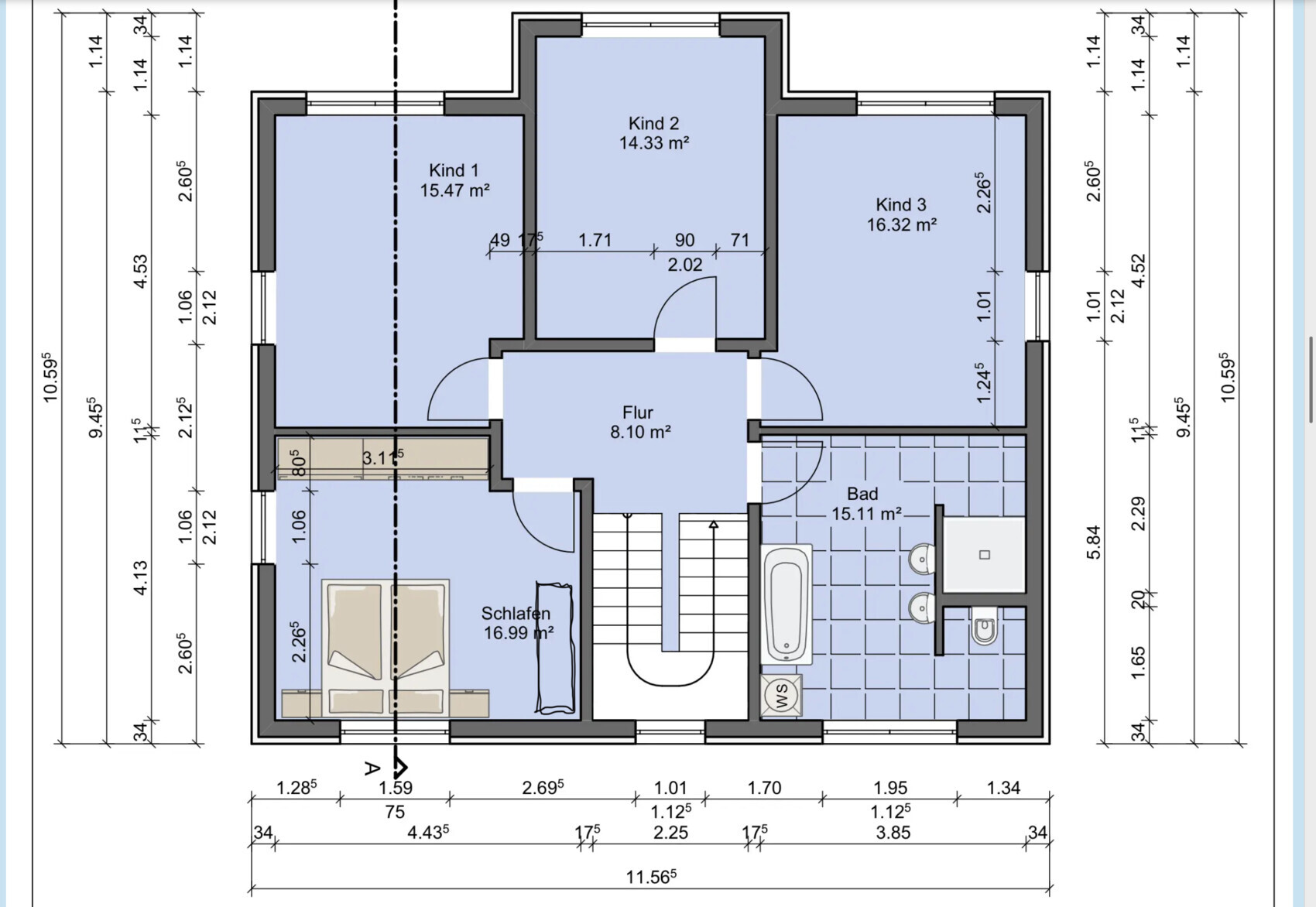

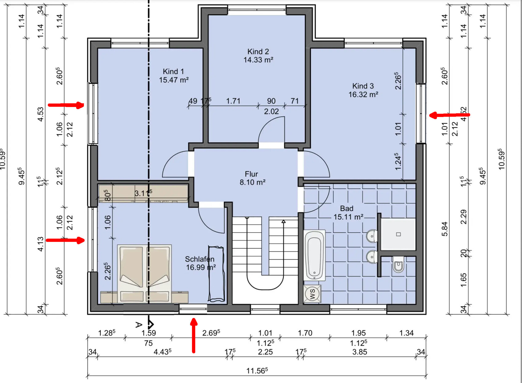

Honestly, I don’t know how you imagine the windows in the bedrooms. There is supposed to be a dresser on the right side when looking at the floor plan from below.
Gregor_K schrieb:
Regarding the basement window: Did you look at the correct basement window? My comment obviously referred to the illustration in post #112 – I couldn’t have known that you would reconsider it again in post #115. If the confusion among your construction workers is even half as bad, then good luck...
My comment logically referred to the illustration in post #112 – I couldn’t have guessed that you had already reconsidered it again in post #115. If the confusion among your builders is even half as bad, then good luck...That was just a sample window from an almost identical floor plan but a different house in post #112. Sorry if I caused any confusion here.
kbt09 schrieb:
Try sketching the intended furniture layout in the bedroom first, and then we can place the windows.The plan was for the furniture to be arranged as shown below. A dresser will be placed to the right of the bed. If you have a better idea, feel free to share it.
