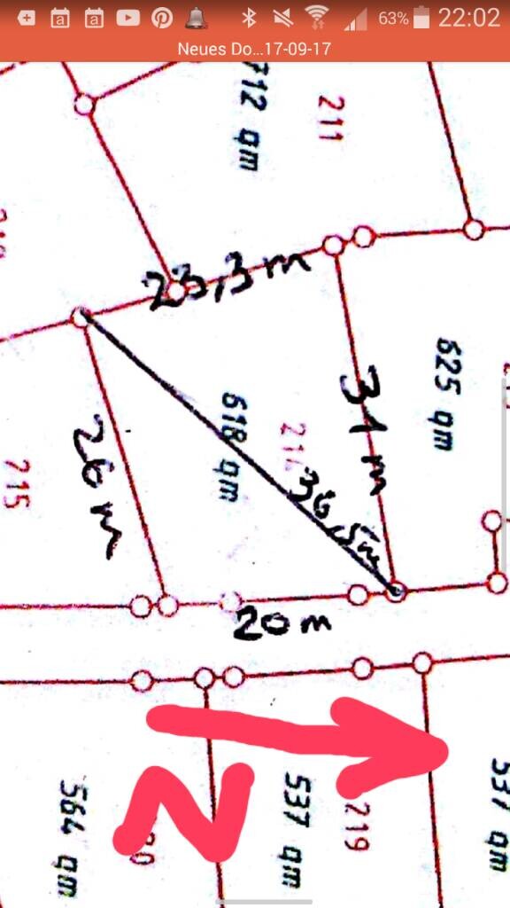

I rotated the general contractor’s plan 90° to the left, as well as the site plan:
This is how the floor plan views, for example in post 166 (direct linking no longer works @Admin … see the discussion), were created.
The street would be on the east side. And your floor plans would have approximately west at the top.

So the street would be on the east side. And your floor plans would have roughly west at the top.Yes, according to the development plan, the street is on the east, but the plot is not rectangular. The builder’s bungalow is oriented towards the "northern" boundary, so the house’s angle lies to the south. That has been adopted in my case as well.
But it doesn’t really matter: the truth lies somewhere in the middle.
