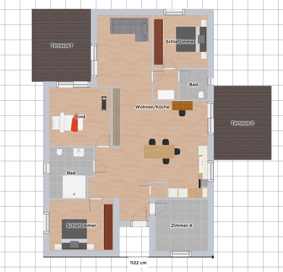

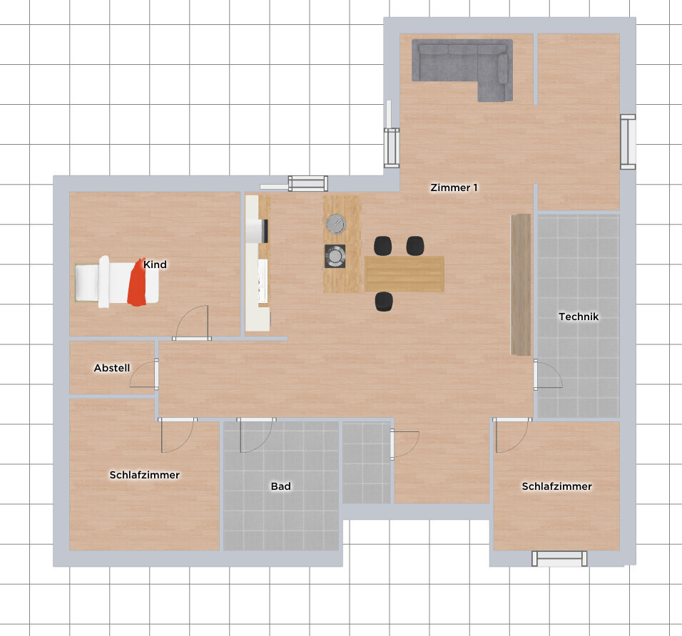

I also have two more suggestions!
By now, I no longer go into much detail – most homeowners have difficulty interpreting sketches, so I use a "quick" program. I have already omitted some windows, as well as example furniture, and so on.
The whole thing doesn’t need to be to scale since I don’t have the exact plot dimensions on hand. Etc.
Does anyone feel like helping me tidy up my storage room???
I don’t even know the size of the second one yet.
The first one is about 135 sqm (1450 sq ft). Here, the bedrooms can be swapped: either the parents want privacy, or the child is bothered – there is a granny flat at the top left of the plan.
Both include a covered entrance so your child can stay dry.
In the second plan, there is a work nook at the top right. By the way, the second one is designed for lovers of L-shaped bungalows.
Overall, everything is open, with wheelchair space almost everywhere. Storage rooms and similar spaces don’t have 1-meter (3.3 ft) wide doors – why should they… if needed, a sliding door will do.
However, there are plenty of clear turning spaces throughout the house.
