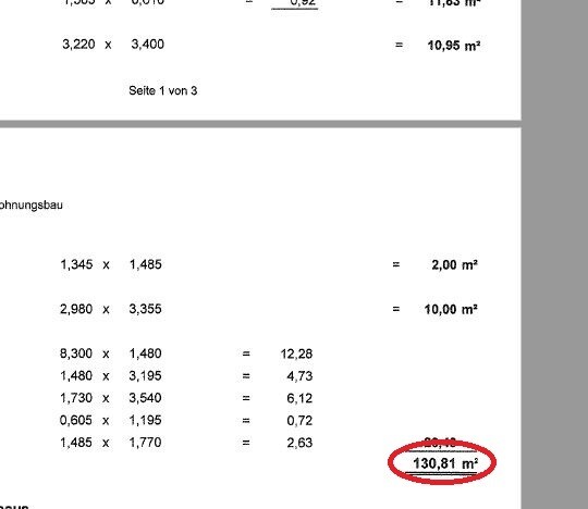

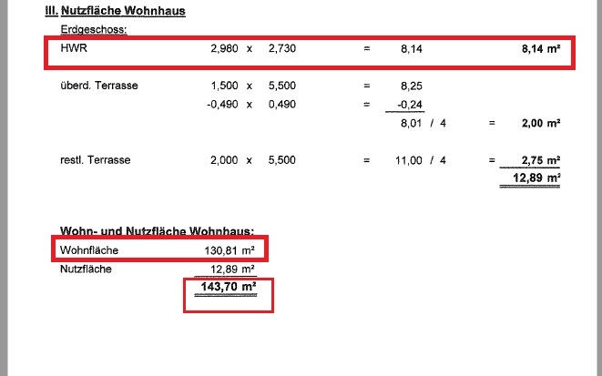

kbt09 schrieb:
@zizzi, you should really know what you’re writing
I don’t count terraces, etc. I know what I’m writing.
First offer with 130.2 m² (1401 ft²) of living space
Then an increase by 2.5 m² (27 ft²)
that makes 132.7 m² (1428 ft²)
In the latest living space calculation I have 130.8 m² (1407 ft²) of living space + 8.14 m² (88 ft²) utility room = 138.94 m² (1495 ft²)
I have left the terrace out.
Now please let’s agree on this living space calculation. My upper limit is 140 m² (1507 ft²), Katal’s house is 131 m² (1410 ft²). So what now, 3 more or 2 less? What is this?!
As proof of what I could gather, you’ll find it attached.
