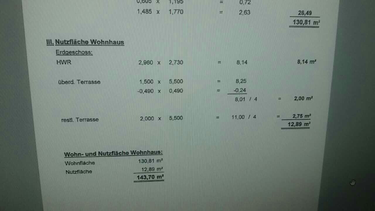

The utility room is, of course, included. When calculating areas, I always use the total area:
I had calculated it from the square meter figures on the floor plan but wasn’t able to read one or two numbers quite correctly.
So far, it was 130, now 132.7 plus the utility room at 8.14 = 141 square meters (1,518 square feet) compared to 127 square meters (1,367 square feet).

So far, it was 130, now 132.7 plus utility room 8.14 = 141 sq m (1,518 sq ft) compared to 127 sq m (1,367 sq ft)The 132.7 sq m (1,428 sq ft) I wrote isn’t correct. You have to be a bit bold [emoji6]130.8 sq m (1,407 sq ft) (living area) + 8.14 sq m (utility room) = 138.94 sq m (1,496 sq ft)
(Based on the living and usable area calculation from BU)

The living area of the planned house was 130 sqm (1,399 sq ft). Now it is 132.7 sqm (1,428 sq ft) @zizzi, we don’t want to argue over a few square meters here. But you should keep in mind what you’re writing.
I prefer to always mention the total floor area remaining after the walls are built, regardless of whether it’s for a utility room, staircase, or bedroom.
I don’t include terraces or similar areas.
