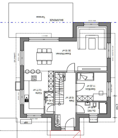

we are approaching the final stage of the floor plan design and thought someone might take a look and provide some feedback.
What we wanted:
The house should be about 150-160 sqm (1,615-1,722 sq ft). Also, the attic level (according to the old development plan, i.e. the 2/3 rule in BW) must not count as a full story.
We actually like these Nordic-style houses with a central gable and also brick cladding, although we had to give up on the brick cladding because apparently no one here does it, and if they do, it’s incredibly expensive.
The architect advised us against a central bay window facing the garden because that would place one side of the terrace almost facing north.
Otherwise, we wanted a fairly classic layout:
An open living/kitchen/dining area, plus a shower restroom and an office on the ground floor. The attic should have two children’s bedrooms and a master bedroom. If there is space, also a walk-in closet and a large bathroom. I also wanted the knee wall to be as high as possible.
In the current round, the attached floor plans were developed. We only want to make minor adjustments now, so I thought this would be a good time for others to take a look.
There are several proposals for a laundry chute on WhatsApp.
I would appreciate your feedback.

Ground floor:
Grundriss eines Wohnhauses: Diele, Küche, Essen/Wohnen, Büro, Vorrat, Du/WC, Terrasse.

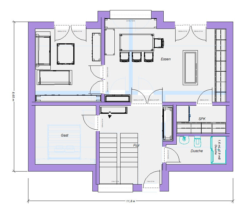

So ... here are my suggestions for improvement:
  • Remove the pantry; it’s 2.42 m² (26 sq ft) for a 100 cm (40 inch) shelf.
  • Then swap the living and kitchen areas. That way, you can plan a wonderful kitchen that offers enough storage space on its own (a 100 cm (40 inch) shelf can easily be replaced by a tall cabinet with a space-saving tower setup). Besides, you still have the basement for larger storage needs.
That said ... looking again carefully ... there is hardly any space for a coat area. So, I think the approach suggested by @K a t j a was better.
Ground floor plan of a single-family house: kitchen, dining area, living room, hallway, stairs, terrace.
Floor plan of a house: living room, dining area, guest room, hallway, stairs, shower.
