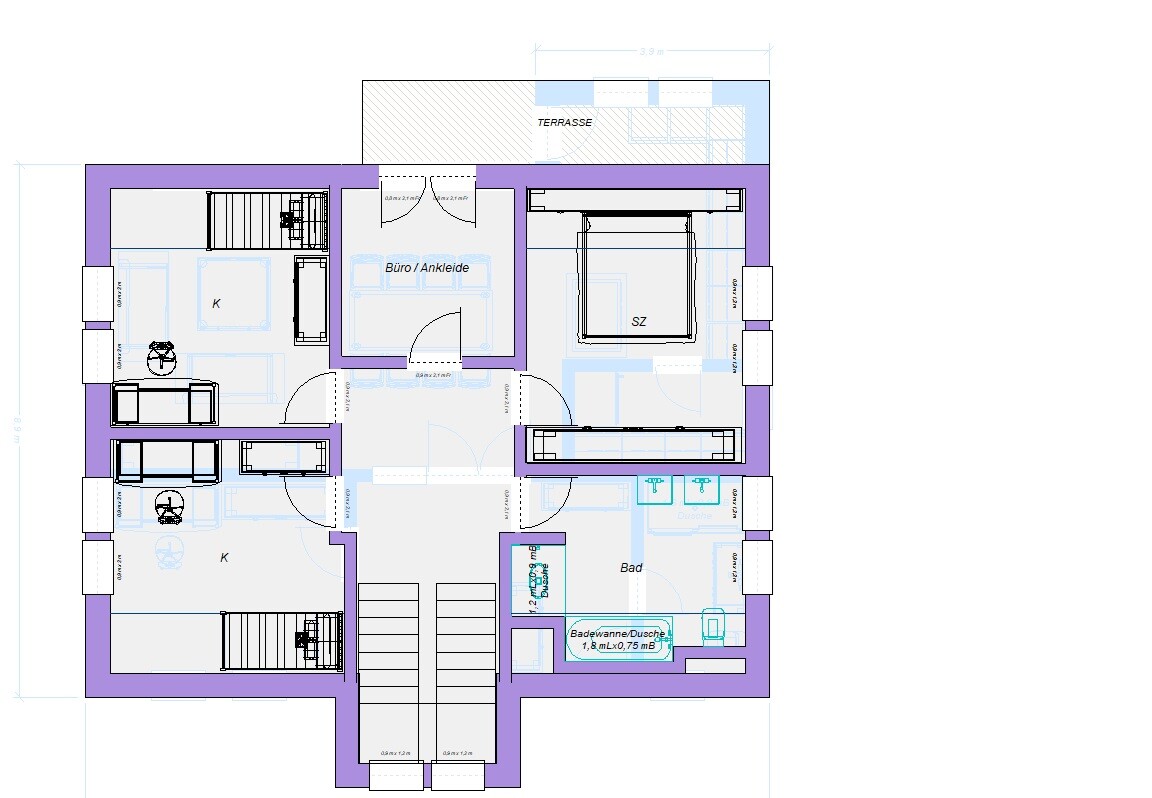

We really liked Katja’s upper floor plan and only want to make minor detail changes (not done yet):
Floor plan of one level: kitchens, office/dressing room, bedroom, bathroom, terrace, central staircase.

11ant9 Dec 2024 19:30
GeraldG schrieb:
We really liked Katja’s upper floor and would only consider minimal changes in detail (which have not been made yet):
However, I would skip moving the balcony on the bay window over.

However, I would not move the balcony on the bay window over, but leave it out.
Yes, the balcony above the bay window will be removed. As far as I know, if the 3 m (10 ft) minimum distance is not met, you are not allowed to build a balcony there.

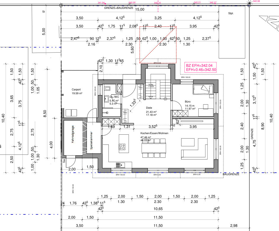

GeraldG
21 Dec 2024 15:56
So,
I took the time to clarify the regulations applicable to us. Contrary to the initial statement from the town hall, although the 1968 Building Use Ordinance and the 1972 State Building Code apply to us, there is a transitional regulation for setback distances that refers to the current State Building Code. Accordingly, we only need to maintain a 2.5m (8 feet) distance from the property boundary, while bay windows (maximum 5m x 1.5m (16 feet x 5 feet) projecting from the wall) only need to keep a 2m (6.5 feet) distance. Boundary structures for garages and carports are limited to a maximum of 9m (30 feet) per side and 25sqm (269 sq ft) of wall surface.
Since the upper floor is quite clear, we are currently only planning the ground floor.
We have agreed on the layout as shown. The plan is from our designer; I only made the last requested changes, so it might look a bit shifted here and there.
The wall between the pantry and the bicycle garage will not be built later. The knee wall with this bay window is actually 1.5m (5 feet) high inside, which is almost full living space.
Floor plan of a house: Ground floor with carport, kitchen, dining, living room, office, hallway.
The hallway is a bit too large and open for my taste, but my wife is looking forward to it. In an emergency, you can of course simply add a wall there and possibly a double door. From my experience with my parents’ house, that door is hardly ever closed. A sideboard or something similar could also fit on the "T-wall" on the right side between the hallway, office, and living room.
