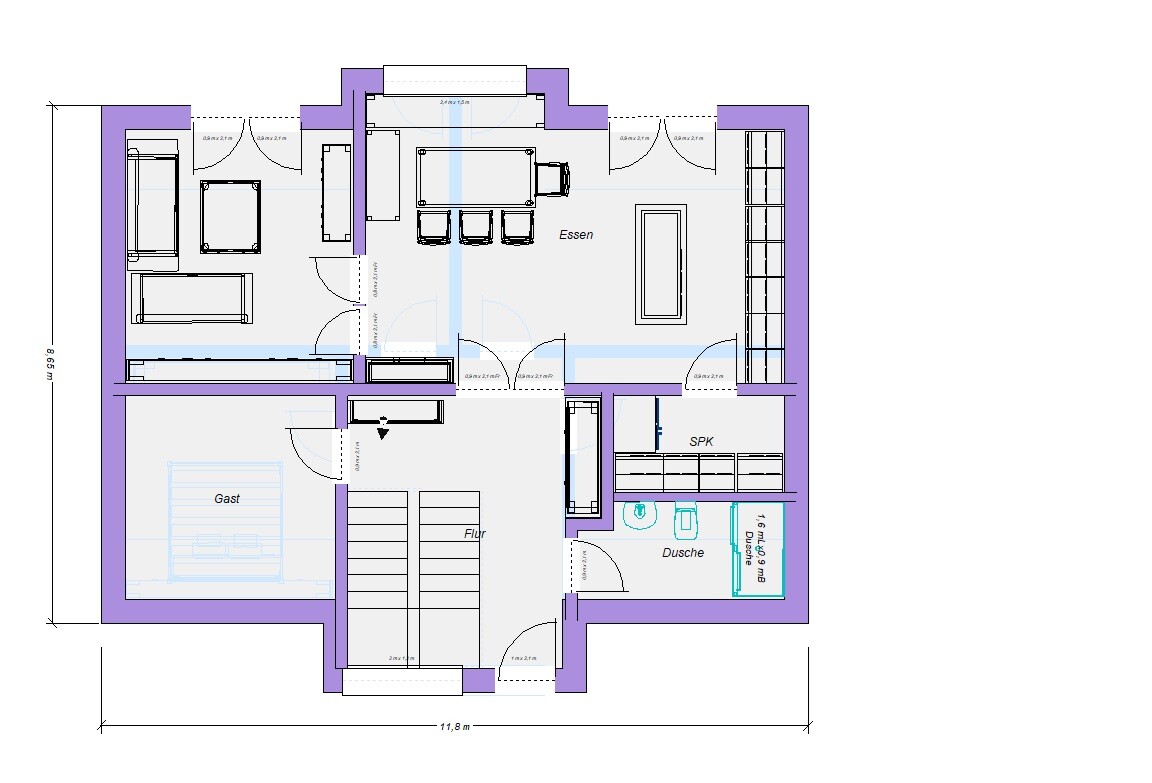

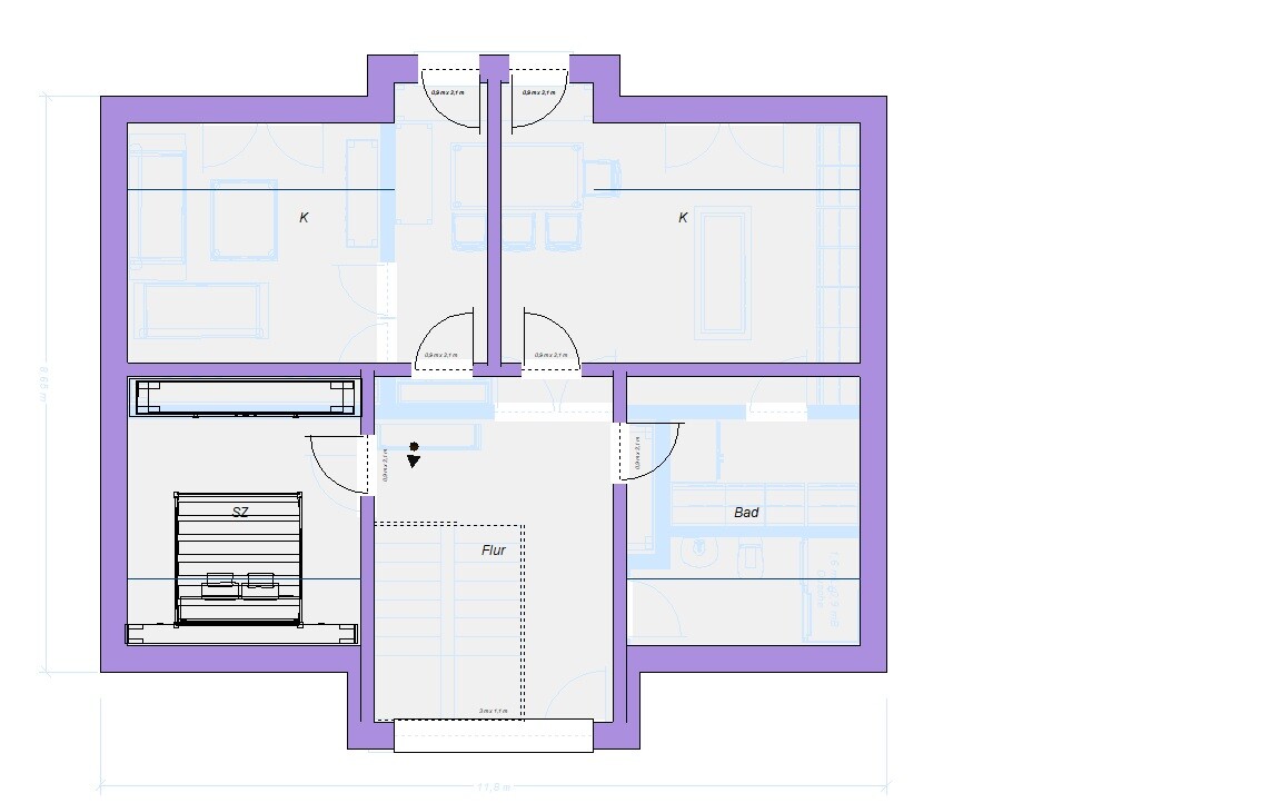

K a t j a27 Nov 2024 22:13
I managed to come up with something like this while experimenting:
2D floor plan of a house with dining area, hallway, guest room, and bathroom
Floor plan of an apartment: hallway with stairs, bathroom, bedroom, and two kitchens (K).
with a large hallway on the upper floor – as far as I know, Scandinavians like this quite a bit. If that’s not Nordic...
What does your wife want? Do you have an example picture?

GeraldG
27 Nov 2024 23:01
However, there were points speaking against the house as it is:
  • Two-story (the town hall rules out that we are allowed that, even though a two-story building was permitted right next to us. We are locally the first in the corner that has to build single-story (the Knödellinie boundary runs in between)).
  • There were too many rooms inside for us; we preferred larger rooms (11sqm (120 sqft) for the children is quite small when they grow older). I would place the home office on the ground floor or in the basement. The children should rather have the nicer view, since we only really sleep in the bedroom. The teenagers (not yet here) will probably spend more time in their rooms.
My wife’s wishes: kitchen on the right side, living room on the left side (from the street view). We only have neighbors on the right, and on the left there is initially no one “in sight” who might build. They should see us cooking rather than relaxing in the living room.
At the same time, we were advised against having the central bay window at the back because of the sun (actually by several companies before we chose the current builder). It splits the terrace. It was then always shifted north so that there is one continuous terrace. This is usually impractical, as the table would actually fit nicely between kitchen and living room there.
My wish (since I am not short) was to get the knee wall quite high. With a 30° roof pitch, it takes a while before you can stand there comfortably.
For the shower, I prefer solutions where you don’t have to clean glass panels so often.
We don’t really need a walk-in closet, but my wife wants one and intends to equip it with wardrobes to store all kinds of bedding and what we currently keep in our closet. It is more like an extended wardrobe plus storage for foldables. She is quite stubborn about that. However, she does not want a separate storage room. My suggestion was to make a children’s bathroom upstairs instead of the walk-in closet (currently we keep all clothes, bedding, rarely worn clothes, etc. in a 2.6m (8.5 ft) long wardrobe), and reduce the ground floor to just one WC so there might be a broom closet next to the pantry, which she also rejected.
She doesn’t like in your proposal that the door is next to the bay window. (I would have even placed it on the side, which would make the entrance less convoluted.) But she would accept that, as it keeps symmetry with the windows on the other side. She is a big fan of the hallway in your proposal. Personally, I am more practical and want it to be as small as possible (without it feeling cramped, of course).
We still need to look at your new proposal more closely. Overall, the house is quite long now (the plot is 18m (59 ft) wide and we have to keep a 3m (10 ft) distance on the right and left), upper floor without walk-in closet or additional storage, but with generous rooms. On the ground floor, the living room and dining room now seem smaller, so my initial tendency (among all proposals) is still towards the first one.
27 Nov 2024 23:31
GeraldG schrieb:
They prefer the children to have the nicer view,
But the children don’t benefit from that. I don’t know any child who enjoys looking at a beautiful landscape or view. As kids in school and playing age, they need brightness; they prefer playing over looking out the window, and later on, as is often mentioned here, the shutters tend to be closed rather than open – even during the day.
More realistic, considering the family’s ceilings and laundry.
GeraldG schrieb:
… so that we can also store all kinds of bed linens and whatever else is currently in our closet there). It’s more like an extended wardrobe plus storage space for foldable items.
However, you shouldn’t forget that you are planning a basement for storage. While the broom should be stored on the ground floor, the mop either there or upstairs, all foldable seasonal and changeover items could go in the basement.
GeraldG schrieb:
She doesn’t like that the door is next to the bay window in your proposal.
The design is more symmetrical than yours. In your layout, the door isn’t centered and is very noticeable next to the bay window, and the windows themselves are not symmetrical either.
