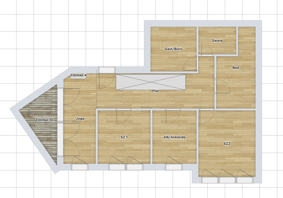

Dear all, I have been following the discussions in this forum for some time and find the feedback on individual questions very helpful. We are building for the first time – with all the knowledge gaps that come with it… ;-)
Our plot is challenging because it is triangular, narrow, and has a requirement of 4m (13 feet) setbacks at the front building line and 20m (66 feet) to the tip. However, the orientation is great, and we have a beautiful distant view. We want to preserve as much garden space as possible and also enjoy an unobstructed view of nature and maximum sunlight – from sunrise to sunset. That’s why we are considering a partly “floating” living area on the upper floor with a terrace and access to the garden. Direct access from the ground floor to the garden is not a priority for us.
Due to building regulations, a large portion to the east remains undevelopable or possibly usable for outbuildings. Access is intended through this area, which will become the front garden. The house should be wheelchair accessible. The space should be used optimally, with plenty of storage, flexible, multifunctional rooms, and large floor-to-ceiling windows/doors or fixed glazing.
What do you think of our ideas? What weaknesses do you see?
Thanks in advance for any honest criticism and suggestions.

Architect’s plan
Ground floor – entrance, utility rooms, fitness/work/guest room, bathroom & sauna
Upper floor – living, cooking & dining, close to nature, sunny, cozy, “public area,” terrace
Attic – bedrooms, sunny private retreat area, terrace
Garden – ideally visually extended, covered terrace, biotope near the terrace
What do you particularly like?
The open living-dining area on the first floor, the floor-to-ceiling windows, the path of the sun through the living area.
What do you not like?
We feel the room layout could be better, and maybe the same living feeling can be achieved with less square footage.
On the ground floor, only the sauna is shown; shower, sink, and toilet are still missing. The large room for fitness/work/guest use seems a bit oversized.
Preferred heating technology: geothermal probes and photovoltaic panels on the roof
Attachments: site plan, floor plans, exterior view

Sunny_OE schrieb:
We would have a great view from the top floor, which is why we’re considering a three-story design Sunny_OE schrieb:
I think it was a mistake to post the exterior view because it’s misleading. This is just ONE possible design of how it could look. Maybe you should reconsider your priorities—great view versus accessibility.
A “great view” is nice, but you don’t usually spend the whole day sitting by the window. And if you do, you need to think about whether you’ll be able to get upstairs… and for how long. As far as I understand, you would also have a nice view from the living floor?! Are you mostly out walking with the dogs?

Do you have an idea about the WC? Would you keep the door as currently proposed? New idea, new draft… also consider a bit more privacy.
Quick sketch (without knowing the dimensions of the house plan): 154sqm (1660sq ft) including roof terrace, two stories, living room without terrace access due to slope… 450,000€, plus earthworks on slope 50,000€, plus special features like sauna, fireplace 50,000€ + contingency

Do you really want a room larger than 80m2 (860 sq ft) that serves all purposes? Have you ever stood in such a space? …
I would suggest reconsidering whether the floor area could be reduced closer to 160m2 (1,720 sq ft)?
2)
In my opinion, you should openly discuss with the architect whether it’s possible to arrange the rooms and floor area so that the house stays within two levels. I have a certain house design from England in mind.
3)
May I ask how far you are willing to go with this? Is it mainly about the impression of the space, with the kitchen possibly coming from IKEA, sanitary fixtures from a hardware store, …
4)
… The toilets are small compartments in which I, even in my early 30s, wouldn’t feel comfortable. … The doors should be 1m (39 inches) wide, the showers generous in size, and there should be enough maneuvering space inside the bathroom. First of all, many thanks for your thoughts and your friendly introduction. Regarding your comments:
1. I fully agree that the size might be reduced without significant drawbacks. I’m currently trying to picture how this could be done…
At present, we live in an open-plan living/dining/kitchen area of about 65m2 (700 sq ft). So the size is familiar to me. Since it’s only 2.60m (8.5 ft) high and not 5m (16.5 ft), there is no echo. We were planning ceiling heights between 2.80 and 3m (9.2 and 9.8 ft). We definitely want to keep this openness and spaciousness in the living area.
2. This house interests me a lot, and I would be glad if you could find a way to share more details about it.
3. Exactly – mainly, we want a thoughtful, functional, and creative room design. We are very flexible regarding materials and interior furnishings. It’s not about brands but high-quality products. We also have no problem with an IKEA kitchen if paired with fine tableware or an industrial-style floor with a great rug, for example.
4. Obviously, we prioritize living space over the size of the toilets… 😉 But I have taken note of your many points and see that we need to rethink here if accessibility is important to us.
Thanks again, and the reference to that house would be very much appreciated.
