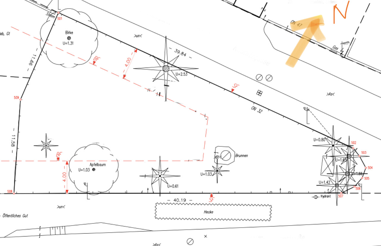

Dear all, I have been following the discussions in this forum for some time and find the feedback on individual questions very helpful. We are building for the first time – with all the knowledge gaps that come with it… ;-)
Our plot is challenging because it is triangular, narrow, and has a requirement of 4m (13 feet) setbacks at the front building line and 20m (66 feet) to the tip. However, the orientation is great, and we have a beautiful distant view. We want to preserve as much garden space as possible and also enjoy an unobstructed view of nature and maximum sunlight – from sunrise to sunset. That’s why we are considering a partly “floating” living area on the upper floor with a terrace and access to the garden. Direct access from the ground floor to the garden is not a priority for us.
Due to building regulations, a large portion to the east remains undevelopable or possibly usable for outbuildings. Access is intended through this area, which will become the front garden. The house should be wheelchair accessible. The space should be used optimally, with plenty of storage, flexible, multifunctional rooms, and large floor-to-ceiling windows/doors or fixed glazing.
What do you think of our ideas? What weaknesses do you see?
Thanks in advance for any honest criticism and suggestions.
Development plan
Plot size – 590m2 (6350 sq ft)
Slight slope and southwest orientation
Maximum height – 8m (26 feet)

Where is north located? What orientation does the house or the living room itself have? Is the access from the east–the house or the plot? Does the garage face south or east? The driveway looks like it is on the south side?
The rectangles drawn (buildings?) do not reflect the actual structure. ... In the 3D animation: what is the gray block on the left?
When I look at the design, I don’t see any neighbors! It rather looks like a forest plot in a secluded area... What does the neighboring development look like? Are they allowed or expected to look in, or should the glass be reflective/mirrored?I hope this plan is better now. I have marked the north direction. The other plan was from the surveyor, which also included the existing small house.
The house (living area) is oriented southwest. The entrance to the house is from the east, while access to the plot is from the north. The carport will be located as far as possible at the corner (east) and will also be accessed from the north.
The gray block is the neighbor’s house. Currently, it is a bungalow, and the animation shows the maximum height the house could reach if the building regulations are fully utilized.
