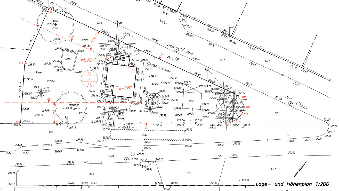

Our plot is challenging because it is triangular, narrow, and has a requirement of 4m (13 feet) setbacks at the front building line and 20m (66 feet) to the tip. However, the orientation is great, and we have a beautiful distant view. We want to preserve as much garden space as possible and also enjoy an unobstructed view of nature and maximum sunlight – from sunrise to sunset. That’s why we are considering a partly “floating” living area on the upper floor with a terrace and access to the garden. Direct access from the ground floor to the garden is not a priority for us.
Due to building regulations, a large portion to the east remains undevelopable or possibly usable for outbuildings. Access is intended through this area, which will become the front garden. The house should be wheelchair accessible. The space should be used optimally, with plenty of storage, flexible, multifunctional rooms, and large floor-to-ceiling windows/doors or fixed glazing.

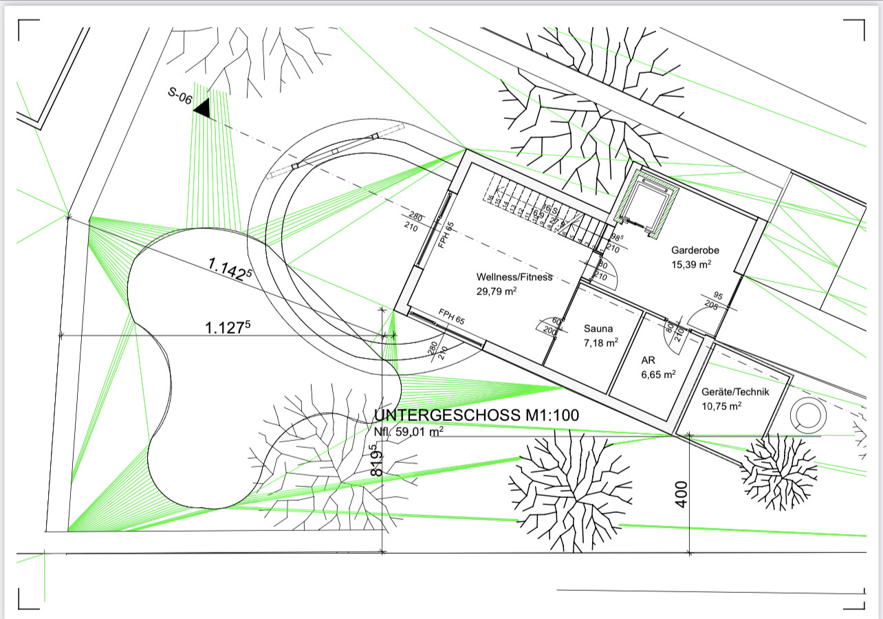

Ground floor – entrance, utility rooms, fitness/work/guest room, bathroom & sauna

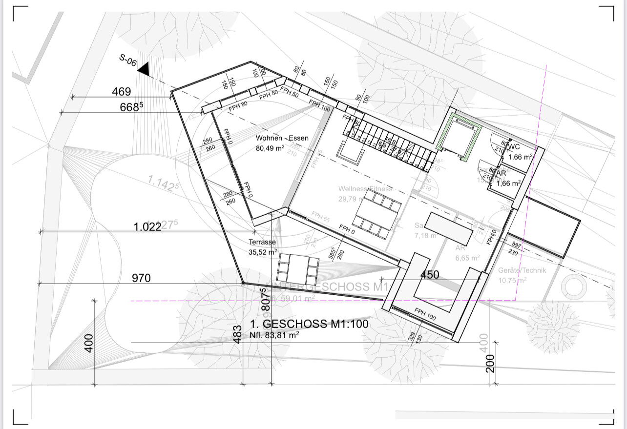

Upper floor – living, cooking & dining, close to nature, sunny, cozy, “public area,” terrace

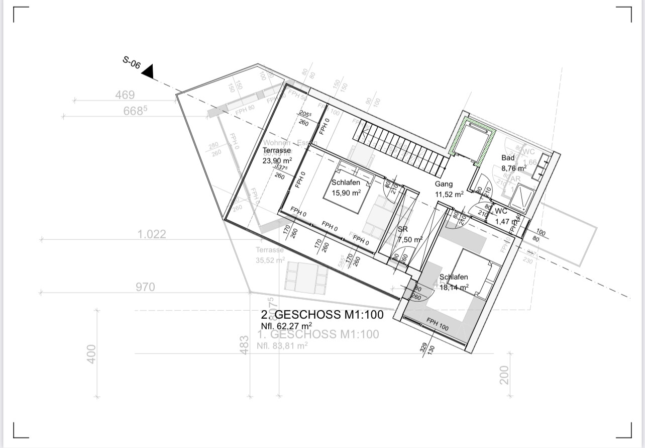

Attic – bedrooms, sunny private retreat area, terrace

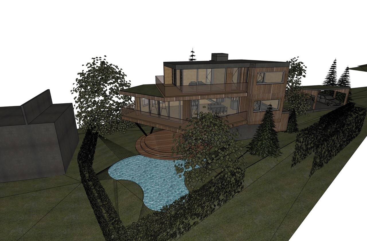

The open living-dining area on the first floor, the floor-to-ceiling windows, the path of the sun through the living area.

We feel the room layout could be better, and maybe the same living feeling can be achieved with less square footage.
On the ground floor, only the sauna is shown; shower, sink, and toilet are still missing. The large room for fitness/work/guest use seems a bit oversized.

A cost-saving measure for me would be to omit the recess at the lower right of the plan. …
Then place the kitchen cabinets (tall units) along the right-hand wall of the plan (since there are no windows there) and rotate the island by 90 degrees. …
And definitely, I would add a toilet below the sauna area. Thank you for your helpful feedback, Silke. I’m not really sure if the bay windows are worth the extra cost anyway, and this seems like a good practical way to reduce expenses. I will discuss this with the architect.
We planned the island’s orientation also as a visual barrier and bar when guests visit, so they don’t immediately see a messy kitchen… 😉 But maybe it could be angled around the corner. I need to rethink the tall cabinets in relation to the windows, thanks to @kbt09 for that. 🙂
As for the sauna, the shower, hand basin, and toilet are not yet shown, and overall I’m still not satisfied with this floor plan. So far, I haven’t had the breakthrough idea and I’m happy to receive suggestions.

The sauna’s plans don’t yet include the shower, hand basin, or toilet, and overall I’m still not happy with this level. So far, I haven’t come up with a great idea and would appreciate suggestions. As I mentioned before, a standalone island is not an effective privacy screen.
I would position the sauna closer to the window and install a glass door, so you can look out onto the garden. What else are you planning to include in the wellness room?

First of all, this is by far the most interesting and beautiful house here for a long time.
A “wow” for the design, which I won’t judge further in detail since I’m not an expert in floor plans.
Then there’s the mentioned age of the client: “in the prime of life.”
What exactly that means has been on my mind the whole time. Presumably, it’s always the present moment when someone is in their prime – right?
The writing style, the mention of yoga, etc., lead me to assume that both are very calm internally, grounded in life, and professionally at least above average in success. Because even if the budget for the house is kept (which, given the existing creative potential, is not out of the question), with additional construction costs, pool, landscaping, and land, the seven-figure mark is almost certainly reached or probably significantly exceeded. Also, please don’t forget the ongoing costs, especially regarding the pool and elevator… But from now on, I would leave the budget topic entirely to the clients. I trust both to keep an eye on it! Also, the planner is an architect (not an architect in the male form).
I wish you much success and look forward to more (detailed) pictures and nice progress updates.

If you build such a house and only have 18 or 15 sqm (194 or 161 sq.ft) left for the bedrooms, that’s too little. Much too small. I would build bigger.Was that a question? The first point matters. Not the size.If you have more money, you can go bigger as well.

A large part of the eastern side is undevelopable or maybe usable for outbuildings. The entrance is supposed to be through this area.Where is north? What is the exact orientation of the house and the living room? Does the access from the east mean the house or the lot? Does the garage face south or east? The driveway looks as if it’s on the south side. My question about the street location…

Regarding the floor plan:
An entrance hall over 15 sqm (161 sq.ft), sauna without plants, rest area in the middle of files… this has already been mentioned.
The kitchen is a real challenge. If the planned enlargement of the upper floor bathroom goes ahead, people will likely avoid the toilet because there would be a direct view axis to the kitchen.
The living/dining area is huge. Do you actually want that? Fireplace… why is it there without a chimney?
And Katja already pointed out: excessively long corridors for two people… you won’t even get to the door before the gardener is gone… better have a video phone for communication.
If the bedrooms are only used by one person each, they could also be used as offices or downsized. Or move the sauna upstairs.
Or put both bedrooms with bathroom and sauna in the basement, and have a guest area on the ground floor… I would try to reduce the number of floors.
Shortening the dining area by about 3 meters (10 ft), so there is still nice space upstairs, would be possible, but there would still be three floors… definitely at least one too many for two “best ager” occupants.
