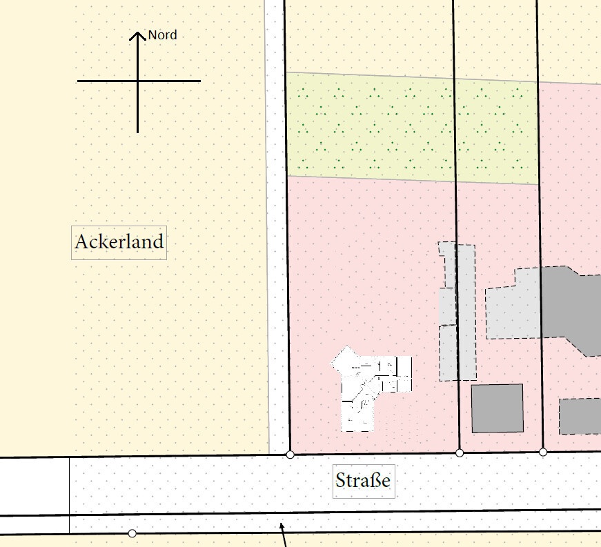

And here are the details:
Development Plan/Restrictions
Plot size: 2000 sqm (approximately 0.5 acres)
Slope: no
Floor area ratio (FAR): 0.3
Site coverage ratio (SCR): 0.3
Building envelope, building line, and boundary: everything marked in red
Edge development: no
Number of floors: 1
Roof type: gable roof
Style: bungalow
Orientation: north
Maximum heights/limits: 8 m (26 ft)
Additional requirements
Homeowner Requirements
Number of occupants: 4 (including two toddlers)
Space needed on ground floor: approx. 160 sqm (approximately 1,720 sq ft)
Office: family use
Open or closed floor plan: open
Traditional or modern construction style
Open kitchen with island
Number of dining seats: 8
Fireplace: yes
Music/stereo wall
Balcony, roof terrace: terrace
Garage, carport: carport for two cars
Design by: do-it-yourself
What is especially liked? Why?: large and open living/dining area
Personal budget for house, including fittings: 500,000
Preferred heating system: gas condensing boiler
Slope: no
Number of floors: 1
Style: bungalow
Orientation: north
Office: family use
Fireplace: yes
Music/stereo wall
@ypg:
Sorry, I thought .pdf was quite common and the best format for something like this.
Could you maybe explain again about the utility room/storage area and the issues?
The second shower is off the table because our experience is simply different, but fortunately everyone can decide that for themselves.
A walk-in closet with a window is definitely something to consider.
