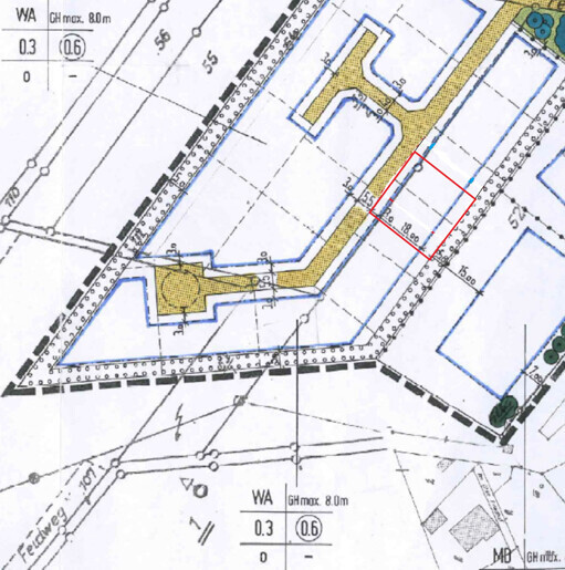

I want to try again to provide you with the information you need. We would really appreciate further comments and your suggestions.
I have now extracted the attached information from the zoning plan; this is all I could get from it.
What other information do you still need?

As I said, there is not enough information. The crucial questions remain unanswered, which are:
- Budget: Roughly estimating, you have 160sqm (1,722 sq ft) x 3000 = 480K. For the basement with sauna, toilet, and extras, estimated 80sqm (861 sq ft) x 1500 = 120K (probably more), so we’re at 600K for the house alone. You haven’t included the exterior work yet, which you can’t skip on a slope. Not to mention a garage or carport. So I’d easily add another 100K. Plus a bit extra for upgrades, kitchen, connections, fees – 50K. All of this is on the conservative side – still, that brings us to 750K. Is that roughly your planned budget?
What’s missing:
- Setback rules for outbuildings – also towards the street
- Reference point for ridge height
- The depth of the plot is unclear as well. You haven’t marked where it begins. Do the 5.50m (18 ft) and 4.39m (14 ft) count in?
- The floor plan sketch contains errors that a professional architect would never make. That’s quite unrealistic. The exterior walls look far too thin. Roof slopes are not considered.
So far, it seems you prefer not to engage much with your plot and the possibilities. That is fine – a good professional will advise you accordingly, and if you are happy with that, all good. However, as the client, you are ultimately responsible for your own outcome. If something is built poorly because you approved the plans, then that’s your misfortune. Therefore, a minimum level of skepticism is healthy.
With the current information, we can’t really start a proper discussion because it is too contradictory. But once you get the plans back from your architect, you will surely have something to show. Ideally, you will need sections, elevations, site plan, and floor plan with actual wall thicknesses and heights. Then we will be happy to support you.
