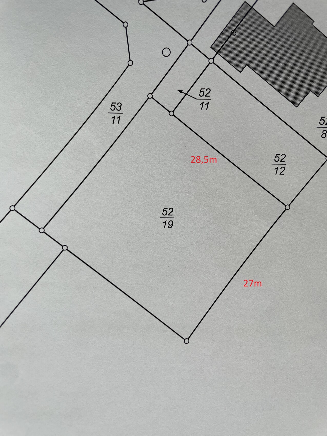

- The depth of the plot is unclear. You haven’t indicated where it starts. Do the 5.50m (18 ft) and 4.39m (14 ft) add on?

Plot depth: see attachment. The plots have since been merged. 27 x 28.5m (89 x 94 ft).
