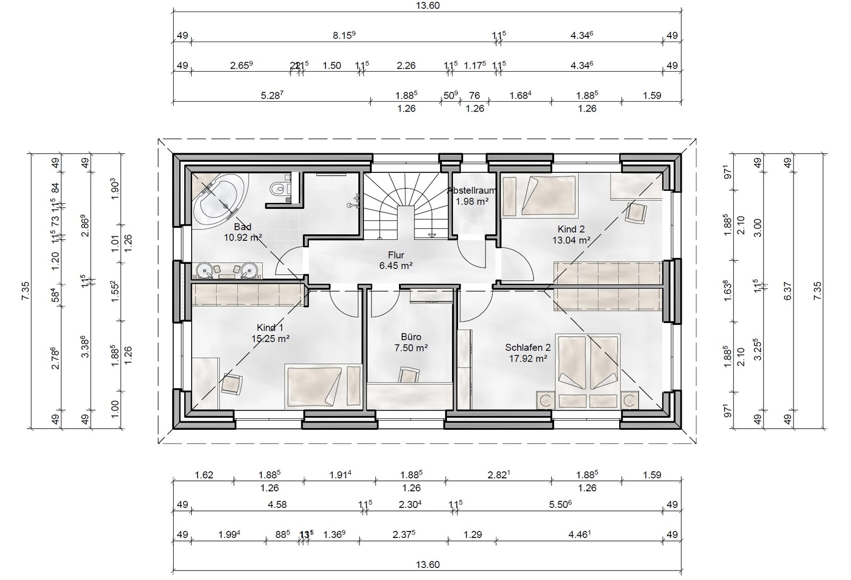

Upper floor plan with bedroom, two children’s rooms, bathroom, hallway, and office

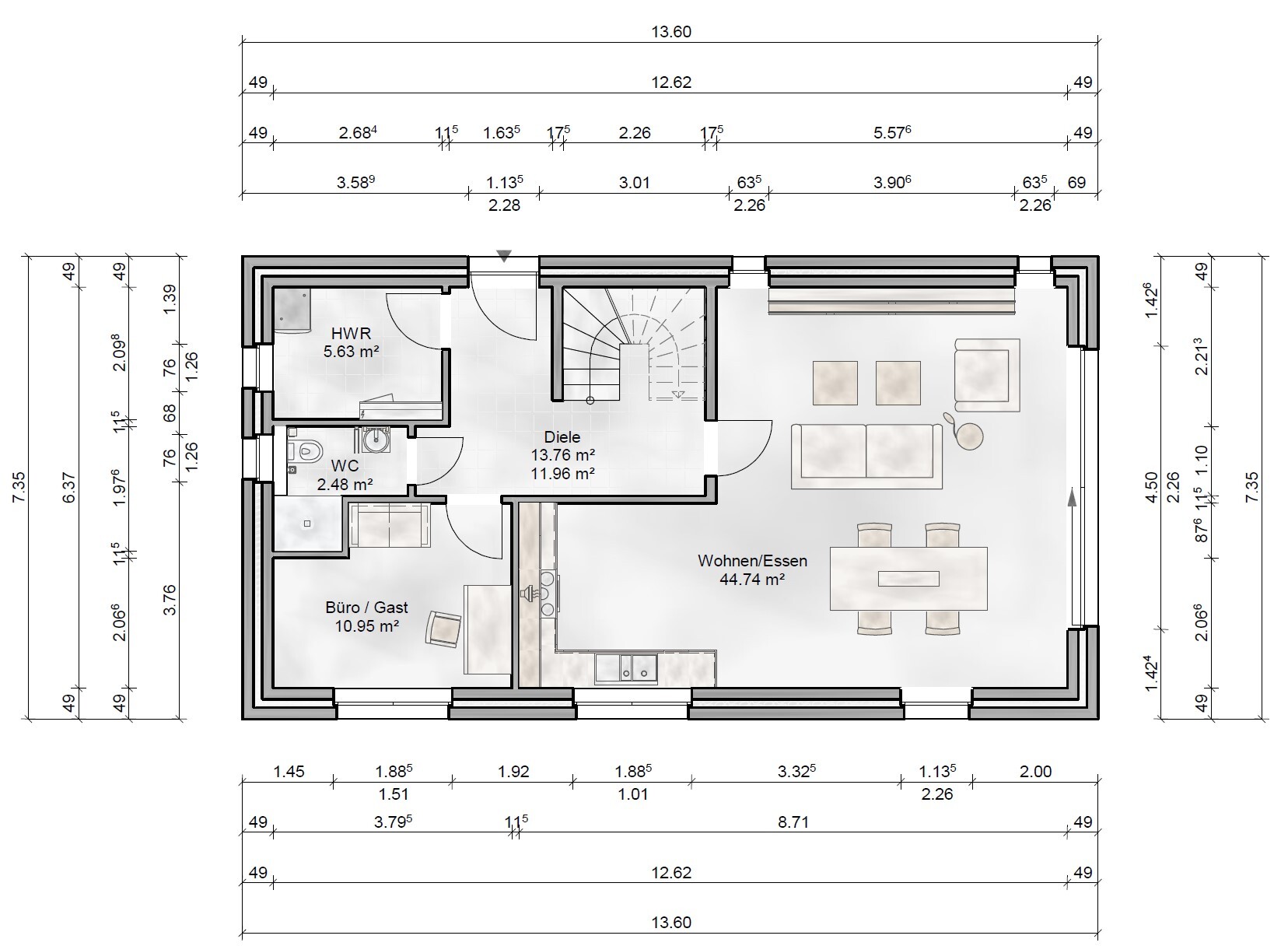

Floor plan of a house with entrance hall, kitchen, living area, and office/hobby room plus WC

From my own experience: as I already mentioned, it’s really annoying in daily life to go from the kitchen to the dining room like that.
The dirty area is exactly by the guest toilet.
The basement hobby room is really cramped. The corner upstairs for guests is also quite tight. Do you usually have just individual guests, or sometimes a couple as well?
The experts can comment on the rest :-)

Topic layout office/hobby room, utility room, toilet, kitchen on the ground floor:
As @Gerddieter, @Papierturm, and @Joedreck have pointed out, this area still offers quite a bit of potential for optimization and is currently causing me the most headaches. Thanks also here for the tip regarding shell dimensions and enough allowance in width!
Walking route kitchen-dining area:
We are still not satisfied with the current situation here.
We could of course shorten this important walking route with a door between the kitchen and dining area.
We would definitely prefer that over a fully open kitchen.

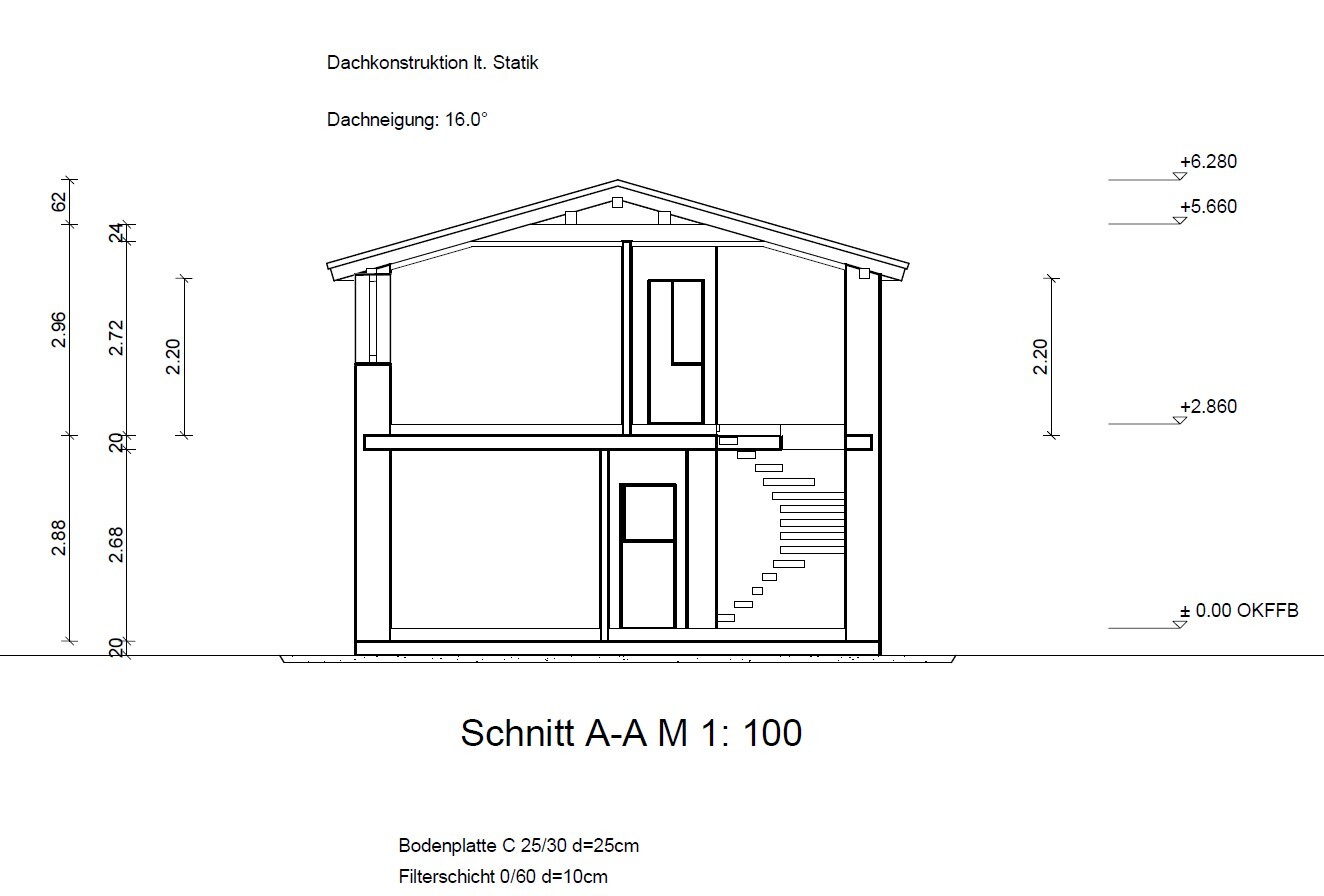

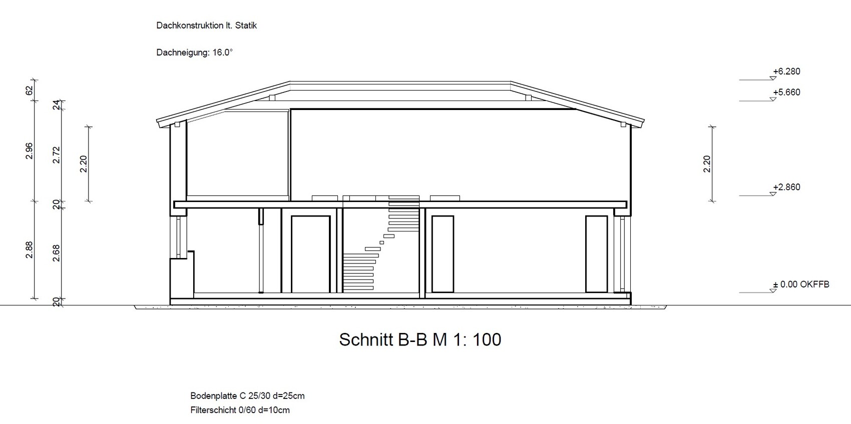

Thanks for the hint, @kbt09, with a knee wall of approximately less than 1.70 m (5.6 ft) above finished floor level, the shower really doesn’t make sense there.
Unfortunately, a second full floor is prohibited by the development plan (see post #1). With each degree less roof pitch, the rising knee wall offers more flexibility. Therefore, I am currently considering lowering the roof pitch from 35° to 30° and raising the knee wall further.

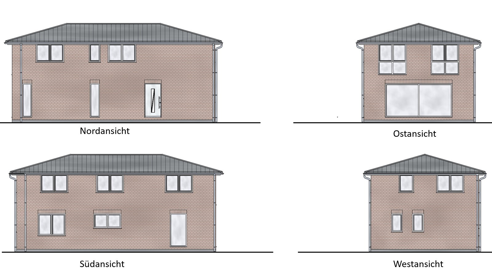

Windows:
So far, we have been very focused on optimizing the room layout, so the windows have hardly been considered.
As @11ant described, the result resembles Frankenstein quite well 😀
This definitely needs attention.
Size of utility room:
Compared to the original design (I will post this in the next message), we have increased the utility room by 1.25 m² (13.5 sq ft).
We are currently planning without a dryer and ventilation system. I will clarify soon with our general contractor whether the space is still sufficient.

The bed shown in the office/guest room in the attic is meant to symbolize a sofa bed that can then be extended to double the size if needed.

  • minimal "wasted" hallway/circulation space in the attic
  • utility room instead of a WC in the muddy area near the entrance door
  • less complicated room layout
  • few issues with sloping ceilings due to the 2.20 m (7 ft 3 in) knee wall and the 16° hipped roof
What we liked less
  • limited space in the cloakroom area
  • impractical, nearly square shape of the living room
  • utility room (still) smaller than currently
  • attic office too small for a (double) guest bed
  • bedroom wall shared with the children’s room
  • open kitchen
  • very little storage space

Four views of a two-story brick house with gable roof: north, east, south and west

Honestly, the facade layout reminds me of Dr. Frankenstein’s work, which bothers me.
That’s a suggested clinker brick look, and it can certainly turn out to be a stylish brick facade. The windows could be adjusted a bit.

Excerpt from the Hamburg Building Code, Section 2:
(6) Storeys above ground are those whose ceiling upper edges protrude on average more than 1.40 m (4 ft 7 in) above ground level; otherwise, they are basement storeys. Full storeys are those whose ceiling upper edge protrudes on average more than 1.40 m (4 ft 7 in) above ground level and have a clear height of at least 2.3 m (7 ft 7 in). The top storey and storeys within the roof space count as full storeys if they meet this height over at least two-thirds of the floor area of the storey below.
With the 2.30 m (7 ft 7 in) height line drawn here, the upper floor qualifies as a full storey, which is not permitted according to the development plan.

In my opinion, there are too many complicated layouts here. The entrance to the ground floor office is a joke and just a disguised corridor extension. The office on the upper floor promises more than it can deliver: the bed niche is not suitable for adults.
Papierturm schrieb:
I would rather plan 2.05 m (6 ft 9 in).
5 cm (2 inches) is still too little for plaster and baseboards.
Papierturm schrieb:
If you want to plan it as a closed room, I would optimize the path a bit.
I would agree.
Papierturm schrieb:
3. The utility room seems very small to me. Are you sure everything that needs to fit in there will fit?
It’s definitely very small. Laundry will have to be done there after all.
Overall, it does not convince me.
- Under the staircase there could be a nice usable room.
- A 120 cm (47 inches) coat rack wall won’t be enough for four people.
- The shower on the ground floor is only about 75 x 75 cm (30 x 30 inches).
- Children’s rooms are better located on a southwest side.
- The bedroom is large but has no space for a 3-meter (10 ft) wardrobe.
- The guest room upstairs looks like an afterthought... at best suitable for a bathroom with a predetermined zoning.
- The side windows are 167 cm (66 inches) high. Okay, there’s not much you can do about that with a “maximized knee wall” height, that’s just the disadvantage here. However, with skylights and a lower knee wall, e.g., 150 cm (59 inches), combined with a steeper roof pitch, it might work better. Closets can be planned within the knee walls; you need storage space anyway. Plus, you get a useful attic space that is easier to access.
This width of 7.35 m (24 ft 2 in) is very awkward. Neither one thing nor the other. And vegetarians have deficiencies that need to be compensated for.

The kitchen is definitely not final yet; it clearly needs a cooking peninsula. Please remove the storage room on the upper floor and add that niche to Child 2’s room, so the rooms will actually be almost the same size. This also saves you from the completely unnecessary window in the storage room, since a shelf will need to be placed on the wall opposite the door.
I like the reasonably small office; one window in the bathroom seems too little to me.
We could argue endlessly about the guest room, but I find it completely unnecessary in a house with 140m² (1,507 sq ft). It ultimately becomes a very expensive storage space for stuff that would be better off thrown away. And if you really need it, make it small according to how often guests actually visit. A few times a year, parents can easily stay in a 6m² (65 sq ft) room instead of 15m² (161 sq ft). That way you gain 10m² (108 sq ft) for the kitchen/living area — the space where life actually happens 365 days a year, especially when grandparents come to visit. They’re not going to spend 24/7 locked in the guest room...
If you reduce the size of the guest room and build a cooking peninsula between the dining area and kitchen, adding a second door from the hallway into the kitchen also makes sense. After just two days in the house, you’ll be annoyed that trash, drinks, groceries, etc. have to be carried through the living room to the front door and vice versa. A kitchen should always have the shortest possible connection to the hallway or front door. After all, that’s where you’ll be carrying your groceries for your whole life... usually straight to the fridge.

With the marked 2.30-meter (7.5-foot) height line, the upper floor counts as a full story, which is not permitted according to the development plan.
Unfortunately, I share the skepticism regarding the upper floor not being a full story.
