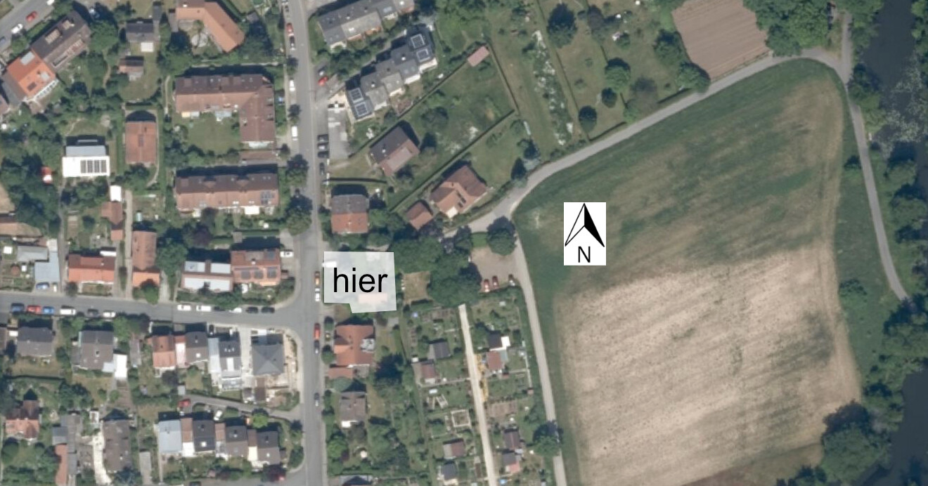

  • The mini site plan was considered too small in some feedback, so attached is an aerial photo which hopefully is clearer.
  • The plot has a slight slope, going downhill towards the east.
  • The east side is the nicest side.
  • The plot measures 550 square meters (5920 square feet) with an 80 square meter (860 square feet) existing building from the 1950s.
  • In front of the large window on the south side, there is a medium-sized tree at the property line (next to the neighbor's garage), which would serve as a privacy screen.

Here is the aerial photo:
Satellitenbild eines Wohngebiets mit Feldern, Häusern und markierter Stelle hier

The mini site plan was regarded as too small in some feedback, so here is an aerial photo attached, hopefully this is better [...] The plot is 550 sqm (5920 sq ft) with an 80 sqm (860 sq ft) existing building from the 1950s.
Unfortunately, you have largely obscured the existing building again. But at least the view is now broader. For estimating heights, however, the aerial photo is rather unsuitable.
