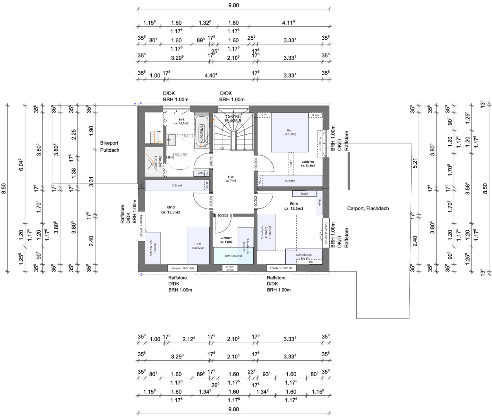

Detailed floor plan of a house: carport, hallway, bathroom, children’s room, bedroom, office
It can happen that the mason takes advantage of his tolerance and the stairwell shifts by 3 cm (1 inch).
Yes, if I start measuring every centimeter, that’s probably a sign there is too little space for what I have planned. What is the acceptable tolerance for construction work in this case?

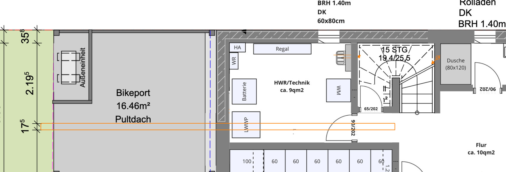

Floor plan: Bikeport 16.46 m² (177 ft²) with mono-pitched roof, utility/technical room 9 m² (97 ft²), hallway and shower.
The 219 cm (7 ft 2 inches) dimension shown on the left does not seem to correspond to any wall. However, it is clear that the staircase is becoming shallower. It currently has a rough depth of about 195 cm (6 ft 5 inches). As a result, the hallway is getting larger but increasingly difficult to furnish; right now, there is only room for a cabinet with a maximum rough depth of 60 cm (2 ft). Cabinets should ideally be planned with a depth of 66 cm (26 inches) to allow some clearance from walls and doors (possibly sliding doors).

The depth of 1.20m (4 feet) in the guest toilet is not sufficient, and the living room depth of less than 4m (13 feet) is also not desirable. The staircase is too steep. If you correct all of that, you will have to reduce the width to avoid increasing the overall size. Voilà, then we are back to option #19.
But if you could also comment on the technical details in the attic peak, we could try an alternative with a small utility or service room.
