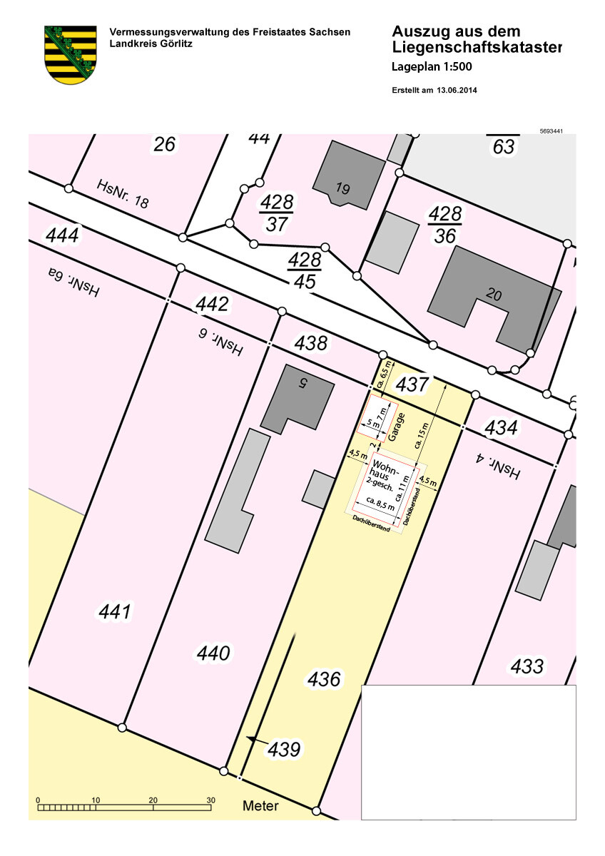

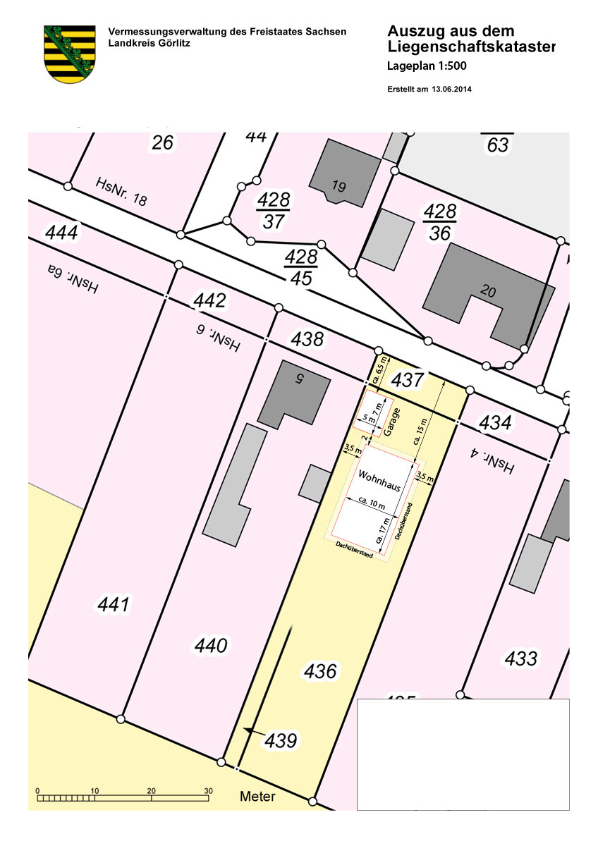

Our two previous drafts (bungalow and so-called town house) fit into the lot as follows:
