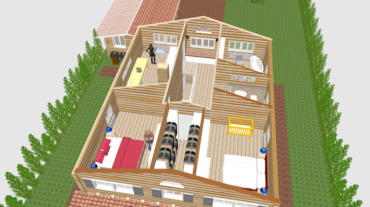

Dear forum members,
I would appreciate it if you could take another look at our house design.
When planning, it’s easy to become blind to issues, so I am looking forward to your feedback. Thank you very much.
The plot measures approximately 17.5 m (57 feet) wide by 72 m (236 feet) long and is located in a rural community.
Here you will find the floor plans and some pictures. Best regards, Steffi33.
Floor plan of a house: open living/dining area, kitchen, study, bathroom, utility room, and hallways.
Floor plan of a house: three bedrooms, combined study/dining area, two bathrooms, hallway, and closets.

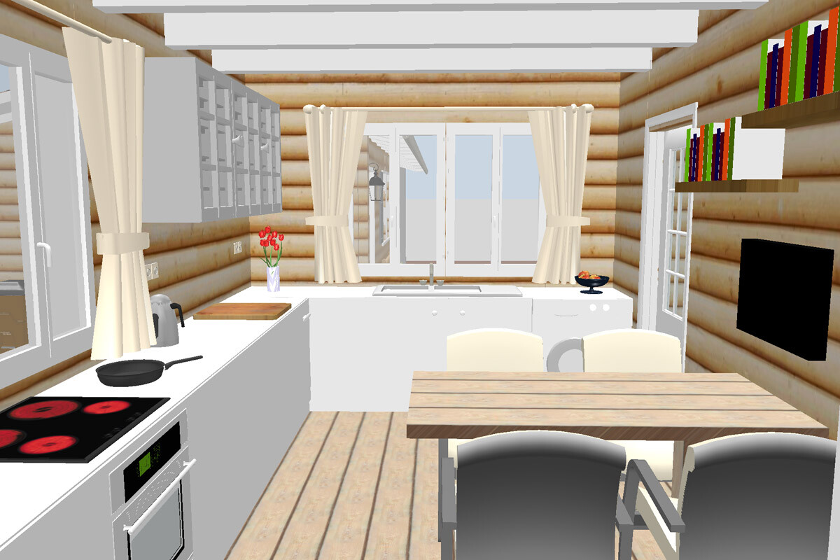

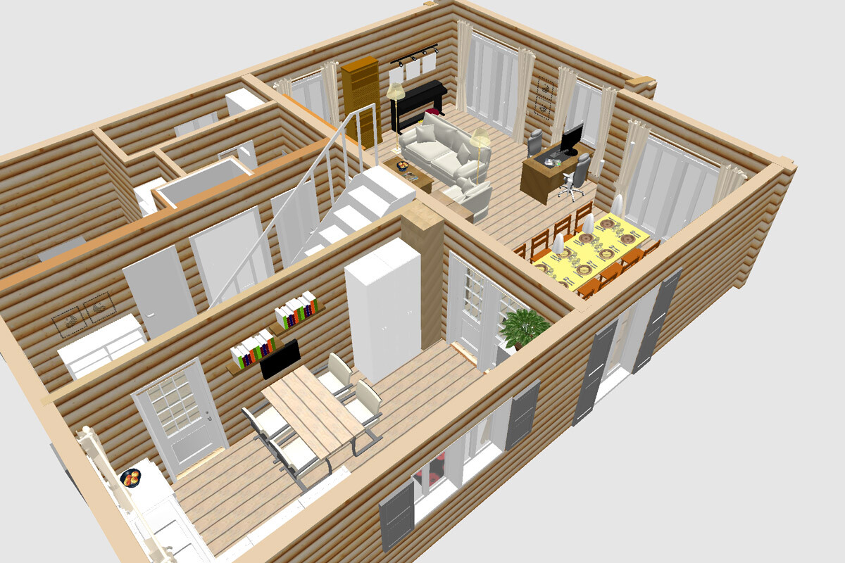

Here are a few more pictures:
Kitchen in log cabin style with sink, stove, dining table with chairs, window with curtains, and bookshelf.
Isometric interior view of a wooden house: living room, dining area, kitchen, workspace, and staircase.

Hello Steffi, ... in that case, the utility room as a technical room is far too small.
I don’t see any space for building services equipment or storage, and the walk-in closet is too narrow at 155 cm (61 inches) for two rows of clothing. Where will the laundry be done...? Where will things be stored?
asks Yvonne
Edit: I removed "ironing" – I do see space for that
Jochen10410 Feb 2015 19:52
At first glance, I see the same issues as Yvonne.
Possible solution for the utility room problem:
If I understand correctly, you are planning 2 bathrooms and a guest toilet for three people. Consider whether it might be sufficient to create a shower bathroom on the ground floor (possibly including the utility room) and move the utility room upstairs. However, this means you will have to store everything upstairs.
Alternatively, use the entire ground floor space as a utility room and swap the shower bathroom and the larger bathroom upstairs.
