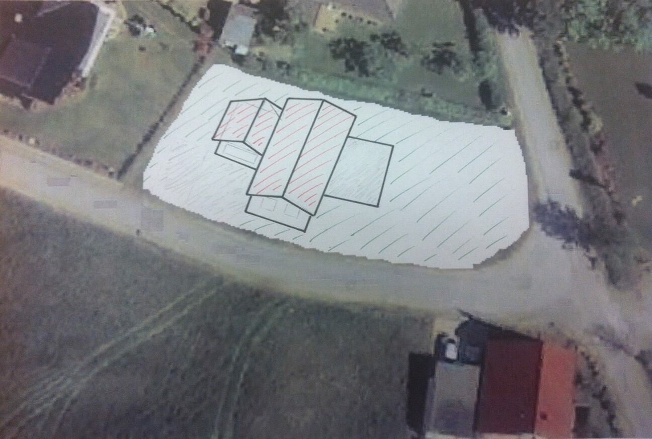

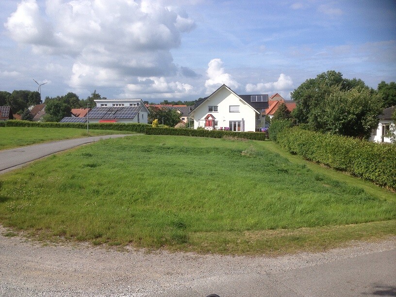

Our reserved plot measures 880 square meters (9,470 square feet) and is flat, not on a slope. We created our own design adapted to the plot and brought it to the architect, who adopted the drawing almost unchanged. Originally, we planned to include a basement level - but after receiving the cost estimate and weighing the pros and cons, we decided to omit the basement and widen the above-ground footprint instead.

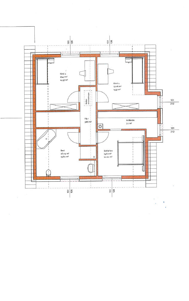

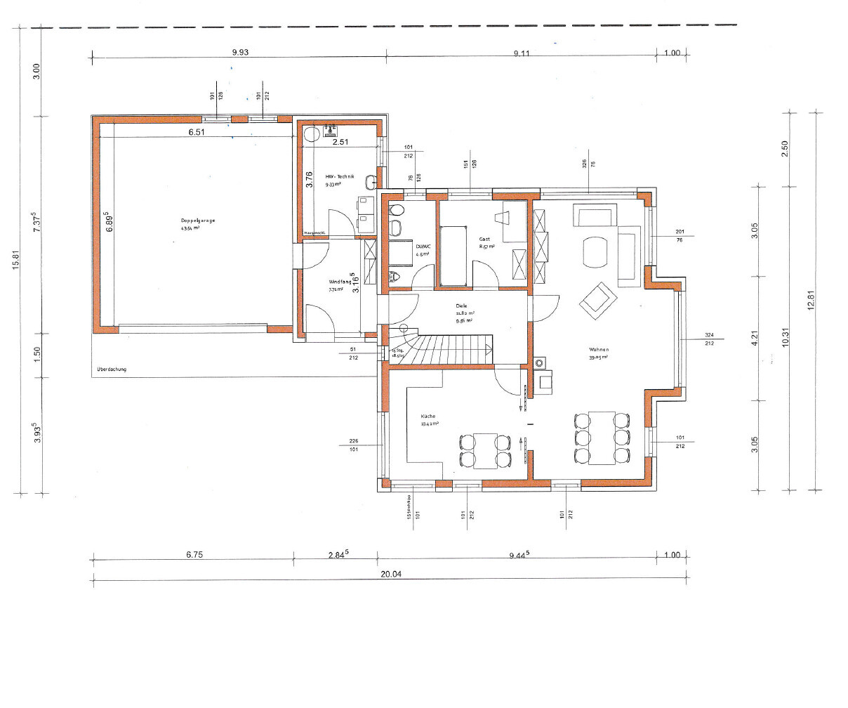

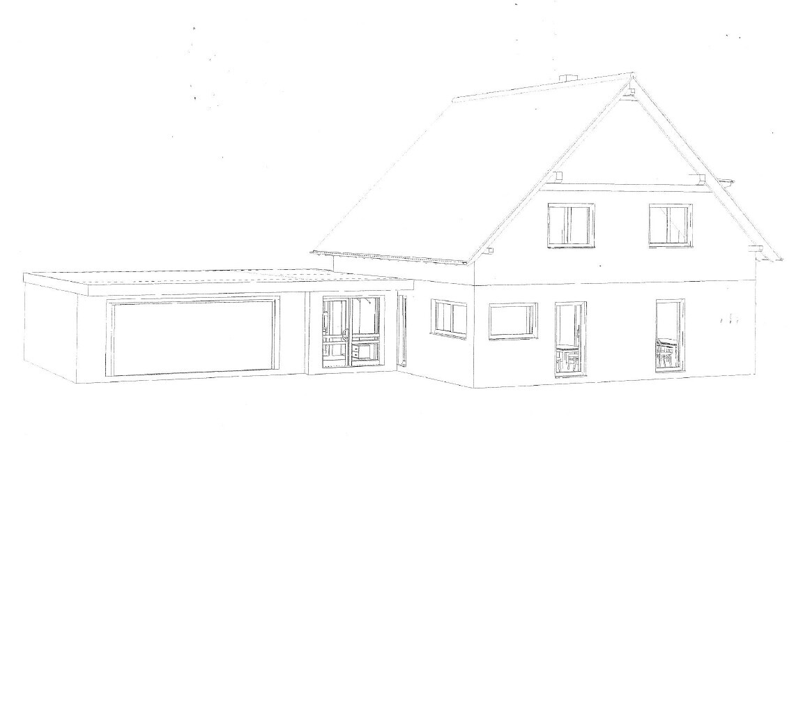

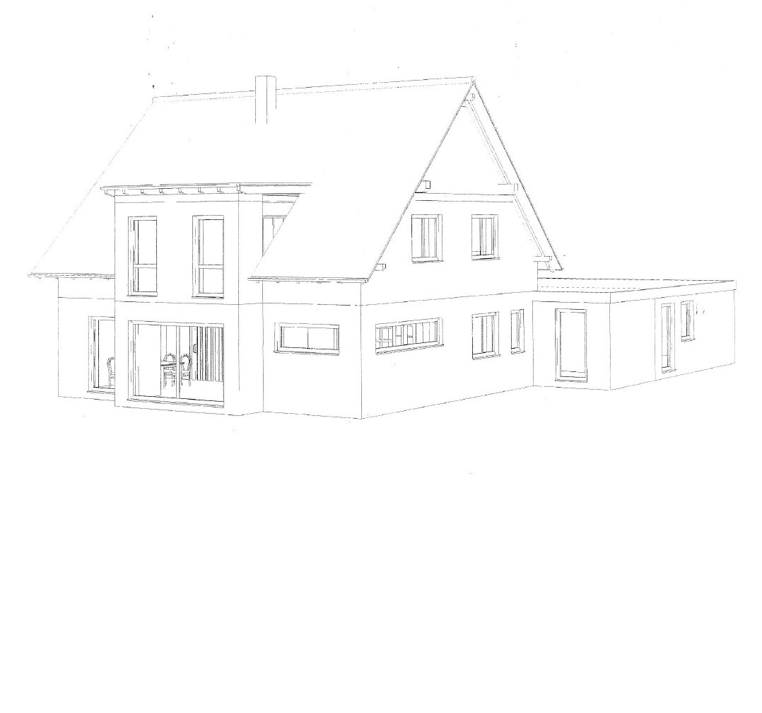

That’s it for now... I’m attaching the floor plans and elevations. Feedback and suggestions are very welcome.

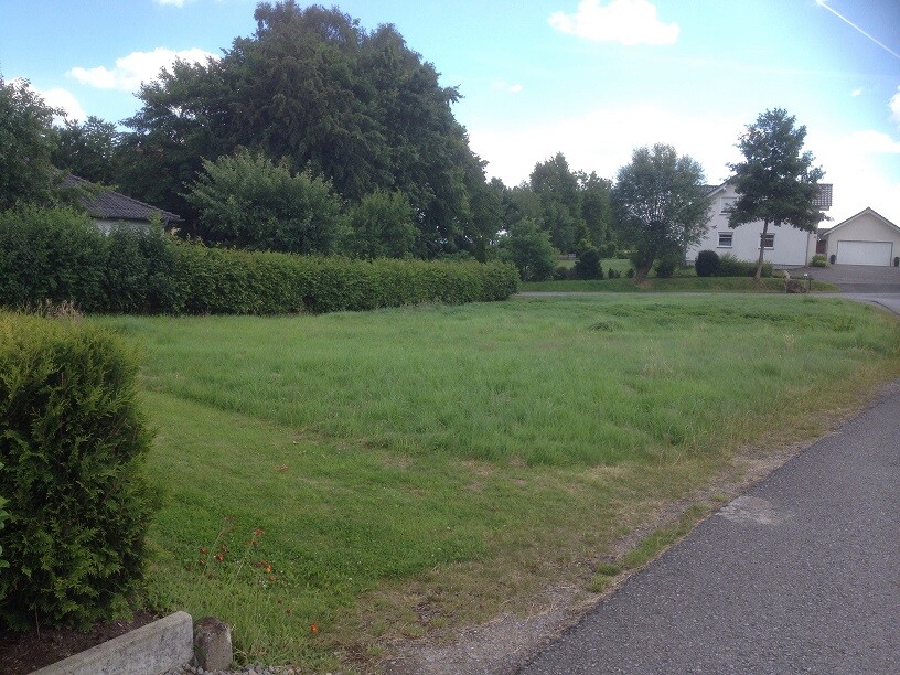

Edit: I have also added photos of the plot afterwards, which I will repost later.

Overall, it’s a really nice floor plan.
If I were in your position, I would reconsider two things:
1. Is the partition wall between the hallway and living room really necessary? I would probably leave it out.
2. Bathroom: The layout doesn’t quite convince me – the shower might be very dark due to the built-up side walls. I would experiment a bit more with the placement of the sanitary fixtures.
Additional construction costs of 5,000 euros (5 kEUR) are clearly too low. In this forum, people usually estimate around 30,000 to 40,000 euros (30 to 40 kEUR).
Please check this again with your architect.

You should search the forum for information on additional construction costs and consider which of those are already included in your figures, or be prepared to give up on your assumed 5,000 (currency).
Regarding the plan:
I think the cloakroom is too small for four people, unless there is additional space planned in the hallway.
In the guest bathroom, I find it inconvenient that you have to squeeze past the shower to reach the toilet and sink.
I’m not sure if the walk-in closet will work without specific measurements, but the wardrobe doesn’t appear to be 60cm (24 inches) deep.
The layout in the bathroom also doesn’t seem well planned, especially the positioning of the sink.

Hello – thanks for the welcome and for the quick responses.
I have prepared a comprehensive overall calculation. Everything officially considered as ancillary construction costs seems to have already been accounted for elsewhere in part. The remaining 5,000 include builder’s liability insurance, construction workers’ compensation insurance, official building site survey by the county authority, building permit fee (67BauO), temporary construction electricity and water, as well as the chimney sweep’s inspection for the chimney.
The partition wall between the living room and hallway was deliberately designed so that the sofa is not directly visible from the front door. To make the space larger "when needed," we chose a sliding door between the kitchen and living area, which can be left open depending on the "tidiness" of the kitchen.
The sanitary installations will probably still be adjusted... we will review each room again in that regard. Also, the kitchen layout as shown in the design is not final.
The staircase will be a stringer staircase, enclosed underneath and including a door to provide storage space or a pantry. The entrance area with a coat rack is really intended only for hanging clothes...

Doc.Schnaggls29 Sep 2014 18:50Hello,
the comment about the wall between the hallway and the living room was less about the room size and more because I’m concerned that the hallway might become very, very dark.
Have you looked at the list of additional building costs here in the forum and checked whether you have considered everything?

I also noticed a few points. For example, I would reconsider the layout with the shower in the guest bathroom. And somehow, there seems to be wasted space in the middle of your living room. Also, in the upstairs bathroom, the toilet is immediately visible when you enter through the door, which isn’t really to my taste.
But overall, it’s a nice layout.
