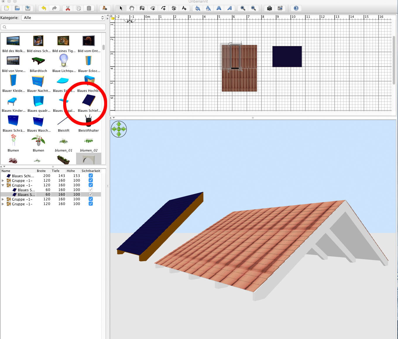

Not that difficult... you can create a nice roof using the furniture piece "Blue Slate Roof." I applied new textures to the surfaces, adjusted the dimensions slightly, and by duplicating and grouping the individual elements, I created a nice gable roof. Creating a cross roof is more complicated and you have to build it yourself. You can find instructions in the relevant forums. Best regards, Steffi33.
