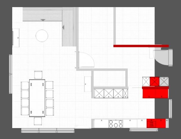

Nordlys schrieb:
Objection: Door widths: a wider door with slight offset in the lower office is no problem. It’s also doable upstairs. Bedroom: who says the bed has to be placed like that? The room itself is big enough for a bedroom.Karsten, I’m not saying wider doors are impossible. I’m saying the small doors shown in the plans make the house look bigger than it actually is.
Nordlys schrieb:
Then a couch is just placed somewhere, and it looks professional.That’s exactly what I’m criticizing: a standard 4-seater sofa doesn’t fit there, even if the design software suggests that piece of furniture.
Nordlys schrieb:
There’s enough wall space to install coat hooks.Coat hooks for 4 people—the hallway will become the messiest room, even though it’s the first you enter.
And honestly, Karsten:
Nordlys schrieb:
Bedroom: who says the bed must be positioned like that? The room itself is sufficient for a bedroom.Nordlys schrieb:
Kitchen wider. Table and 2 chairs fit in.Nordlys schrieb:
And what’s a sofa doing in the office? There should be a filing cabinet and maybe a second chair.I didn’t realize you’ve become an interior designer now. I find this more patronizing than a clear outline of negatives first.
Overall, the design is scalable, or rather, a starting point.
For example, I find the kitchen very nice – linear and spacious.
As @perth positioned the access, I would create a garden entrance directly opposite a kitchen door. This can be designed attractively and elegantly, provided the bathroom drains are placed on the exterior wall and moved away from the living room.

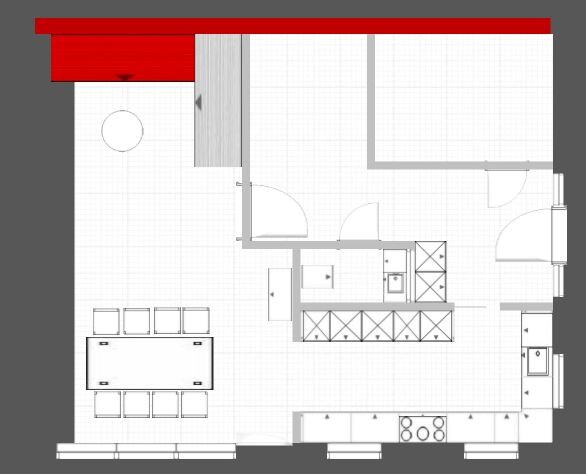

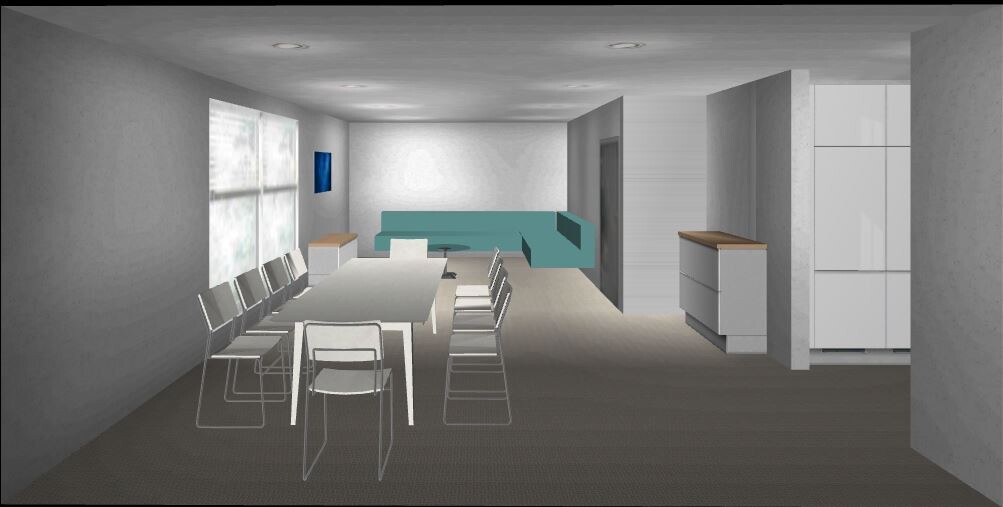

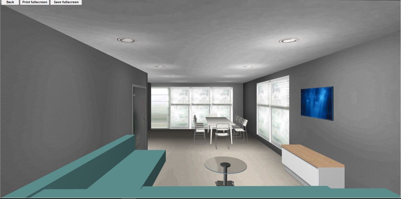

Wienerwald23 Apr 2019 22:18Good evening,
thank you very much for your feedback. It’s really great how quickly you get such helpful responses here regarding the planning. I’m already busy making changes. As soon as I have implemented them all, I will upload the revised plans again.
@Nordlys: Exterior view – you’re right, we need to revise that once more.
Hmm… the sauna is actually a utility room – so not really a luxury after all.
The hand basins in the toilets are exactly as intended – small basins just for washing hands.
We need to reconsider the furnishing in the guest room and office. It’s not ideal at the moment. Regarding the kitchen – I’m not a fan of a table there, especially since the dining table is right next to it… a wardrobe is more important here, or rather that we don’t reduce the office space any further. I already find it quite narrow, especially considering we want to accommodate a “double bed” for guests here.
As for the TV, we have currently planned it as a fold-down version on the wall. We don’t even have a TV at the moment and don’t want it to be too dominant. The garden view is more important to us.
@tomtom79: Good idea with the two window sizes. I will try to apply that.
@haydee: We will refurnish the bedroom and office.
@ypg: Thanks for the tip about door widths. I have now adjusted all of them. I am currently checking if all rooms will still “function” as intended.
In the living room, I traced our current sofa to get the proportions right. You’re absolutely right that it should be done to scale. I really wasn’t aware that the four-seater sofa turned out so “small.”
We will discuss drainage with the builder during our appointment. We had planned to locate this in the corner of the stairwell. Let’s see what the builder suggests.
@kaho674: Views – yes, we need to review those again.
We have already discussed the idea of a laundry chute and utility room in the basement. I don’t like the idea of carrying laundry through the whole house (especially since it has to be carried back up after washing). Also, we would have to plan a lifting device for wastewater just for the washing machine. We don’t find that appealing either. Alternatively, we looked at placing the washing machine in the bathroom. That’s what we have now, and I find it annoying that laundry is hung up in our bedroom and that dirty laundry piles up in front of the washing machine (and thus in the middle of the bathroom) during sorting. Hence the idea of a utility room. I’m also not yet sure about the bathroom setup (especially with the bathtub). I’m trying out some variants here and hope to find a better solution.
I’m not keen on having a shower in the guest toilet – that’s also for all guests who do not stay overnight. I want to keep it tidy, and having to clean the shower all the time just so overnight guests have their own shower doesn’t seem necessary to me.
@perth: Thanks for your comment about the kitchen. Do you think a door with a 1m (3 ft 3 in) wide opening will work? That would leave 68.5cm (27 inches) between the wall and the door. Or should I make the door smaller?
I also heard from an architect who examined our project that you should usually face a door when entering. I don’t like that strangers can look directly into the living room. Also, it is impractical because this reduces the wall space in the living room significantly. With the stairwell window and the passage to the dining room, there is enough light. I planned to hang a nice picture at the end of the hallway to create a “destination.”

The kitchen door doesn’t have to be 1m (3.3 ft) wide.
Here is an example of how the living area can be designed differently. A wide living room door, with a large window centered above it, allowing space to hang a TV.
At the bottom of the plan, there is a terrace window wall with a terrace door that opens outward or a sliding door.
here the kitchen and toilet are arranged differently.
The toilet door should open outwards. A transom window could be installed above the wardrobe for the toilet.
All kitchen windows start at countertop height and have the same width, so no “basement windows.” The countertop extends into the window sill.
