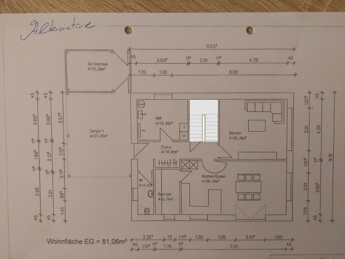

Floor plan of a house with living, dining, kitchen, hallway, WC, utility room, storage, stairway, and carport.

Would it help if we rotated the staircase and left the area underneath open, or something similar? Would that make the hallway feel significantly more spacious?
You could simply use a half-turn staircase so that the space under the stairs can still be utilized.
Ground floor plan with carport, storage room, entrance hall, WC, kitchen/dining, living room, staircase
11ant15 Aug 2018 16:19
Only having the "high" side facing the utility room allows for the space underneath to be used effectively. From this perspective, the direction of rotation is clear, while from the attic it is neutral.
I do not see any advantage in having a straight flight here—neither for the spatial effect nor for the usability of the area below. In my opinion, a "wound" (spiral) design fits the style of the house better.

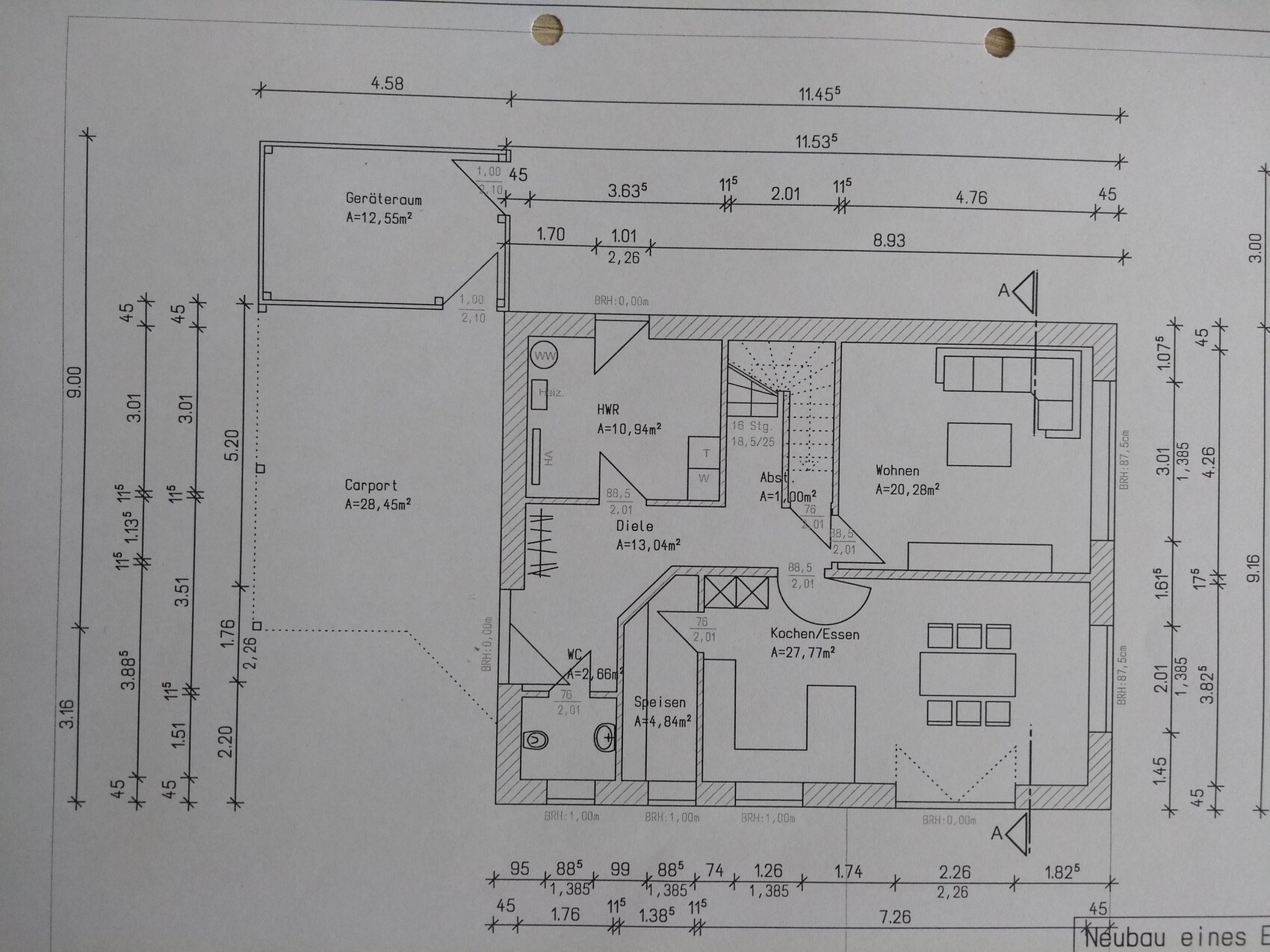

Here are the updated floor plans. The staircase will be changed as mentioned above. Other than that, the hallway already feels more open.
Floor plan of a house: Living, Cooking/Dining, Hallway, WC, Utility Room, Storage Room, Carport
We are still uncertain about the guest WC. It has been slightly enlarged, but does that actually help us? Or would it be better to make it a bit smaller again to allow the door to open more easily?

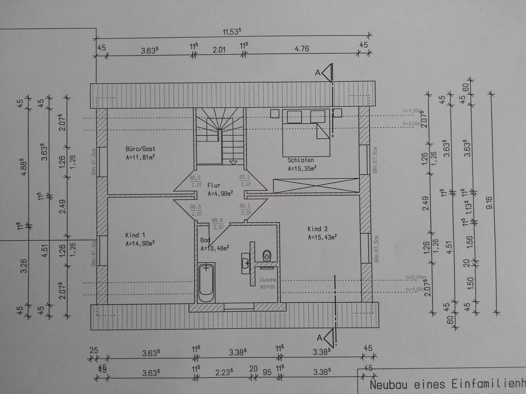

Floor plan of a single-family house: Hallway, Office/Guest, Bedroom, Child 1, Child 2, Bathroom, Staircase
We rotated the shower and toilet so that there is daylight in the shower area. But is the wall length really sufficient for the shower here? For your information: we do not want a completely open shower, but a shower door.

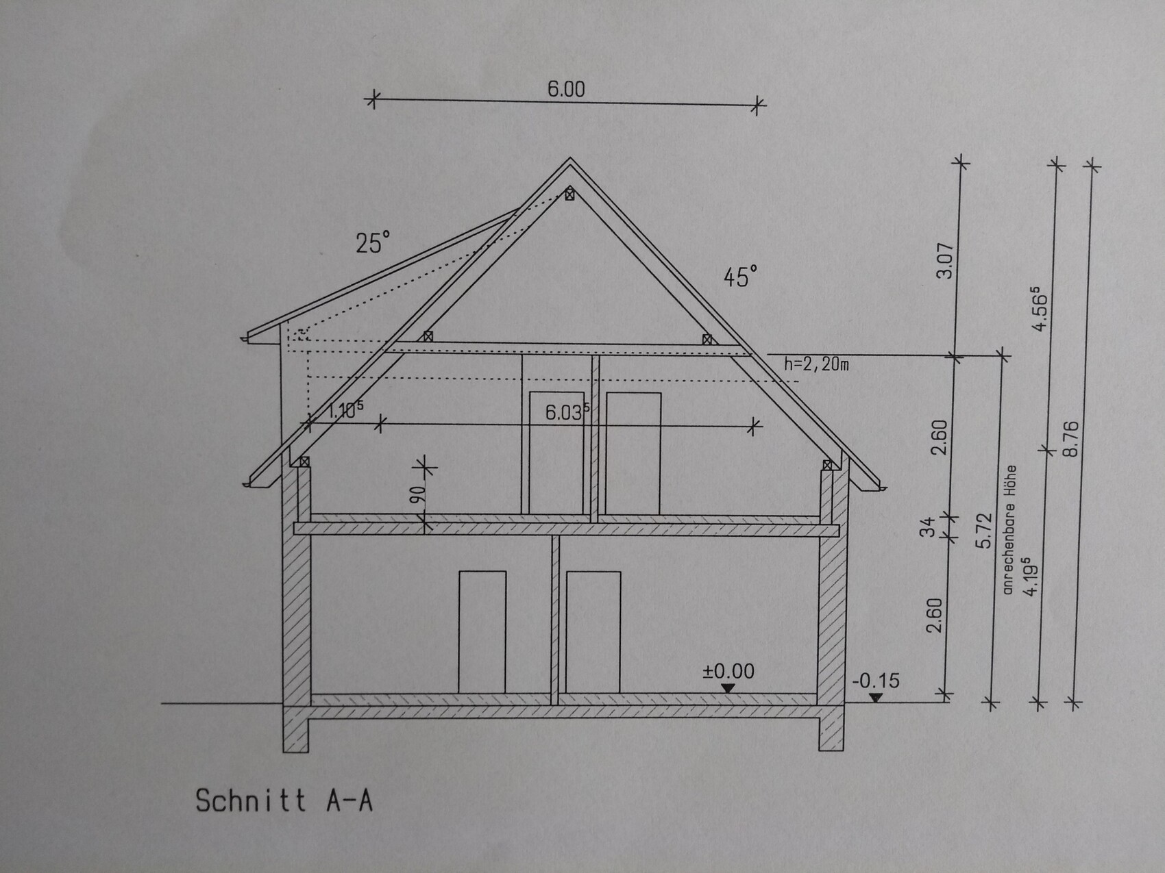

Section A-A through a two-story house with roof structure, interior walls, and dimensions.
The windows shown are still from the old design. Our question is more about the knee wall. Is 90cm (35 inches) enough? Or do you notice any other inconsistencies?

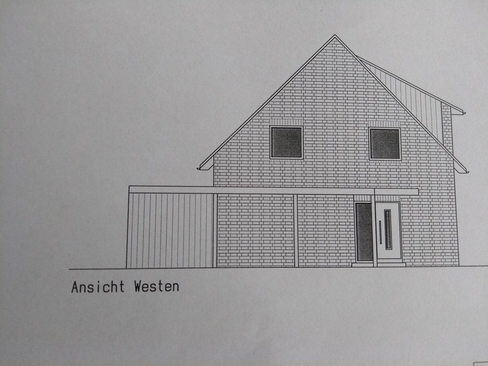

South elevation: two-story house with brick base, side extension, and several windows
The front view (the carport will be on the left in front of the shed) feels a bit wooden to me. Everything is very angular. What do you think? Would perhaps a round window above (in the bathroom) help to soften the overall impression?

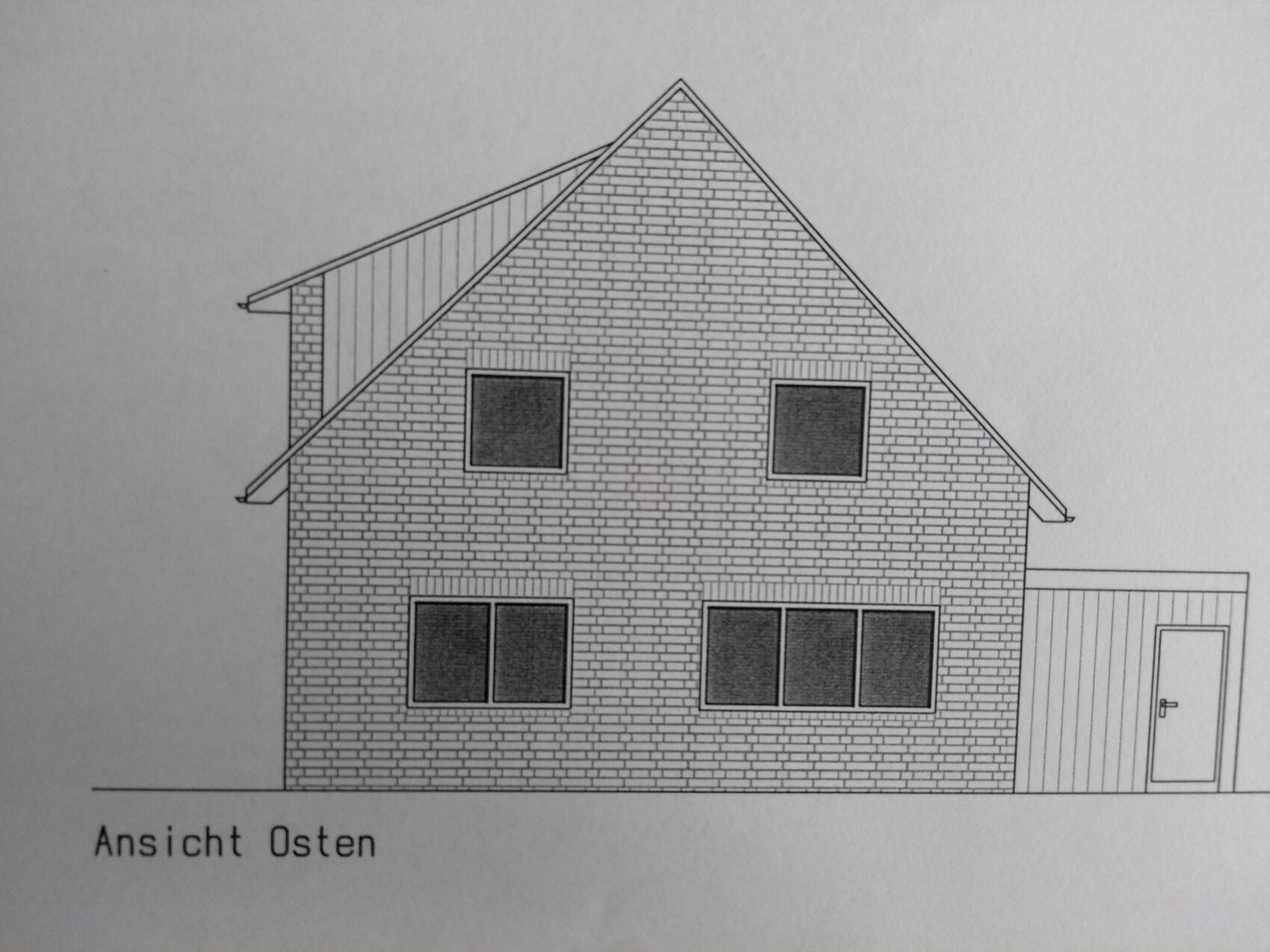

East view of a two-story brick house with gable roof, windows, and extension with door
We like the other elevations. Although we are considering moving the fixed part of the front door to the right. That might also help a bit with the guest WC door issue.

Just my two cents, since I’m not an expert on floor plans here in the forum.
- Move the front door towards the hallway; this might allow you to rearrange the coat storage and possibly enlarge the guest bathroom.
- Leave out the utility room’s exterior door. It really doesn’t make sense and only increases costs.
- Apparently, you live mostly in the dining room and kitchen; otherwise, I can’t explain the floor plan. The living room doesn’t have any access to the terrace at all???
Overall, the ground floor plan doesn’t have the character of a single-family house for me. Its layout looks more like a plan for a condominium unit. Is it just me?!
My personal opinion: I wouldn’t even want the ground floor as a gift, and I suspect you might regret it in a few years.
The upper floor turned out quite well. Although I would give the bedroom at least 1 m (3 feet) more space – there is room for it.

I’m afraid a landing staircase will be quite tight. Have someone calculate the effective walking width; it will now be around a maximum of 85 to just under 90 cm (33 to 35 inches) considering the railing, partition wall, stairwell, etc.

@Zaba12 … why make the guest toilet larger? I would rather reduce it by 10 to 15 cm (4 to 6 inches). The outward-opening door, which on paper conflicts with the main entrance door, will practically never happen and wouldn’t bother me.
Living room … I like separating the living area from dining and kitchen. And when I want to relax on the sofa, I don’t want to have to walk out to the terrace. However, I would still add a smaller north-facing window to bring more light and friendliness to the room.
Then you could start planning the kitchen, and maybe shift the southern kitchen window slightly to the right.

Stege90 schrieb:
We swapped the shower and toilet so that there is daylight in the shower.
But then there’s a cramped feeling in the bathroom? You’re busy in the shower. A view of the sky from the toilet would be nice... I would switch them back. I’m not surprised that so much space is given to the toilet. It could definitely be smaller to give more room to the shower!
Stege90 schrieb:
But is the wall length sufficient for the shower?
No, it can easily be one meter (3 feet 3 inches) long. At least for aesthetic reasons. You will be visible through the window anyway.
Stege90 schrieb:
Our question is more about the knee wall. Is 90 cm (35 inches) enough?
Measure the headboard of your beds. Or sit in bed to read and measure how much height you actually need.

The carport looks a bit wooden to me. Everything is very angular. What do you think?
Not angular, but unbalanced. The windows don’t align... the spacing isn’t refined. This also applies to other windows on the ground and upper floors... the facades appear somewhat displaced and skewed.

It feels like you told the architect, “We need a pantry.” So they drew one. You want the toilet and shower swapped, so they swapped them—without thinking it through. And you don’t notice the mistakes because you’re getting exactly what you asked for.
A pantry definitely doesn’t need a south-facing window. Leave the pantry out and use the space under the stairs as a pantry. The room can serve better as storage or a wardrobe closet. You actually don’t have enough wardrobe space. What’s drawn is only enough for out-of-season clothes currently in use, but not for storing seasonal clothing.
The windows on that side need to be adjusted. The bathroom window is disproportionately small compared to the dormer, which is why it looks odd to you. The toilet doesn’t need that much space, so the “I” in the “T”-shaped layout needs reconsidering. Actually, you could make the “T” more like an “L.”
I would also suggest balancing the east side, trying if the dining window can be shifted.
Entrance: the window under the carport makes no sense. Let that window bring in light. The living room needs a patio door. Is this supposed to be a formal living room? Or a TV room... but even then, access to the outside is useful—you want to go out in the evening sometimes.
