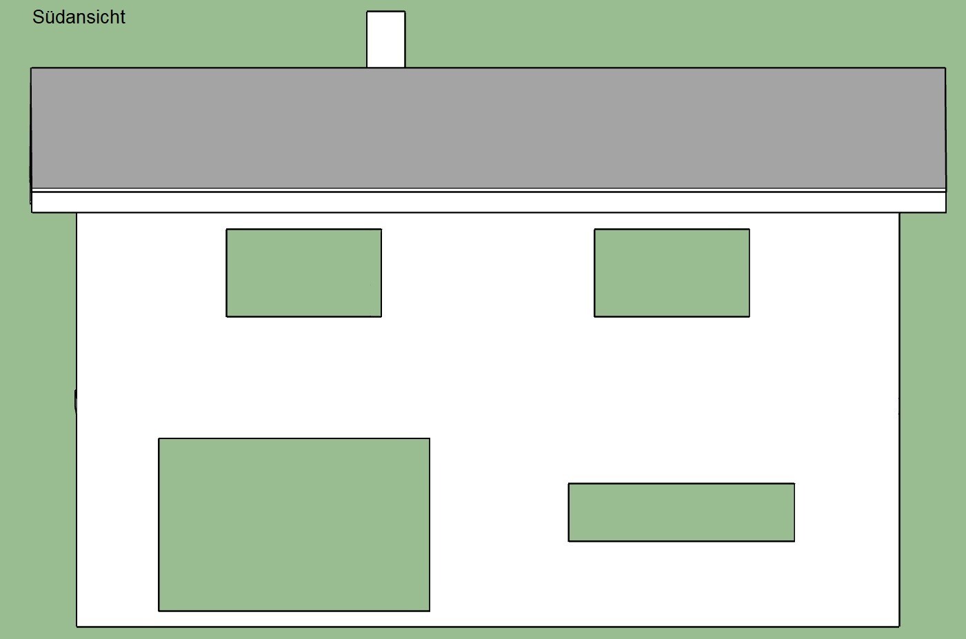

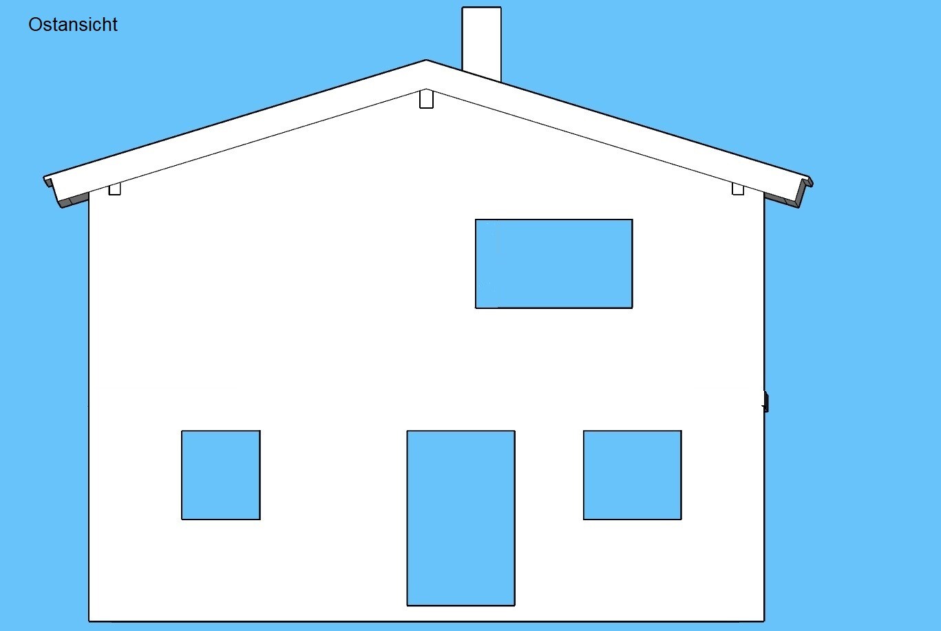

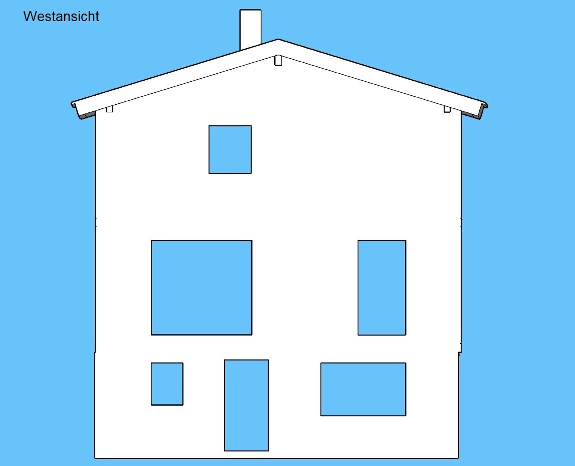

Wienerwald22 Apr 2019 21:15Outside: I don’t like it, especially from the west side, as it looks very awkward. Since land is not scarce, I would prefer to build an L-shaped bungalow with a living basement because of the slope.
Inside: The layout is great. The kitchen could be a bit wider to fit a small table for quick breakfasts. The living room is nice, and I like that the TV doesn’t dominate the space but is limited to the area it has. I really appreciate that. I also like the upper floor because of the bathroom with a sauna and a separate toilet. It’s definitely a luxury, but if you can afford it, you deserve it. It’s lovely. K..
The path to the kitchen is long, and everything has to be carried through the living room. It would be better to have an additional door to the kitchen.
The rest seems fine to me for now.
As for the exterior views, well, try to use a maximum of two window sizes and arrange them as much as possible one above the other.
