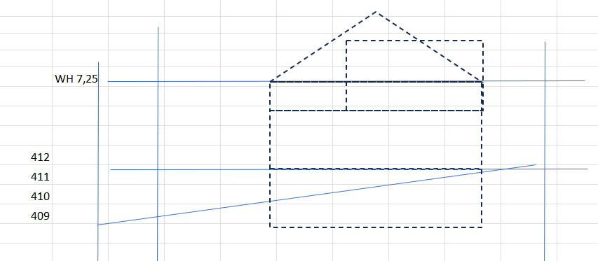

hanghaus2023
17 Dec 2024 22:15
Is the upper building limit also the property boundary? Then you would still need to keep a setback (3m (10 feet)?).
As already suggested, the house should be moved closer to the street.
That is the maximum you are allowed to build.
I hope the roof pitches are not being misinterpreted in the same way.
2D floor plan of a house with roof and grid lines on plan layout
Basement, ground floor, and attic with knee wall, or a stepped floor with a flat roof.
I would position the house and garage as far forward as possible.
I assume the zoning plan drafter is assuming a gable-end building style.

hanghaus2023
18 Dec 2024 10:25
h28smbh schrieb:
If the natural terrain drops more than 1.50 m (5 feet) at the building, measured along the slope line, then a building with hillside construction consisting of a basement and ground floor must be built.
I just read this now. In that case, you can also use the image you provided, if the house is only 8 m (26 feet) wide.
The basis is that the plot has been surveyed with detailed elevation measurements, especially in the area of the house.
It should be clarified in advance what is meant by excavation and filling, because the image at the bottom right would then not apply.
Perhaps your interpretations of the development plan are also somewhat inaccurate.
