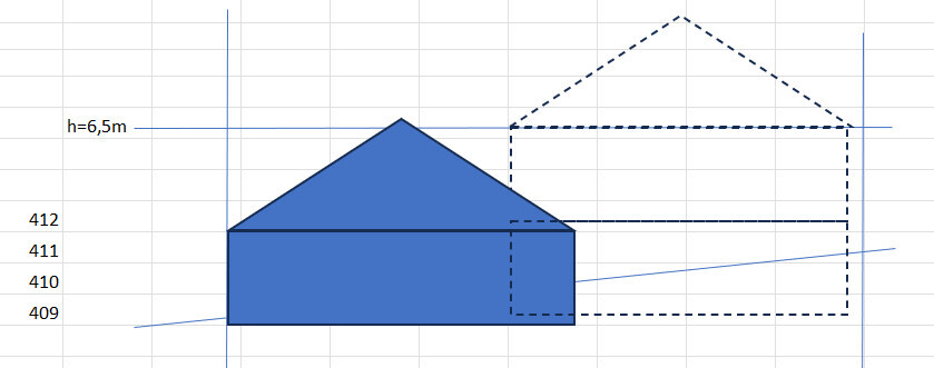

For me, as someone who loves natural light, the best side of the house is the southwest because of the afternoon and evening sun. On the few days each year when it gets too hot, you can simply keep the blinds down. In this floor plan, that side of the house is not used at all (I assume the site plan is oriented north). The building boundary is very generous. I would move the garage further north on this plot and plan the main entrance on the northwest side. The driveway to the garage could also serve as a walkway, so it wouldn’t require much additional paving. The northeast seems very quiet. With the green strip there, it provides some distance from the neighbor. I would place a (further) terrace there, or at least an access to the garden. In my opinion, the current terrace layout in the southeast is rather impractical, as it only receives sun from morning until midday.
hanghaus202317 Dec 2024 15:45You have a height difference of 2.6 m (8.5 ft) over 3 m (10 ft). That is about 11%. However, you are only allowed to cut or fill up to 0.5 m (1.6 ft). You should take this into account during the planning stage. Simply leveling everything at the front and then raising the back will not work here.
Is there a reference elevation for the house?
h28smbh schrieb:
ecological timber constructionWhether "ecological" and "timber construction" are synonymous, inseparably linked, or even opposing concepts—this philosophical debate could fill volumes and take longer than planning and building a house from the initial sketch to the last roof tile. As a construction consultant neutral to building methods with four decades of residential planning experience, I want to emphasize that houses are built from materials, not ideologies (at least they can be).Currently, forestry alone is not sustainable, partly because too many eco-conscious, plant-based lifestyle advocates mistakenly believe that an environmentally valuable house is defined by the highest possible wood content in the wall structure, exerting an over-demand for premium timber on the wood market. As a result, too much wood is harvested for forests to still be managed sustainably. A worrying and growing share of construction timber should rightly be called "blood wood" by conscientious consumers.
Therefore, I strongly advise moderation and the removal of ideology. With genuine recycling (not shredded downcycling), such as reused roof tiles, we can do more meaningful things than cutting down fresh trees and using various materials just because their "cement-free" label checks a woke checklist. Building walls from boulders mortared with duckweed might—depending on what one was smoking beforehand—seem like a solution to world problems, but it’s not. Sensible planning means even a house built by an ecologically indifferent local builder is not something to demonize.
h28smbh schrieb:
"Schematic building volume (building proposal with ridge direction suggestion)"
Am I interpreting this correctly as: it’s possible but not mandatory?If it says that, then I see it the same way. The magic word here is "proposal"—but it could also be that the zoning plan prescribes this as a requirement (the official plan symbol is usually a two-headed arrow, but depending on the plan legend, it could also be the symbol shown). I’d rather mention it once too often than risk a planning application being rejected because of it.h28smbh schrieb:
I’m surprised by your price estimate because we have a quote for a very similar floor plan, which is about 10m² (11 square feet) smaller, at 505k. Especially since it sounds like my additional 45k costs, calculated by the rule of thumb 10m² * €3000 + 15k for the facade, are way off. (The first offer didn’t have a timber facade on the ground floor.) [...] I will get quotes for the floor plan soon. If your assumption is correct, I will have to make compromises.Three mistakes in one post: (1) Quotes are not comparable just because floor plans are similar. Floor plans alone are not a reliable basis for obtaining quotes. Also see my posts under the keywords resting dough and key decisions. (2) I advise to primarily consider façades as design features rather than linking them necessarily to the structural system. (3) Making compromises is very bad. The final house gains nothing from having originally worked with a plan one or two sizes larger. And simply removing the timber cladding from a house designed to have a timber façade is also not the right approach.h28smbh schrieb:
We will not be building 100% turnkey, even though I wrote that above. But the amount of work we will do ourselves will be relatively small, so I didn’t specify it separately. We will probably only lay the flooring ourselves.I assume you mean the floor coverings (cork / tiles)? — regarding own labor? Keep in mind: a "partial finish" house is better than a "turnkey minus" one.hanghaus2023 schrieb:
You have a height difference of 26 m by 3 m. That is about 11%. But you are only allowed to cut or fill up to 0.5 m (1.6 feet). You should consider that in your planning. Simply leveling everything at the front and then raising the back won’t work.Here the 11ant basement rule might already suggest a liveable underground level. And it strengthens the ridge direction proposal. Exactly how does the zoning plan define "three full stories"?https://www.instagram.com/11antgmxde/
hanghaus202317 Dec 2024 16:20Similar topics
