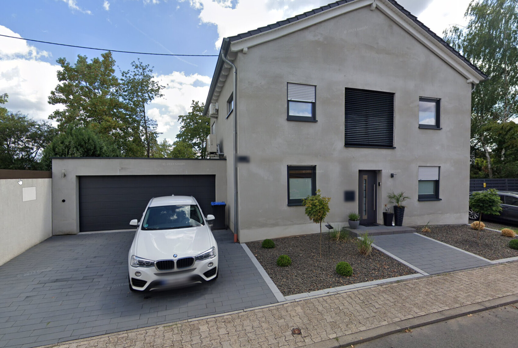

Is this a boundary garage? If so, the suggestion from post #2 won’t work.
Please share the floor plans and a street view.
hegi___
11 Jan 2024 12:45

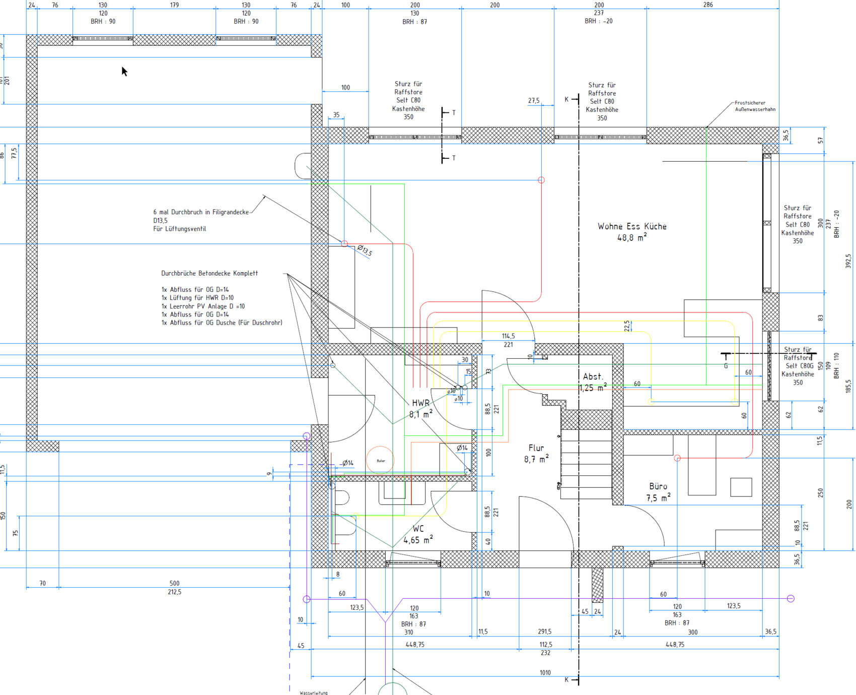

Here is a photo of the street as well as the floor plans.
Modern two-story house front with garage, white BMW in front, garden area.
Floor plan of living/dining/kitchen area with hallway, WC, office, utility room, and dimension lines.
Architectural floor plan of a house with bedroom, walk-in closet, bathroom, hallway, child’s room 1 and child’s room 2, dimensions.
hanghaus2023
11 Jan 2024 12:51
I am imagining a shed roof 1 meter (3 feet) higher than the house, following the same roof pitch.
