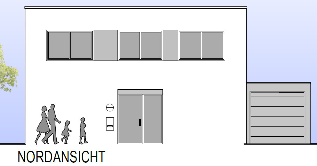

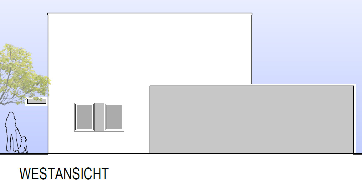

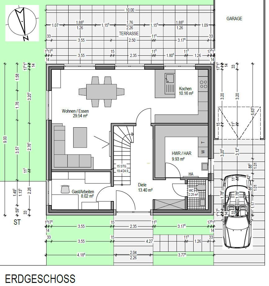

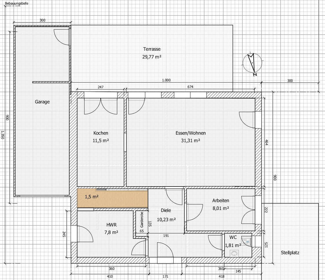

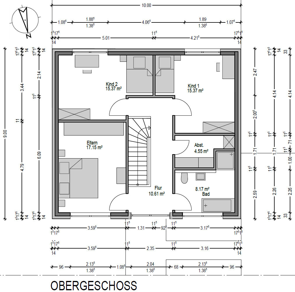

Builder’s floor plan (images ending with 295772-295772-5.png)
House design – why did the design turn out as it is?
- The builder’s architect based the floor plan on the Signus by Kern-Haus.
- We like the basic structure so far.
- The front entrance with the door and the windows above feels much more inviting than the standard floor plan.
- Is the front door drawn too large?
- The door to the living room is not ideal. Depending on kitchen layout, it would be in the way when open.
- Would a window sill height of 1.01 m (3.3 ft) be sufficient for the kitchen window? The left window in the dining area facing the terrace could perhaps be made floor-to-ceiling. It might not look perfectly symmetrical from the outside, but it would look the same from the inside in the dining area.
- Due to the quarter-turn staircase with one step on the exit, the entrance hall area was reduced at the expense of the TV area. Is the TV area still large enough?
- The entrance hall is quite large because of the quarter-turn staircase with the step on the exit. How could this space, especially under the stairs, be better used? Maybe with a built-in closet or storage room (with its own access)? We also once thought about rotating the staircase 180° and using the area under the stairs at the entrance as a wardrobe (built-in closet). But then what about the door to the living room? And how would it look when entering the house and seeing a cupboard right away? On the other hand, it might make sense to swap the front door with the window element.
- The utility room has a 73.5 cm (29 in) door. Is that sufficient or would an 85 cm (33.5 in) door be better?
- For the WC, we might prefer the door to open inward and swap the toilet and washbasin.
- The two bed niches in the children’s rooms don’t look optimal at first glance. On one hand, only a wider bed fits here, and the other child would have to place a bigger bed elsewhere later (unless sleeping partially under the window). On the other hand, from this niche, you can’t see who enters the room. Maybe this deep niche is better for the entrance and perhaps a wardrobe with a headboard? Or the partition wall could be shifted a bit left (centered between the two windows), so that beds fit properly in both niches and bigger beds would protrude a little.
- The storage room could perhaps be a bit narrower in favor of the bathroom. Maybe it would look better with an 85 cm (33.5 in) door here as well?
- The heating system will likely be underfloor heating with a gas condensing boiler and solar storage for hot water support.

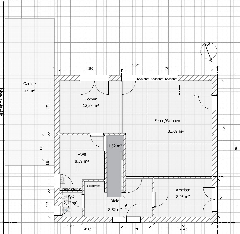

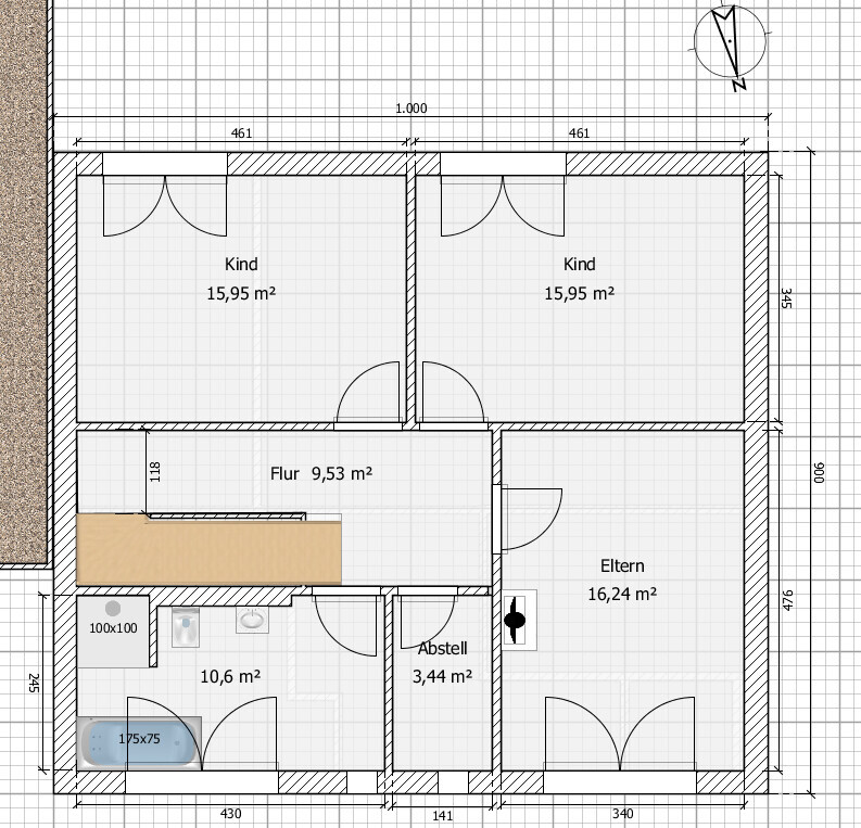

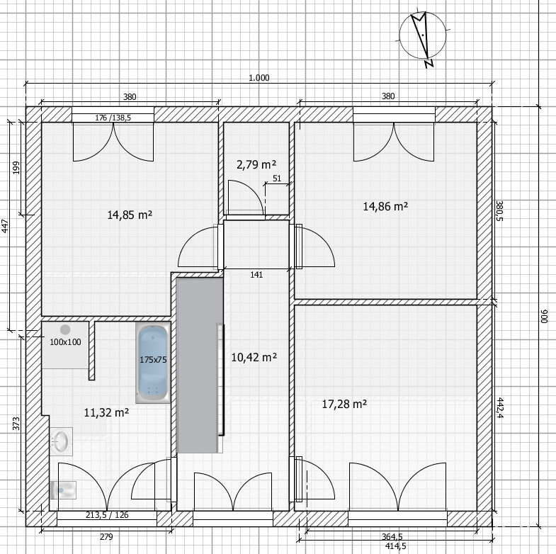

Own Floor Plan 1 [U](images ending with 295772-6-295772-7.png)
House design – why did the design turn out as it is?[/U]
- DIY… since we can’t let go of the basic structure from the builder and Signus, I also drew a bit. Access to the utility room was moved to the kitchen and a 1.25 m (4 ft) wide built-in closet wardrobe was planned in the hallway.
- Maybe the stairs should be moved a bit further left to get a larger living/dining area. This would allow making the WC narrower and possibly longer.
- The square dining/living room looks like it might not be used optimally later. The distance between TV and sofa is quite large at 5.87 m (19 ft).
- The upstairs hallway might be a bit too wide (due to the storage room). The wall between the storage room and the left children’s room could be moved left a bit. This would mean the door to the children’s room is not aligned with the stair railing but set a bit behind the wall at the stair’s end. Or could this be solved by adding a railing to the last step facing the left children’s room (similar to the builder’s floor plan)? On the other hand, such a wide hallway offers space for 30–40 cm (12–16 in) slim sideboards.
- The layout of WC and bathroom might be done differently.
- Windows and doors are not fixed yet and could be better positioned.
- We like the entrance area better with the two outer windows above.

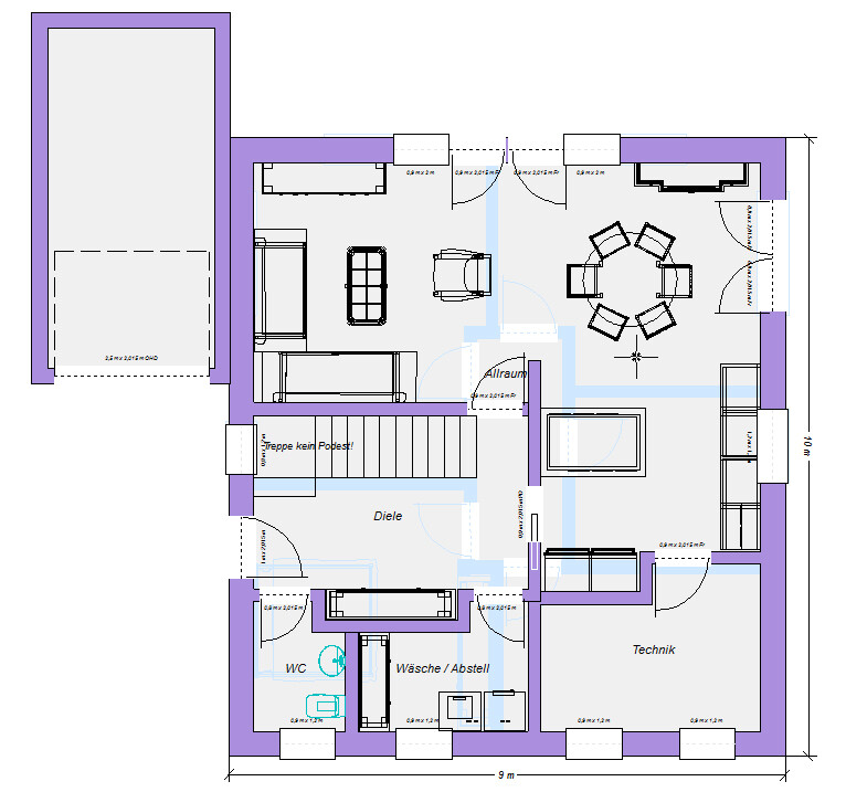

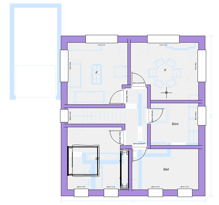

Own Floor Plan 2 [U](images ending with 295772-8-295772-9.png)
- DIY… We reviewed all floor plans again and came across the one with the staircase rotated 90°. I extended this plan to 9 m (30 ft) depth and shifted the stairs.
- I find this layout very flexible since the central axis can be moved depending on needs. The same applies vertically for the utility room and office.
- I like that with the stair positioning upstairs you come out behind the central axis, allowing large straight rooms to the south as well as to the other side.
- I thought about using another staircase but couldn’t find a good location, and it would mean no window in the upper hallway.
- The kitchen could also be open, or alternatively as our preferred closed kitchen. The dimensions shouldn’t feel too narrow.
- The entrance area might be a bit large, especially in front of the WC. But it could fit a slim sideboard, mirror, or day coat rack.
- The children’s rooms might be a bit too large. The central axis including stairs could be moved about 20 cm (8 in) toward the garden, but that would narrow the dining/living and cooking area.
- The master bedroom might be a bit narrow if the bed is placed on the right and a sideboard with TV on the opposite wall.
- Whether the stair overhang is enough to access the bathroom from there still needs to be checked in detail.
- We like the entrance area better with the two outer windows above. Whether to place two slim windows beside the front door or one larger window and then likely none on the top line needs further review.

No need for my reminder, the OP uses the same name in both forums. What’s your name there, or are you just reading silently?I didn’t pay attention to the name at first; I’m just a silent reader.
I have to admit, I didn’t read the entire text at first. I find some of the concerns you have somewhat trivial. The sleeping niche for the children is cozy. You can’t see the door from there – which is actually ideal.
The bathroom door is fine as is, and the front door is the right size. It’s unfortunate that you risk falling down the stairs when you enter, but it’s still manageable. I would actually rotate the living room door. The distance to the TV seems sufficient to me. The office feels too small and cluttered.
The upstairs bathroom is a bit too small for my taste. It’s workable, but in my dream home, I want enough space to move around freely. A storage room without a window feels terrible. Especially that narrow extension – you don’t plan rooms like that in a new build, it’s a mess. But that’s the only flaw I notice. The real problem is the excessive demands crammed into a very tight space. That bothers me the most.
By the way:
With a flat roof, you can work very well with skylights in the upstairs hallway. This offers options for a naturally lit corridor without requiring a wide and direct access to an exterior wall.
By the way:
First of all, here is the site plan again. Somehow, my original post related to it was deleted.
@ypp: Somehow, I feel like we already know each other .
I briefly considered using a different name here. But that would have been pointless. The smart one would have still seen the connection .
Yes, I have. The furniture shown in the preliminary floor plan are our actual pieces.
My approach here was to view the floor plan neutrally without cluttering it directly with furniture. However, I can also present the floor plans furnished right from the start in future.
And where would the door to the utility room go then? Originally, it was in the hallway where the cloakroom is now marked.
The kitchen layout is still completely open. It could end up being a U-shaped kitchen or a single row with a peninsula.
Which requirements exactly do you mean?
Here we are supposed to fill out the well-thought-out questionnaire and explain what we like and don’t like about the floor plans.
And what decision would that be?
By light source, I meant a window .
Isn’t that a legitimate way to find out how well you can drive into the garage or not?
And what would you recommend to us?
A strip would be occupied by a garage up to the end of the terrace. On the other side, there would be a parking space at the front sooner or later. The garden-facing area could have a terrace that wraps around the corner and/or a play area for the children, e.g., a swing.
We are quite uncertain ourselves.
If you put the garage on the east side, then you can still add a window on the west side of the ground floor, but the driveway would be narrower. Cars will probably get bigger over time, not smaller.
Wow, thanks for this idea. It reminds me a bit of a variant the architect once provided to us.
I understand this floor plan is already oriented accordingly? So, garage and entrance on the east side and a 4-meter (13 feet) green strip on the west?
I’m just wondering: if the garage only starts after about 6 meters (20 feet) of house length, it already extends beyond the 13.5-meter (44 feet) deep building envelope. I don’t know if this complies with the planning permission rules. A 9-meter (30 feet) long garage would probably also not be possible.
Thank you very much for your feedback.
Yes, we have many concerns. We want the house to be somehow perfect, and with the floor plan, we still have the opportunity to influence “our house.”

Have you drawn the existing or desired furniture to scale in all the floor plans?
haydee schrieb:
You write in detail about the study. Mark it in the plan.
… the sideboards are already mentally placed.
haydee schrieb:
I personally like the first ground floor plan best. The utility room door could be moved a bit closer to the kitchen. Direct access to the kitchen is not necessary. It’s better to put a proper pantry cabinet there.
It’s pointless just to read the requirements. It really kills the motivation to say anything.
Basically, the decision is already made.
Lamp???
You have even practiced parking …
Do you prefer the strip on the west side instead of the east? For a house 10 meters (33 feet) wide, you would have two strips minus the garage, but with loss of windows. It’s the same either way: either a strip, meaning 3 meters (10 feet) of usable space (which isn’t too bad) or no windows.
kaho674 schrieb:
Here’s an alternative with the office upstairs and storage downstairs:
kaho674 schrieb:
I have to admit, I didn’t read the entire text at first. I find some of the concerns you have rather trivial. The bed niche for the children is cozy. They can’t see the door from there – that’s perfect. The bathroom door is fine, the entrance door is the right size. It’s a pity that you have to climb the stairs right when you enter, but that’s manageable. I would actually rotate the living room door. The TV distance is fine. The office would be too small and cramped for me. The upstairs bathroom is a bit too small. It works – but in my dream house, I want space to move. The storage bunker without a window I find awful. Especially that narrow part. You don’t plan rooms like that in a new build, that’s a makeshift job. But that’s the only flaw I see. The culprit is the excessive wishes on a tiny footprint. Those bother me most.
About the office: The furniture (which also serves as storage, especially a 1.5-meter (5 feet) wide cabinet) we want to put there will fit, and the distance from the desk to the sideboard opposite would be 90–95 cm (35–37 inches), even more than in my employer’s office. It’s no wellness oasis, but it meets my employer’s requirements .
About the bathroom: Our current bathroom (with a bathtub) is 5 m² (54 sq ft). It could certainly be a bit larger if we reduce the storage room and the children’s rooms a bit. But we don’t need a wellness oasis either.
About the storage room: This space was at times a narrow 1.3 m (4 feet) corridor and at other times the shower niche stretched all the way to the children’s room, making the storage room completely interior without windows. The idea behind the “narrow part” is that if the shower is directly next to the children’s room, the child might hear every time the shower is turned on or off. Also, this niche could hide the ventilation duct for the gas boiler and other utility lines, and it could be used to store things rarely needed, e.g., suitcases. I will definitely take your suggestion into account.
But which wish should we give up?
I need the office to be allowed to work from home.
Unfortunately, the house doesn’t have a pitched or hip roof, so no additional storage space up there. Therefore, in my opinion, a storage room makes sense, doesn’t it?
kaho674 schrieb:
By the way: with a flat roof, you can work very nicely with skylights in the upstairs hallway.
Thank you for this suggestion.
We have many roof windows in our apartment and had bad experiences with them. A roof window is exposed to rain and snow differently than a regular window. I don’t know if a skylight can be compared to a roof window, but we have no positive associations with the transition areas between roof and window. So, we would be glad if our house had as few roof windows as possible.
