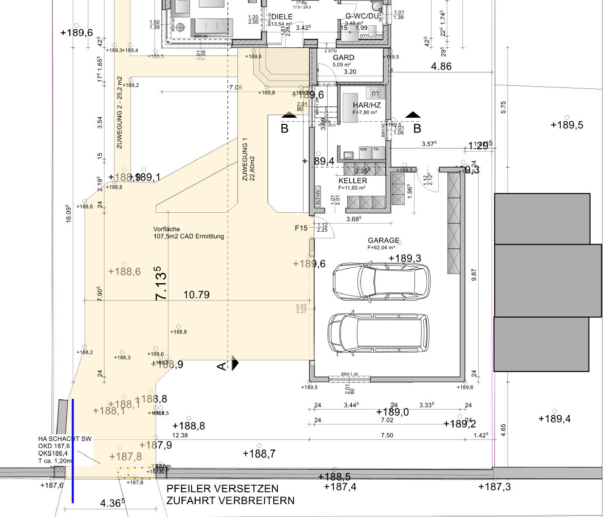

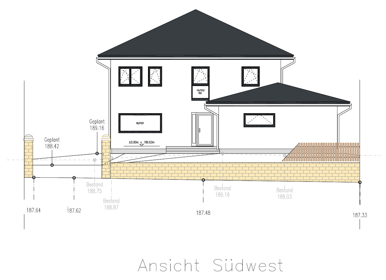

Originally, we planned a solid construction house with an architect. Due to the uncertain market situation and potential cost increases with individual contracts, we have now decided to go with a prefabricated house provider and are therefore switching to timber frame construction. The floor plan remains largely unchanged, but the new construction method requires some adjustments:
The architect planned two or three steps as well as a concrete slab with a raised edge in the outbuilding. The prefabricated house provider rejects this, arguing that both buildings must be at the same level. Direct contact between the exterior wall and the foundation/reinforced concrete wall would lead to moisture and long-term damage. The height difference is small and is better compensated through the foundation.
However, the section shows a critical height offset. Possible solutions would be:
Elevations, sections, and floor plans are attached – I look forward to your feedback!
- Lowering the house (possibly with disadvantages for drainage, daylight, and appearance),
- Separating the garage and designing the transition with steps,
- Or leveling the front height already and building the garage higher (steep driveway)
Thanks in advance!
